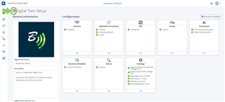

The admin user can reach this page by clicking in the Administration tab. The Administration tab is only editable for the user with admin permissions. This is where the user can manage existent Digital Twins (including defining the users that will have access and the respective permissions), create new Digital Twins or edit or add information to the selected Digital Twin
A Digital Twin corresponds to the digital representation of the physical assets, processes, or systems, as well as the information that allows to understand and model its performance. The digital twin is continuously synchronized from multiple sources, to represent its near real-time status, working condition or position. In WaterSight, each Digital Twin intends to represent a whole water supply system, including all its components and information: pipes, valves, sensors, pumps, pumping stations, tanks, reservoirs, zones (or DMAs) and customers.
To know more about managing Digital Twins in WaterSight (to select one from those available, create a new one, etc) please go to the Digital Twins page. To go to the list of available Digital Twins, click in the back button located in the upper left corner of the page.

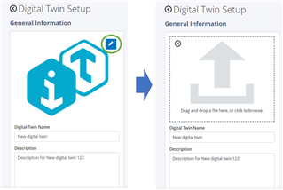

General Information
Digital Twin Name: enter a name for the DT.
Description: enter some description for the DT.
Upload image: upload an image to the DT by clicking in the blue icon button.

Configuration Sections
This is where all information belonging to a DT is added or edited.
WaterSight is prepared to work by modules. This means that the water utility does not need to have all the specified data in order to start using the software (minimum requirement is to have SCADA or other telemetry data). WaterSight can start to be configured based on the information currently available at the water utility. As new information is available it should then be added into WaterSight.
