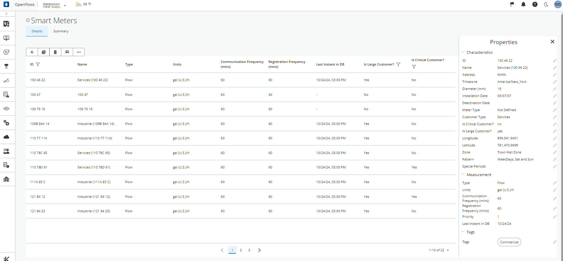

Administration page used to import smart meter information into WaterSight. Only applicable for flow sensors and it should be only for large customers.
WaterSight is intended to integrate with smart meters from large or critical customers, up to a limit of 2 000. With this integration it is possible to monitor large customers flow, generate alerts, understand the influence of large customers on zones flow (more effective leakage management). It is also possible to have the smart meters consumption automatically being adjusted into the real time hydraulic model – more information here.
It is possible to import smart meter information through a configuration excel file (template file available for download in the Digital Twin Setup page) or to manually add those. After uploading information, it is also possible to edit, delete or copy information, using the available buttons located above the table.
Note: To enable the Copy, Edit and Remove options, please select a smart meter first (row in the table). When clicking in a specific smart meter (table row) the fields available for editing will appear on a right side property grid.

Smart Meters Configuration Table
Note: Minimum required fields are marked with an asterisk.
