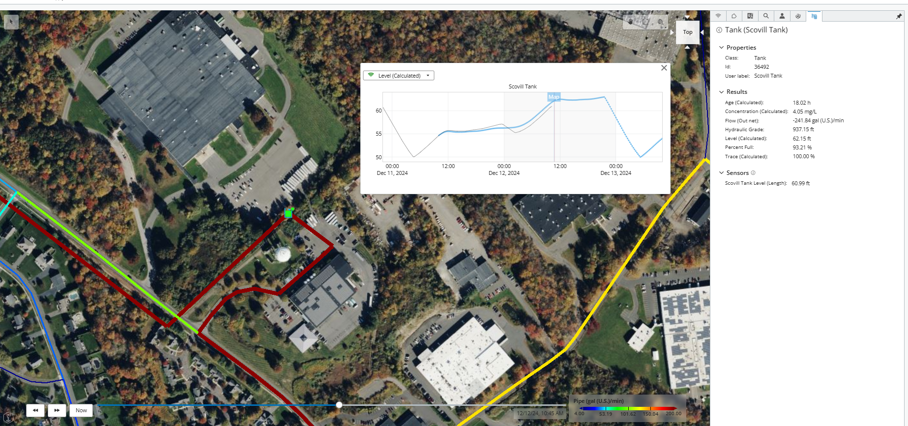

With WaterSight your entire utility (modelers and non-modeler experts) can have access to a real time hydraulic model of the system. This hydraulic model is continually being fed by real time measurements coming from sensors (real PRV settings measurements, real tank levels, real pump status, real zone flows), which are imputed as boundary conditions for the model runs, turning the hydraulic model a more accurate representation of the real asset conditions. Any measurement for any asset can be modelled and forecasted, including real time pressures and forecasts. More information here.
Figure 1 - Integrate sensor measurements as boundary conditions for model runs and directly compare measured data (at black in the graph) with modelled data (at blue in the graph)

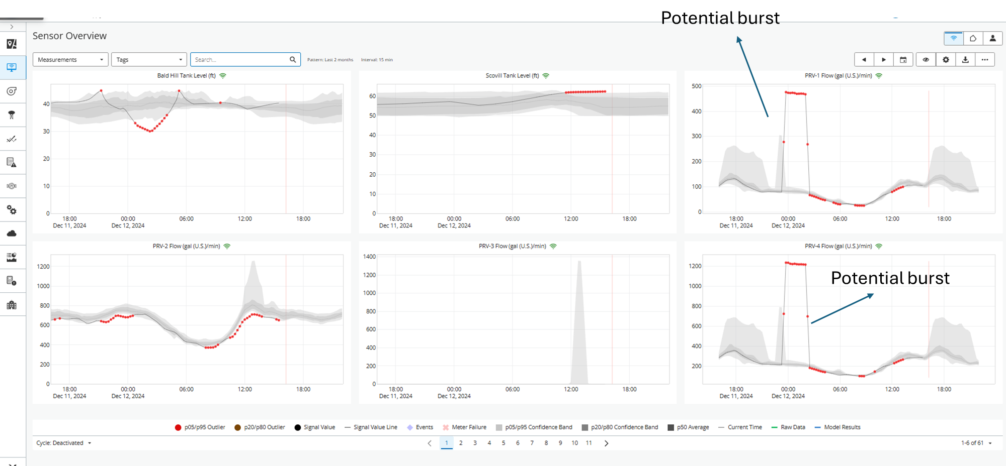

An important dashboard in WaterSight is the Sensor and Zone overview dashboards where side by side graphs with real time measurements represented by black line with red dots (resampled to 15 minutes) are compared with expected values (grey bands). Whenever expected values go outside the expected ones (patterns) they get colour coded red and this can call immediately the attention of operators for potential issues that might be occurring, including leaks and bursts. More information here - Sensor Overview/ Zone Overview. These dashboards are usually played in the big screens inside a water utility control room.
Figure 6 - Sensor overview dashboard with side-by-side graphs for each sensor, showing and comparing real time values (black line with the red dots) from expected patterns (grey bands)

WaterSight can help reducing repair times by increasing awareness of new breaks occurring in the system. In fact, automatic alarms are triggered whenever anomalies are detected in the system and those become available in the Active Event list for users to manage.
Figure 7 - Example of a medium burst event detected by the software - real time data represented with the line with the black/yellow/red dots starts to deviate from the expected trend/patterns represented with grey colour.

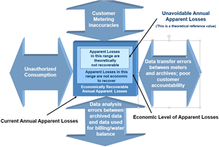

Apparent Losses

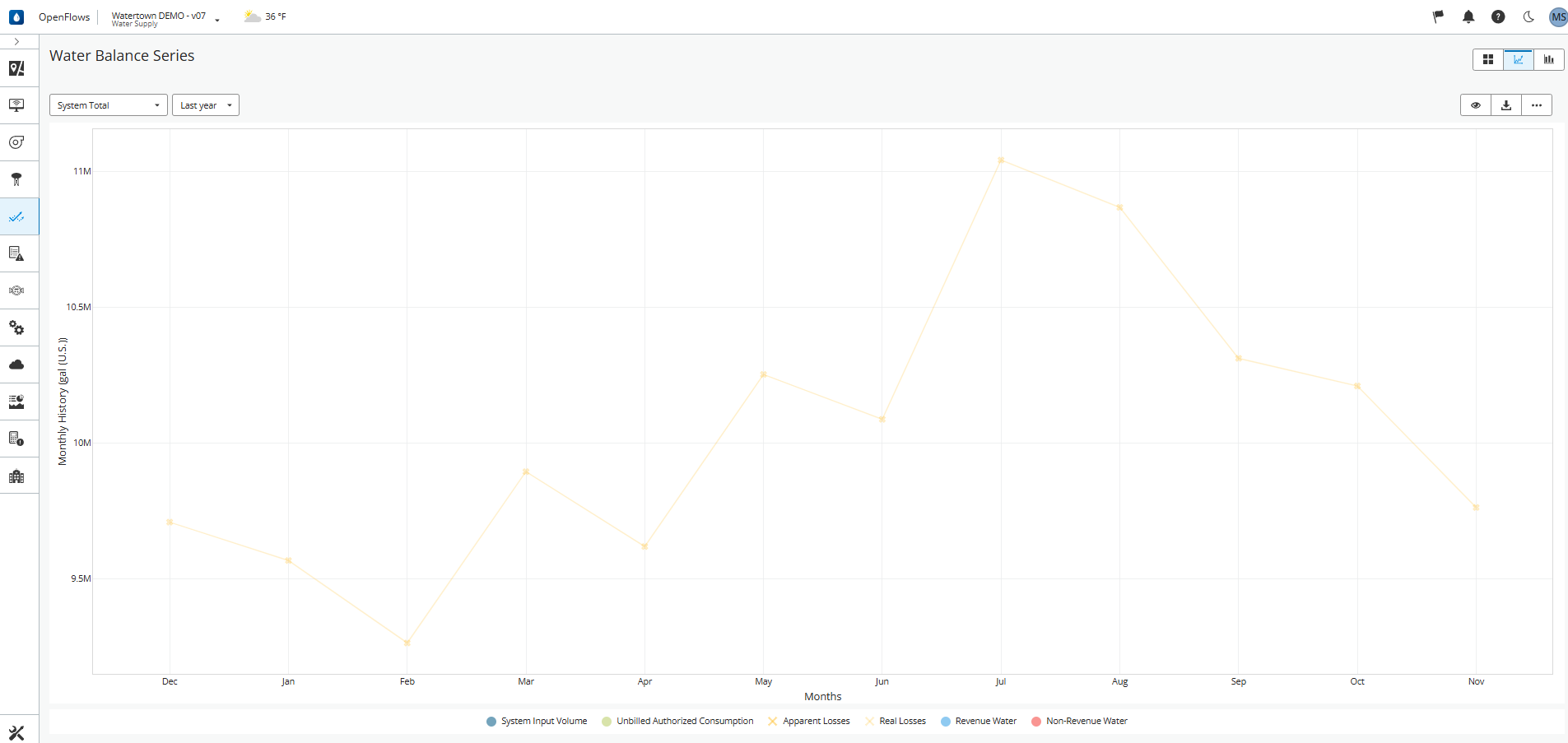

WaterSight automatically computes water losses and can also quantify the relation between real and apparent losses. To know more on how apparent losses are calculated please see this article.

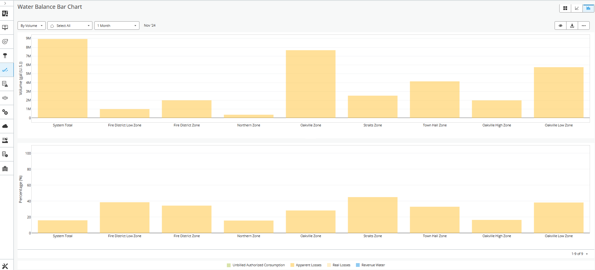

By calculating apparent losses volume and percentage, the software can help in the identification of priority areas for apparent losses activities (that can include illegal consumptions detection and customer meters replacement). Please note that both apparent losses volume and percentage should be always analyzed together: bigger zones tend to have higher volumes associated, which is an important variable, however apparent losses activities should also be done in areas where there is higher potential for reduction, and this usually happens in zones with higher percentages.
Figure 8 - Apparent losses volume  (above) and apparent losses percentage (below) for each zone

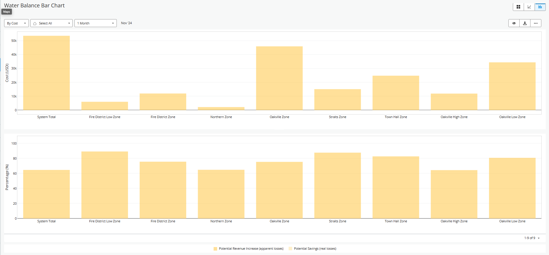

Another variable that is calculated is the apparent losses cost. While when reducing real losses there is a direct decrease in the production and transportation costs, apparent losses decrease have a direct impact on revenue. For example, when replacing customers meters that are stopped or under-measuring, there is a direct increase in the revenue by installing new meters; also when illegal connections are detected and the situation is regularized there is a direct increase in the revenues.
The most important message here is that although real losses volumes may be the biggest component on the total water losses volume, sometimes the apparent losses costs are higher than the real losses costs, because water tariff is higher than the water production cost.
Figure 9 - Apparent losses cost (above) and cost in terms of percentage (below) for each zone
