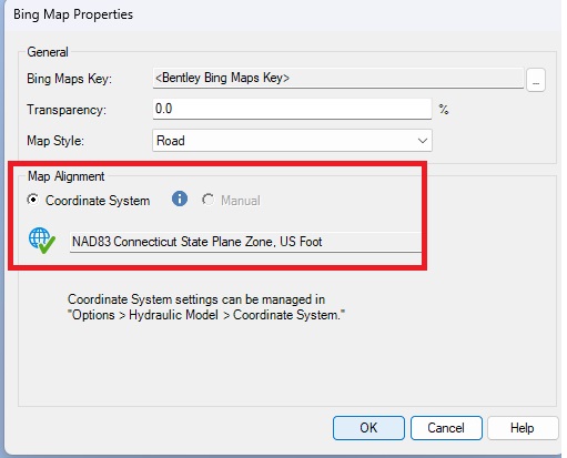

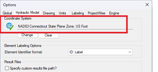

How do I determine what projection, coordinate system or spatial reference a model has been set to? For example I have received a WaterGEMS model from another consultant and need to figure out what coordinate system it is in.
Starting with version 24.00.02.XX, coordinate system support has been added to the Bing Maps background layer. You can (optionally) assign a coordinate system to align your model to a Bing Maps background layer. If you are using feature, you can find the coordinate system you are using by either going to File > Options > Hydraulic Model and checking the coordinate system being used or by open the properties of the Bing Maps background.
Starting with version 26.00.00.XXX, you can also reproject a model with this feature (choose a different coordinate system and you will be prompted if you'd like to reproject) and data imported via ModelBuilder and LoadBuilder will automatically reproject to the model's coordinate system (if the external data is in a different coordinate system).
