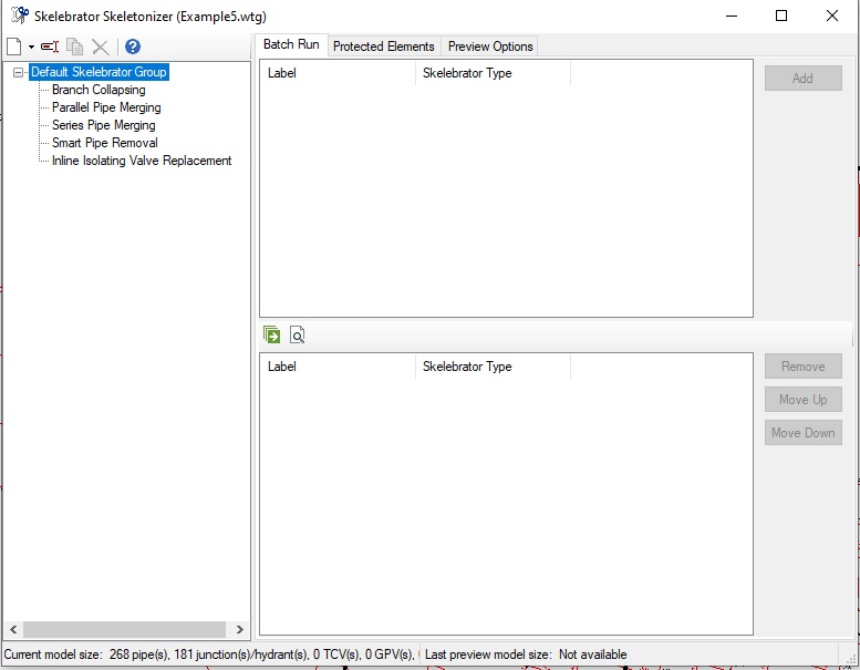

There are few Skelebrator options: Branch Collapsing, Parallel Pipe Merging, Series Pipe Merging, Smart Pipe Removal, and Inline Isolating Valve Replacement. Information on each of these can be found below.
At the very bottom of the Skelebrator manager, you will see the current number of pipes and nodes in the model. When you preview a skelebration run, will see the number of elements included in this.
At the top, you can click the New button to choose the type of skelebration you want to run. In addition, to the Compute button, which runs the skelebration, there is an option to run a manual skelebration and a Preview button. The Preview option lets you see the elements that will be removed or combined during the skelebration.
On the right side of Skelebrator, there is a batch run option. If you set up multiple types of skelebration, you can use this option to run all of them at once.

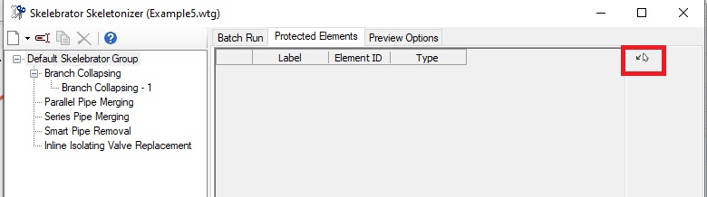

In the Protected Elements tab, you have the option to pick elements that will not removed when you run Skelebrator. This is used if you have elements that are important and need to remain in the model after simplifying it. To pick the protected elements, click the Select in Drawing button to open the Select tool.
NOTE : You should use the protected elements option for specific locations that you want to observe e.g. pressure (or other) results at, for example to avoid branch collapsing removing a branch where you need to check the pressure at the end of that branch. When you are removing a branch by adding its demands on the branch node, you would want to check hydraulic results at such locations, in that case using protected elements feature is useful.

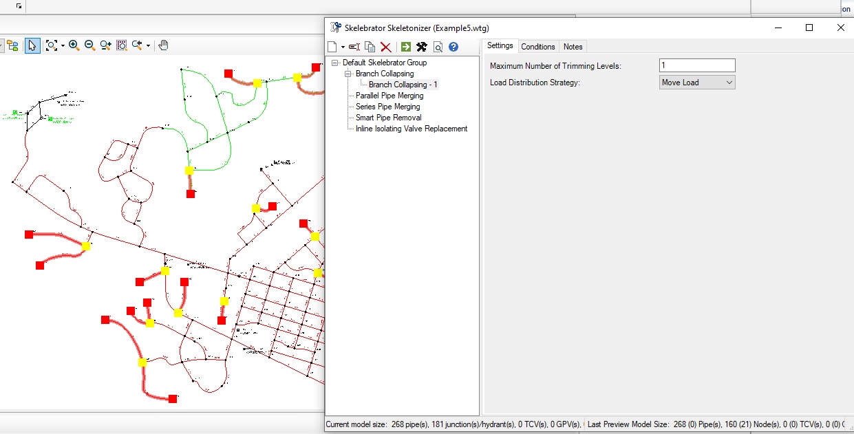

Branch Collapsing
Branch Collapsing is used when you want to eliminate dead ends in a system. Skelebrator will find branches in the system and remove the pipes and nodes.

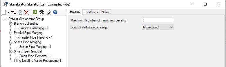

After creating a Branch Collapsing, use the Settings tab on the right side of the Skelebrator manager to define how the skelebration runs. For the Maximum Number of Trimming Levels, you can define the number of trimming levels you want to allow. In Branch Collapsing, a single trimming level run to completion would trim every valid branch in the model back by one pipe link. Two trimming levels would trim every valid branch back two pipe links and so on.
For the Load Distribution Strategy, you would select how you want the demand allocated. If you set this to Move Load, the demand will move to the next junction upstream. If you select Don't Move Load, the demand will be deleted from the model along with the junction.

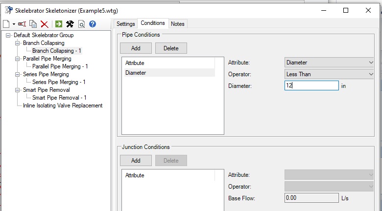

In the Conditions tab, you can set select parameters that determine which pipes are included in the skeletonizing process in the Conditions tab. In Branch Collapsing, the junctions referred to in junction conditions are the two end junctions of the pipe being trimmed. Tolerances can also be defined for junctions by selecting "Tolerance" as the Operator. Tolerances work by limiting the pipes skeletonized only to the ones that have the specified attribute within the specified tolerance. For example, in Branch Collapsing you can set a tolerance on junction elevation of 3 feet would limit skeletonization to pipes that had both end junctions with an elevation within three feet of each other. For pipes, you can enter a diameter tolerance for example so that two adjacent pipes are only merged of they are the same diameter (zero tolerance) or within a tolerance value that you enter. See also: Preventing Skelebrator from merging pipes unless they have the same diameter

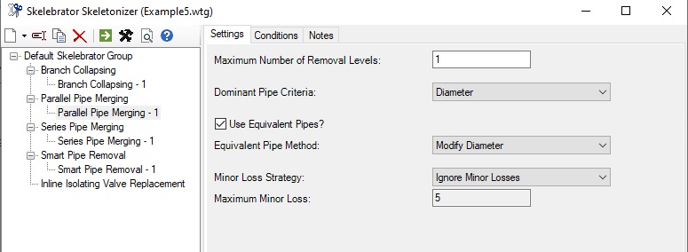

Parallel Pipe Merging looks for pipes that are in parallel with a shared start and stop nodes. If you have two pipes in parallel, Parallel Pipe Merging will remove on of these from the model. After creating a Parallel Pipe Merging, use the Settings tab to define how the skelebration will run. For the Maximum Number of Trimming Levels, you can define the number of trimming levels you want to allow. If you set this to 1, if there are three parallel pipes, it will be reduced to two pipes.
Dominant Pipe Criteria is used to determine which of the pipes is the dominant pipe, and thus the pipe whose properties are retained. For example, when merging a 6-in pipe and an 8-in pipe, if diameter is selected as the dominant pipe criteria then the larger diameter pipe (e.g., 8-in) will provide the properties for the new pipe. That is, the 8-in pipe's diameter, roughness, bulk reaction rate, etc., will be used for the new pipe.
If the field Use Equivalent Pipes is checked, Skelebrator will adjust the properties to accommodate the removal of other pipes. If selected, you would define the Equivalent Pipe Method by selecting if you want to modify the dominant pipe roughness or the dominant pipe diameter for the equivalent pipe calculations. If Modify Diameter is selected, the new pipe's roughness is kept constant and the diameter adjusted such that the head loss through the pipe remains constant. If Modify Roughness is selected, the new pipe's diameter is kept constant and the roughness adjusted such that the head loss through the pipe remains constant.
For the Minor Loss Strategy field, you select how you wans Skelebrator to manage minor losses. You can choose to ignore the minor loss, which means the merged pipes will have a minor loss of zero. If you choose Skip Pipe if Minor Loss > Max, you would protect pipes from being skeletonized if there is a minor loss greater than the maximum value you enter. If you choose 50/50 Split, the merged pipes will have 50% of the sum of the minor losses from the parallel pipes.
In the Conditions tab, you can set select parameters that determine which pipes are included in the skeletonizing process in the Conditions tab. With Parallel Pipe Merging, you can enter certain pipe conditions for the run. For example, you can enter condition related to diameter such that the only pipes that can be removed are less than a given size.

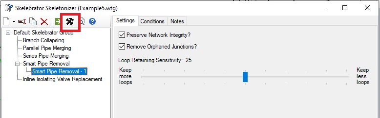

Smart Pipe Removal

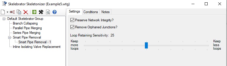

Smart Pipe Removal is a data scrubbing technique that allows the user to remove small diameter pipes (including those that form parts of loops) while retaining network connectivity and important elements, like pumps and valves. The algorithm used marks elements that can be safely removed without causing this issue.
When using Smart Pipe Removal, check the box for Preserve Network Integrity to assure pipes are not removed that will inhibit the calculation of a model. By checking the box for Removed Orphaned Junctions, nodes that have no pipe connected to them will be removed from the model. If there are no demands on the orphaned nodes, the model will still compute, but you will see user notifications about nodes being disconnected from a reservoir or tank.
The Loop Retaining Sensitivity setting controls how sensitive the pipe removal algorithm is to retaining loops in your model. A low setting will mean a higher number of loops in the model and a high setting means fewer loops. This feature is only available when using the Preserve Network Integrity option.
There is an option to include pipe conditions in the Conditions tab for Smart Pipe Removal. Using pipe conditions is highly recommended when using this skelebration method. Smart Pipe Removal is largely used to remove small diameter pipes while retaining network connectivity. By including a pipe condition based on diameter, this will assure that larger diameter pipes are not inadvertently removed from the model.

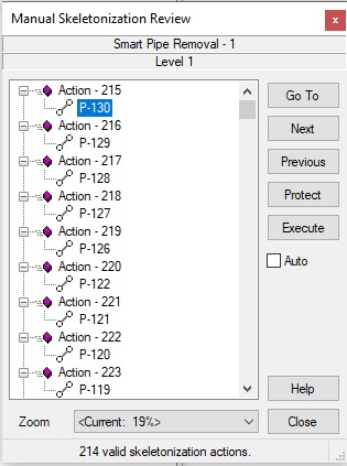

Manual Skeletonization allows you to step through each individual removal candidate. The element can then be removed or marked to be excluded from the skeletonization. You can save this process and choices you made and reuse them in an automatic skeletonization of the same model.
Manual Skeletonization is based on one of the methods described above. For instance, if you are using Series Pipe Merging, the process will only look at pipes in series.
To access this, click the Manual button at the top of Skelebator.
A new dialog will open where you can review the elements that would be removed during the process. You would check each action in turn and either execute or protect the element. This method allows for complete control over the elements removed during the process.

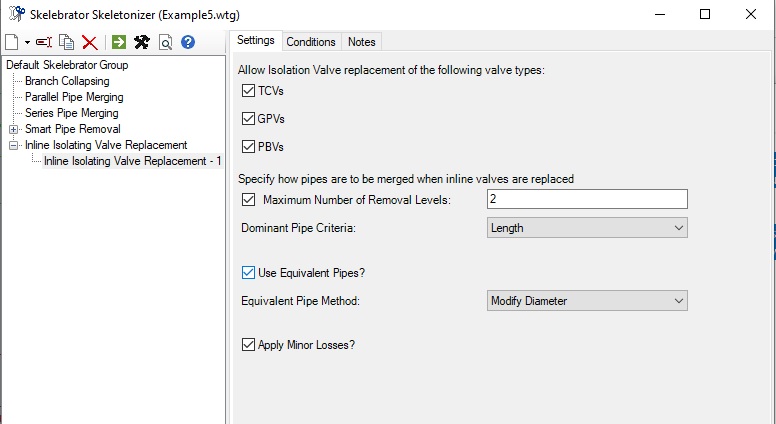

This is a special type of skeletonization used specifically to removing certain types of valves from a model and replace them with isolation valves. In the process of creating a model, you may have added a valve like a TCV or a GPV to act as an isolation valve. WaterGEMS, WaterCAD and HAMMER include an element type for isolation valves that works a little differently compared to other valve types. An isolation valve does not split a pipe. Instead it is associated with (linked to) a pipe and can have a setting of open or closed.
Inline Isolating Valve Replacement will identify existing TCVs, GPVs, and PBVs in a model and merge the pipes on either side of these valves. The valve will be replaced with an isolation valve that is associated with the new merged pipe.
In this method, you would select the types of valve you want to replace. Note that PRVs, PSVs, and FCVs are not included in this method. In most models, these have specific purposes other than acting as isolating valves. In addition, if there is a valve that should not be replaced by an isolation valve, this should be included as a protected element.
You will also have the option to set a maximum number of removal levels, similar to other skeletonization methods. You would also define the dominant pipe criteria, which determines the dominant pipe (the one that will be kept after the operation). The dominant pipe is the pipe whose properties are retained as appropriate. For example, when merging a 6-in. pipe and an 8-in. pipe, if diameter is selected as the dominant pipe criteria then the larger diameter pipe (e.g., 8-in.) will provide the properties for the new pipe. That is, the 8-in. pipe's diameter, roughness, bulk reaction rate, etc., will be used for the new pipe.
Use Equivalent Pipes is used if pipe diameters or pipe roughnesses are different on either side of the valve. This will create an equivalent pipe so that the hydraulics are similar once the pipes are merged. You can also apply minor losses to the new isolation valve by checking the box for Apply Minor Losses.
More information on Inline Isolating Valve Replacement can be found here: How to convert a TCV, GPV, or PBV to an isolation valve using Skelebrator.
