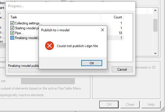

2. "Could not Publish i.dgn file"
When trying to publish i-model in 10.03.xx.xx version the following dialog appears saying - "Could not Publish i.dgn file"

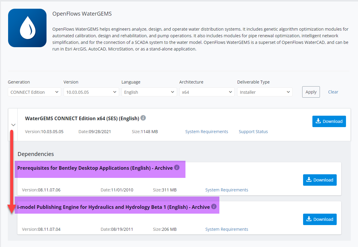

Please make sure that you have installed both the "Prerequisites and i-model Engine" installation as highlighted below. –
If NOT, please install them in the following order -
1. Close all the applications
2. Install "Prerequisites for Bentley Desktop Applications (English) - Archive" using the "pbda08110706en" file.
3. After that install the "i-model Publishing Engine for Hydraulics and Hydrology Beta 1 (English) - Archive" using the "imeh08110704en" file.
4. Open a file and try to publish i model.
The prerequisites and i-model publishing engine must be installed before you can publish an i-model from Bentley Hydraulics and Hydrology products.
