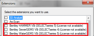

Why is my license listed as "Not Available" under the extensions (Customize > Extensions) in ArcMap?
Product(s):WaterGEMS, SewerGEMS, Hammer
Version(s):CONNECT Edition and newer
Environment:ArcMap
Area:Licensing
When I go to view the extensions (Customize > Extensions) in ArcMap I see the license for WaterGEMS, SewerGEMS or HAMMER is listed as "not available". Why ?
WaterGEMS, SewerGEMS, and HAMMER, which all integrated with ArcMap are not extensions in ArcMap. They are fully built into the ArcMap interface through the API. As long as you have your OpenFlows product license set up in the Bentley Licensing Tool the product license will work. The "license not available" will always show in the extensions list due to the way that ArcMap works, and it does not mean that there is a problem.
