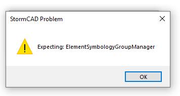

Error message opening model - "Expecting: ElementSymbologyGroupManager"
Product(s): SewerGEMS, CivilStorm, StormCAD, SewerCAD, WaterGEMS, WaterCAD, HAMMER
Version(s): CONNECT Edition
Area: Modeling
When opening a model, the following error message is generated: "Expecting: ElementSymbologyGroupManager"
