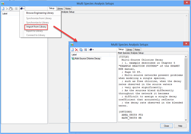

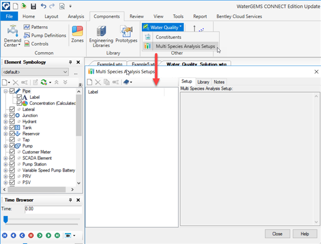

It can be accessed from Components > Water quality > Multi Species analysis setups (or Components>Multi Species analysis setups. for V8i)

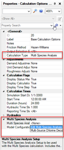

To perform a multi-species analysis,
Note:

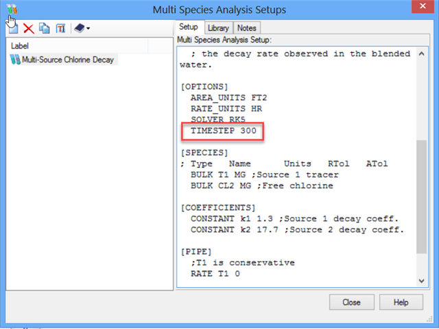

The timestep for calculations that is used in the multi-species analysis is the one which is defined in the OPTIONS section of the Multi Species analysis setup. If it is not defined in the options of Multi Species analysis, then the default water quality time step is used which is 1/10th of the hydraulic time step.
Note: if you modify the TIMESTEP parameter and your model calculation fails with "could not read hydraulic results file", the model run duration may not be divisible by the timestep you selected (for example 250 seconds for a 144.0 hour simulation).

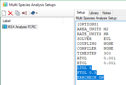

Advanced [OPTIONS] Parameters
The following Parameters are planned to be available in the next major version released after 10.01.01.04. If you have 10.01.01.04 and a newer version is not yet available, please contact Technical Support. You can add them under the "[OPTIONS]" section of your MSX Setup.
LTOL - An optional length tolerance in feet (if not supplied defaults to 0). Wall reaction calculations will be skipped for pipes with length below this tolerance. Segments still get transported (and are subject to bulk reactions) as normal. By default, pipes with a length of zero are ignored in this fashion; this option extends that to a tolerance that you can specify.
FTOL - An optional flow tolerance in gal/min (if not supplied defaults to 0). Wall reaction calculations will be skipped for pipes with flow below this tolerance, at each given timestep. Segments still get transported (and are subject to bulk reactions) as normal. By default, pipes with a flow of zero are ignored in this fashion; this option extends that to a tolerance that you can specify. Smaller FTOL values should provide more accurate results but if set too low, numerical error can be introduced from low flow pipes. The exact value to use may be different for each system and the user may need to experiment to get good results
ERRCHECK - An optional flag for specifying whether MSX error checking is enabled (if not supplied defaults to ON; valid options OFF or ON). If set to "OFF", then error conditions that would otherwise cause the calculation to fail, will be suppressed and the calculation will proceed. For example Care must be taken in this case to closely review the concentration results which could be compromised. Further reporting on failures when error checking is ignored, are planned to be included in a future release.

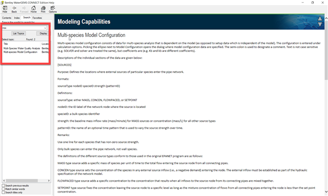

Information on much of the input can be found in the EPANET MSX manual. The following are some key points related to various input:
MASS - A MASS type source adds a specific mass of species per unit of time to the total flow entering the source node from all connecting pipes.
CONCEN - A CONCEN type source sets the concentration of the species in any external source inflow (i.e., a negative demand) entering the node. The external inflow must be established as part of the hydraulic specification of the network model. Note: for this to work in tanks or junctions, inflow will be needed.
FLOWPACED - A FLOWPACED type source adds a specific concentration to the concentration that results when all inflows to the source node from its connecting pipes are mixed together.
SETPOINT - A SETPOINT type source fixes the concentration leaving the source node to a specific level as long as the mixture concentration of flows from all connecting pipes entering the node is less than the set point concentration. SETPOINT is a booster that will add mass.
