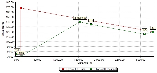

In the past (before the introduction of the air valve element), high points in a pipeline in WaterCAD or WaterGEMS would not be considered for the pump operating point. Basically they would only consider the boundary conditions (reservoirs and tank elevations) in your system. So, the pump will add enough head to lift the water to the downstream known hydraulic grade. It does not consider junction elevations in between and simply calculates a pressure at the junction locations based on the difference between the hydraulic grade and the physical elevation. So, this sometimes resulted in a negative pressure being calculated in the vicinity of the high point. This situation can be seen in the profile below, in which the hydraulic grade line (in red) is lower than the pipe elevation (in green) at the high points.
This approach basically simulated the effect of water being siphoned over the high point, which is usually not the case in real systems, since most utilities place air release vacuum breaker valves at the high points, and since the vapor pressure of water limits the height of a potential siphon. Since neither of these factors was accounted for in most pressure pipe models, including older versions of WaterCAD and WaterGEMS, the results typically overestimated pump flow and underestimated head (i.e., the pump ran too far to the right on its curve). Basically the head added by the pump was lower than what would really be necessary to 'lift' the water to the high point

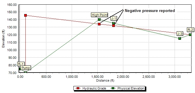

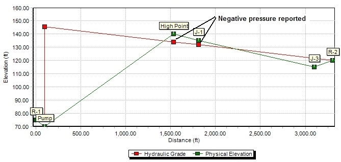

In earlier versions of WaterCAD and WaterGEMS (V8 XM and below), it was difficult to implement a workaround to this problem. Some possible solutions included placing a small tank at the high point, controlling flow with a FCV (flow control valve) or using a PSV (pressure sustaining valve) to set the pressure to zero. In many cases, the modeler would simply ignore the negative pressure and accept the pump operating point.
However, even with a workaround, modelers sometimes found that the high point may be pressurized for higher flows, as shown below. This situation could prove especially problematic in the case of an extended period simulation demonstrating both flow regimes.

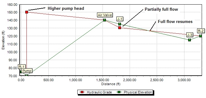

WaterCAD and WaterGEMS V8i provide an answer by incorporating a new air valve element. By placing an air valve at the high point, the pump sees the air valve elevation as its downstream boundary condition for instances in which pressure would have otherwise been negative at the high point:
Note: The Air Valve element was actually added to WaterCAD and WaterGEMS in the V8 XM release, with version number 08.09.400.34. However, the air valve in this version did not include the special behavior described in this technote; it always acts as a junction during the EPS or steady state simulation. It only operates during a transient simulation, when opening the model in Bentley HAMMER.
For instances in which the pipeline functions under pressure/full flow for its entire length (e.g., during the high-flow condition), the pump operating point is correctly based on the downstream boundary condition, similar to the behavior in older versions.
When the air valve is open, the hydraulic grade on the downstream side may be less than the pipe elevation. This can be displayed as the hydraulic grade line drawn below the pipe. This should be interpreted as a pressure pipe that is not flowing full. Full flow resumes at the point where the hydraulic grade line crosses back above the pipe. To accurately observe this phenomenon in a profile, you should ensure that the elevation of the junction immediately downstream of the air valve is above the point where full flow resumes. For example if your next-downstream junction is far away and at a low elevation, you may not observe the part-full phenomenon. This is because WaterCAD/WaterGEMS can only report/compute hydraulic grade at nodes, so it can only draw the HGL between them.

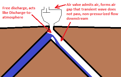

If this situation occurs in the initial conditions (steady state or EPS) in HAMMER, note that it may be best to end the system at the high point using the Discharge To Atmosphere element, since the transient waves would not travel past the air gap / part-full flow, and since the discharge at that points acts like free discharge:
