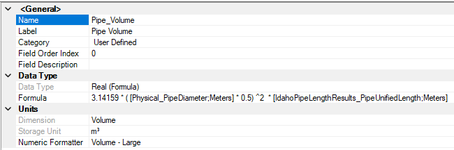

Volume
In the OpenFlows storm and sewer products, to find the total volume of all pipes (some may refer to this as the capacity) you'll first need to find the total volume of each pipe. You can do this by creating a formula based user data extension (UDX). If you only have circular pipes, the formula would be  Pi * (diameter * 0.5)^2. For box, it would be Rise * Span. If you have a mix, you can use the "iif" function.
Once done, you can add up the volume of all pipes either by copy/pasting the column from a flextable into an Excel spreadsheet, or by adding the newly created UDX field to the flextable then right clicking on the column header and choosing statistics. The directions in the article below outline how to create a formula UDX:
Creating Formula Based User Data Extensions
