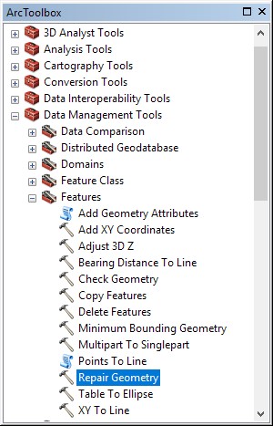

Open the shapefile in ArcMap and run the "Repair Geometry" tool located in the Data Management ArcToolbox (ArcToolbox > Data Management > Features > Repair Geometry). Once this is completed, try the shapefile in ModelBuilder again.
Note that you can also run the Check Geometry option to see if there are potential issues that will need repair first.
