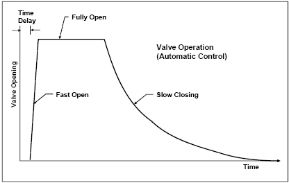

Usage - Surge Anticipator Valve
In a typical operation, when the pressure at the SAV valve falls below the threshold value, it opens up to the atmosphere in anticipation of a subsequent upsurge of high pressure. An upsurge like this is typical of an emergency pump shutdown, so the valve is usually installed at the discharge header. The surge anticipator valve is already open when the high-pressure transient reaches the valve; sensing of high pressure is not required to initiate the opening of the valve. The valve then closes slowly so as not to cause a transient.
In some cases, these valves can be a cheap protection alternative to a surge tank or hydropneumatic tank, but are typically not as effective. This type of valve is more effective than a SRV when high-pressure transients occur so quickly that the SRV does not have adequate time to respond and open. Care must be taken in setting the low-pressure activation point to avoid premature opening before the pump has spun down, since that can cause a very steep negative transient wave.
In addition to opening and closing based on a threshold pressure, you can operate the SAV based on time. In this case, you would define not only the time to open and close, but also how long the SAV will stay open.
Note: The SAV is treated as a junction with no demand during the initial conditions calculation. In addition. air inflow is not supported if the pressure drops below zero during the transient simulation.
Attributes - Surge Anticipator Valve
Threshold Pressure (SAV) - This is the pressure below which the valve opens up to the atmosphere.
Discharge Coefficient (when SAV Fully Open) - This is located under the "Transient (Physical)" section of the properties and is used to define the discharge coefficient (Cv) of the SAV when it is fully open. Basically, at the time when the valve is fully open, the discharge out to the atmosphere is represented by this coefficient. For more information on what HAMMER expects for this discharge coefficient, see: What is the "Discharge Coefficient"? For further guidance, see: How can I calculate the discharge coefficient (Cv) of a SAV?
Diameter - This is not used in the HAMMER calculations but is useful for display purposes. Flow through the valve is determined based on the discharge coefficient when fully open and the valve type. It is assumed that the percent of open-area curve for each valve type corresponds to its discharge coefficient curve.
SAV Closure Trigger - This identifies the method used to trigger closure of the SAV after it has opened. It can either be based on time or a threshold pressure. When time-based, you must enter a specific duration that the valve is open. When pressure threshold-based, the SAV will begin to close when the pressure at the SAV rises back above the threshold pressure.
Depending on the setting for the SAV Closure Trigger property, additional properties will be displayed.
When using Threshold Pressure as the closure trigger:
Time for SAV to open - Once the pressure falls below the threshold pressure, this is the time it takes for the SAV to become fully open. If the pressure rises back above the threshold before this time has elapsed, the valve will begin to close. If it does not rise above the threshold until after this time has elapsed, the SAV will remain fully open until that time.
Time for SAV to close - This is the time it takes for the valve to close, beginning when the pressure rises above the threshold pressure.
When using Time for the SAV Closure Trigger, the same properties above are available, as well as:
Time SAV Stays Open - The time that the SAV stays fully open between the end of the opening phase and the start of the closing phase.

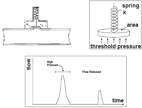

Usage - Surge Relief Valve
The SRV opens up to the atmosphere when the pressure at the SRV rises above the threshold pressure and closes immediately after pressure drops below this setting. This valve is usually installed across the pumps and discharge headers or at critical points along the pipeline in order to control the maximum system pressure. If the SRV closes too quickly, severe transients could occur. The SRV may be too slow to open after a power failure (fast, sharp transient pulse), so it is better for protection against gradual over-pressurization and to limit the pressure rise during normal pumping operations. In some cases, these valves can be a cheap protection alternative to a surge tank or hydropneumatic tank, but may not be as effective.
In a typical application, the SRV is comprised of a vertical-lift plate, which is resisted by a compressed spring. At the threshold pressure, there is an equilibrium between the compressive force exerted by the valve's spring on the movable plate and the counter force applied by the pressure of the liquid. To see how the SRV outflow is calculated based on the system pressure, SRV diameter, threshold pressure, and spring constant, please see the attached spreadsheet (NOTE: you will need to be logged in first or the link will not work)
Starting with HAMMER CONNECT Edition Update 3 (build 10.03.03.72), you can also define how the SRV opens and closes based on time. In such a case, you would enter the time for the SRV to open and the time to close. Note: Time-based operation does not support interruption in the opening and closing of the surge valve.
If you wish to have more control over the outflow characteristics of your surge relief valve (for example for a pilot operated valve instead of one that uses a spring), an alternative method would be to use a TCV (throttle control valve) with a short, large diameter pipe downstream of it connected to a discharge to atmosphere element (configured based on the characteristics of the opening to the atmosphere). The TCV element has many options for modeling its closure characteristics so you could potentially use discharge coefficients and a user-defined valve characteristics curve to model the characteristics of your surge valve's opening (relating pressure to outflow). You would need to use trial and error to determine the operating rule pattern for the TCV, to control when it opens/closes and how quickly. See more here: Modeling Reference - Valve Closure.
Calculation Assumption Notes:
Attributes - Surge Relief Valve
Threshold Pressure (SRV) - The pressure above which the SRV opens up to the atmosphere. This may be controlled by a spring, piloting, or other mechanism.
SRV Type - Select between Spring Loaded and Time-Based.
Diameter (SRV) - The diameter of the opening available to release fluid from the system. It corresponds to the "area" of the plate shown in the above diagram.
Additional properties are available depending on the SRV Type you select.
If you use the Spring Loaded option:
Spring Constant - Change in restoring force of the return spring per unit lift off the valve seat. As a point of reference, a possible value is 150lb/in for example. Contact the valve manufacturer for help determining the spring constant. Consider a sensitivity analysis if unsure.
For a linear spring, the lift, x, is given by the equation: A (P - P0) = k x, where A is the pipe area, P is the instantaneous pressure, P0 is the threshold pressure, and k is the spring constant. In this formulation, the acceleration of the spring and plate system is ignored. As the plate lifts away from the pipe due to the excess pressure, more flow can be discharged to the atmosphere. Currently, there is no maximum imposed on how far the plate can lift.
