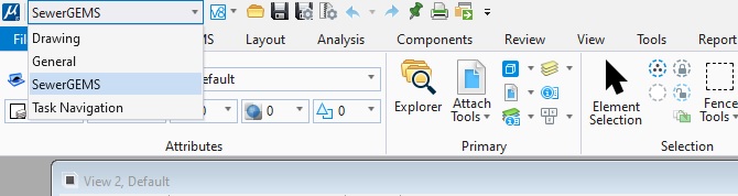

If you are using a compatible version, opening the "...for MicroStation" shortcut, with the WorkSpace is set to "OpenFlows" and the WorkSet is set to the product name and you do not see the menus, make sure that the OpenFlows product is select from the Workflows list in the upper left of the MicroStation dialog.
Note: MicroStation remembers the last item selected in the Workflows list. If you opened regular MicroStation CONNECT Edition between working with the OpenFlows integrated version, you may need to select the OpenFlows product from the list.
See this link for more information: OpenFlows product menus missing from Ribbon interface for MicroStation CONNECT Edition integration version.

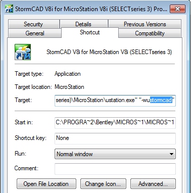

1) Shortcut and UCF file
The first step is initiated when you run the "...for MicroStation" shortcut. If you look at the properties of the shortcut (right click > properties > Shortcut tab) you will notice that the "Target" field has a "-wu<productname>" argument at the end. For example, for StormCAD for MicroStation, you will see "ustation.exe -wustormcad". The "-wu tells MicroStation to load and use the "stormcad.ucf" (UCF - User Configuration File ) with the file name matching the name after "-wu", which is located in the users folder within MicroStation's current workspace. For example, "-wustormcad" tells it to look for and load "stormcad.ucf" and set the "User" (in the MicroStation manager) to "stormcad".

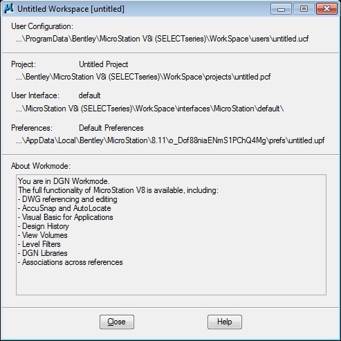

If you have a custom workspace location, the Hydraulics and Hydrology product should automatically detect this during installation and place the file (such as stormcad.ucf) in the correct location, but there are circumstances where this may not happen, such as if MicroStation was installed after the Hydraulics and Hydrology product. So, it is important to check and confirm your Users workspace location. To do this, open plain MicroStation and open any design file using the standard settings in the MicroStation manager (keep the User and Project set to what you normally use). Click the Workspace menu and choose About Workspace. In the dialog that appears, note the path next to "User Configuration" at the top. This is the path to your Users workspace, which may be different from the default location noted above.
If the exact path to the "Users" and "Projects" part of your workspace is still not clear from this, you may need to check with your CAD/IT support to locate the correct place that stores the configurations that define these locations.

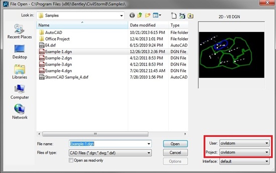

Code in the UCF file (set by step 1) will set the "Project" to the same name (for example "stormcad") by pointing to a <productname>.PCF file in the "Examples" folder within the Projects folder in the MicroStation workspace. The default location is:
C:\ProgramData\Bentley\MicroStation V8i (SELECTseries)\WorkSpace\Projects\
For example, the Stormcad.ucf file loads the file \<Workspace>\Projects\Examples\Stormcad.PCF
Similar to step 1, if you have a custom workspace, you'll need to make sure that the <productname>.PCF file is located in an "Examples" folder within the workspace's Projects folder.
3) CFG file
Code in the PCF file (set by step 2) will load the respective product's CFG file, located in the /config/appl/ folder within the product's installation folder. For Example, StormCAD by default would be:
C:\Program Files (x86)\Bentley\StormCAD8\Config\appl)
The CFG file contains the code that loads all of the components that allow for the hydraulics and hydrology product integration to work. (MDL application, cells, etc.)
Here is a screenshot using CivilStorm as an example, showing how both the User and Project need to be set to the product name in order for the integration to work:
