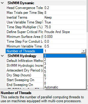

In SewerGEMS and CivilStorm, multi-threading can be used by selecting the appropriate "Number of threads" in the calculation options. This is currently only supported when the active numerical solver is set to Explicit (SWMM) and only applies to the hydraulic calculations. (2D calculations will automatically use available cores/threads) Set the "Number of Threads" option to 4 if it is not already set, or try "automatic".
