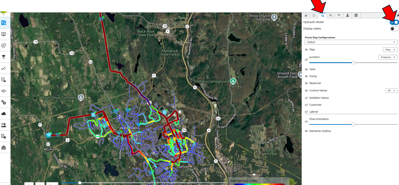

When going to the Map page, make sure on the side widget to switch to the hydraulic model tab, and then toggle on the Hydraulic Model, to enable the real time model of the system.
Here you can investigate past, real-time and expected future performance for each asset using an embedded hydraulic model that is continuously updated with boundary conditions from sensors. The user is no longer limited by the number and location of sensors, being able to readily monitor several parameters at every point in the system.

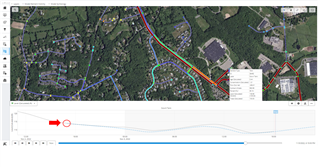

The default map view is an integrated view of the system, where hydraulic model elements are displayed together with the network sensors. When the model is first opened, it displays pipes colored by flow and nodes by pressure while the background is aerial view. The results correspond to the model run based on the most recent boundary conditions (e.g. pump status, tank levels) that have been imported from the SCADA system.
WaterSight can analyze both hydraulics and water quality parameters, such as age and concentration (for example chorine or any other constituent or contaminant). For both simulations (hydraulics and water quality) the conditions need to be first set up in WaterGEMS. For more information please take a look here, at the WaterGEMS Model Setup section.
The user can zoom in or zoom out using the scroll button of the mouse or using the "zoom" button located on the top right corner. It is also possible to navigate to any part of the network by moving the mouse while clicking at the same time in the scroll button (or by clicking in the "pan view" button located on the top right corner). Other options include the zoom extents view ("Fit view") and the button to select any element on the map in order to see the respective properties and results.
Direct measurements from SCADA or other telemetry systems can be used to set the initial conditions for the model run (initial conditions will be always imposed to the instant corresponding to the start of the simulation). More information here. Besides this, SCADA data can also be used to calculate each zone pattern, that can also be used to automatically adjust or calibrate the model demands, in case the Demand Adjustment option is enabled.
In the bottom of the page there is a time slide range bar that allows the user to navigate in the time history. Map results are updated accordingly whenever the user moves the time slide range bar backwards and forward in time. The "Map" marker on the graph allows the user to easily identify the time step that is being analyzed. The "Now" marker on the graph represents the local current time of the machine where WaterSight is running, and should match the current time at the water utility.

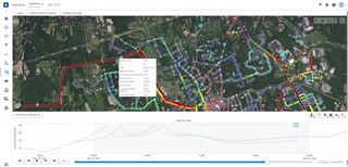

When clicking in any element on the map a table with the main properties and results of the selected element will pop up, together with a graph below.
Model element
For any hydraulic element selected (any pipe, node, pump, tank, reservoir, PRV or TCV) the graph view will display (at blue) the historical results, real time results and forecasts for the variables available, based on the hydraulic model calculations. The historical and forecast period duration is defined at the administration level, in the Numerical Models configuration page. The hydraulic model (WaterGEMS model) can be uploaded in the administration tab (Numerical Models configuration page) and will automatically run at a given (user defined) frequency.

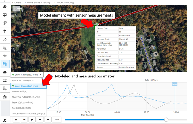

Using the measurement dropdown located on the top left of the graph allows to change the measurement that is displayed in the graph for the specific selected element.

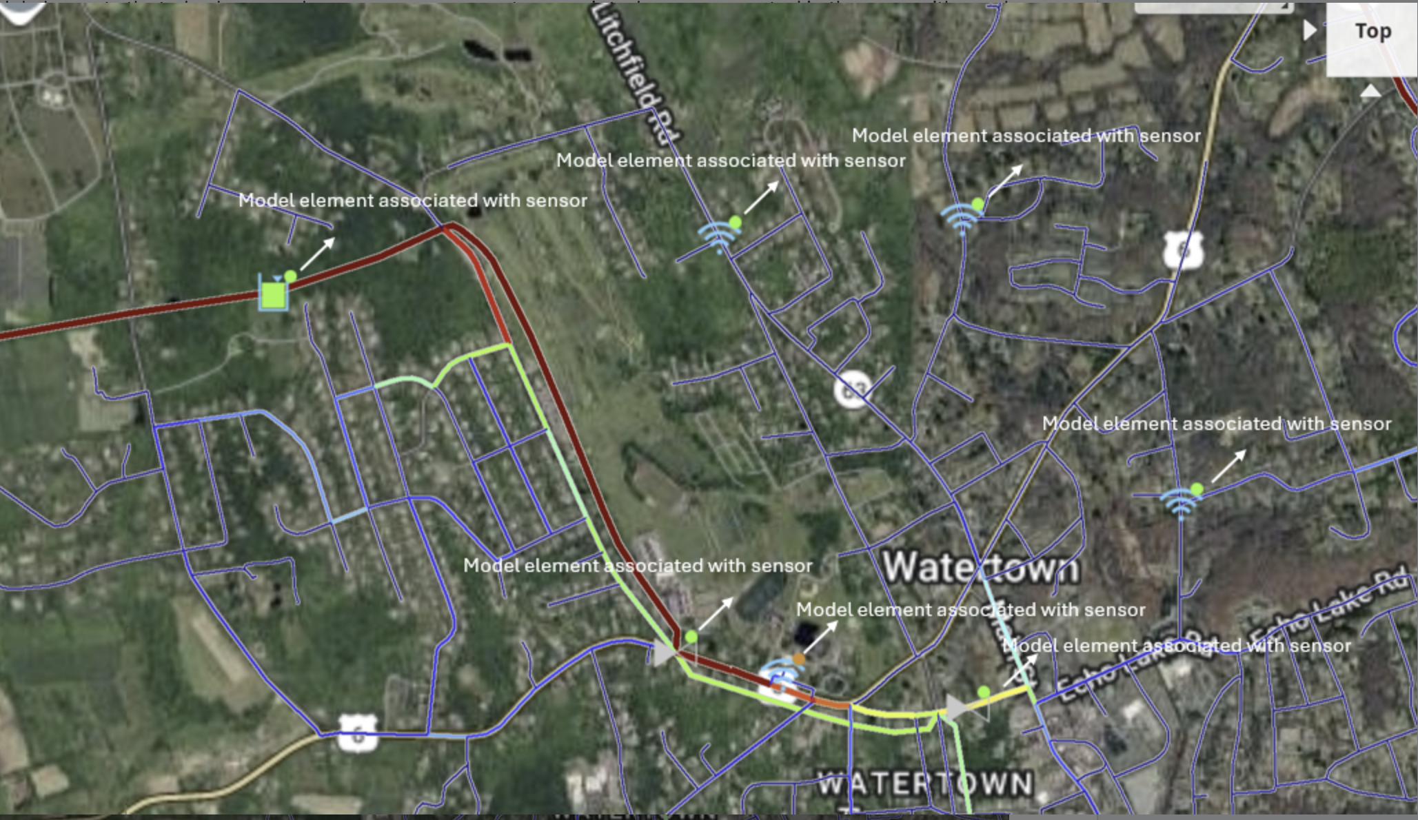

Model element associated with sensor
The model elements that also have real sensor measurements associated are represented in the map with a color coded circle:

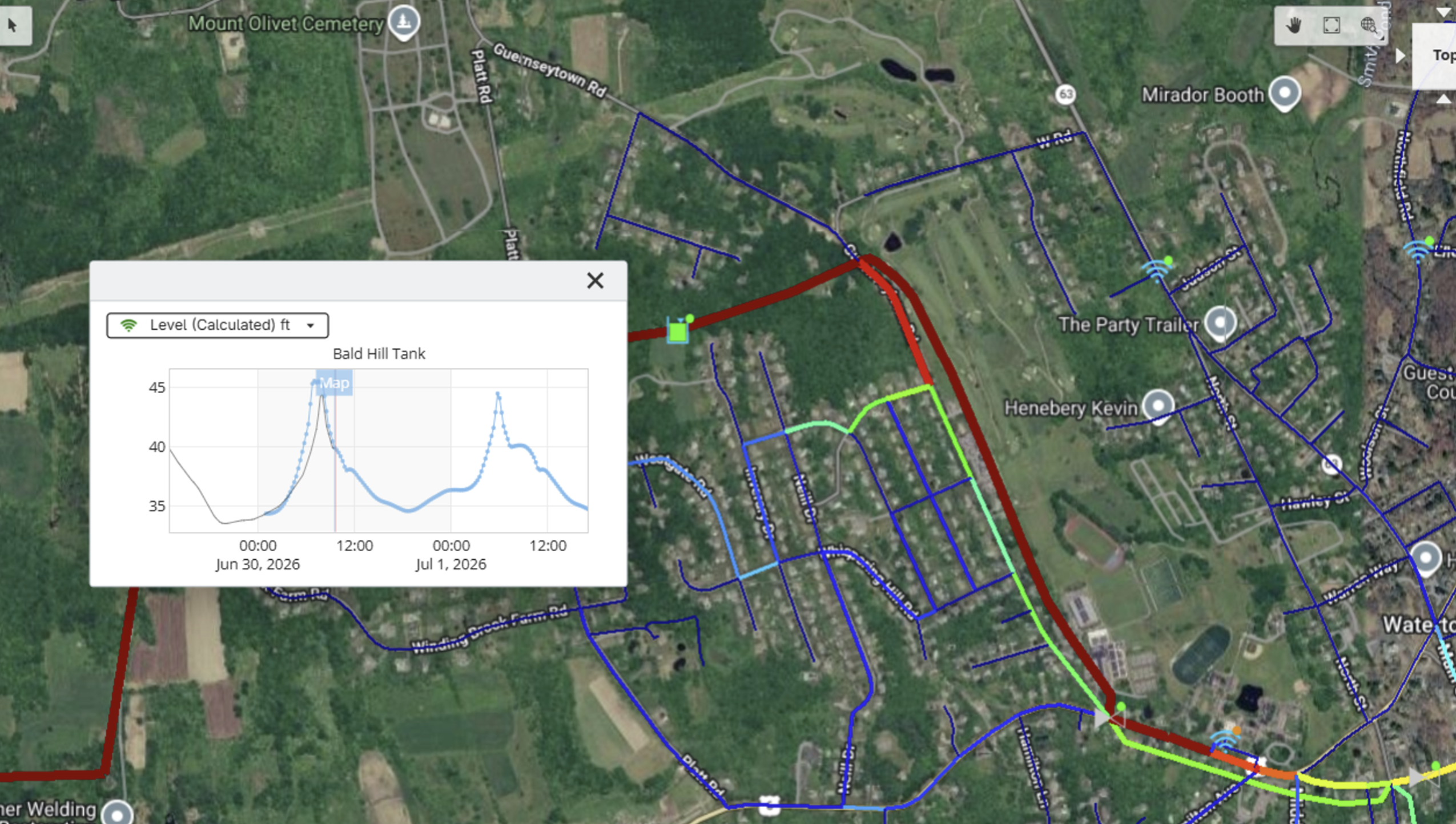

When clicking in one of these elements (with the color coded circle), two lines will be displayed in the graph: black line corresponding to the sensor measurement and the blue line corresponding to the model result. Directly comparing these two lines at some points of interest allow the user to understand how calibrated and accurate the model can be.
Using the measurement dropdown located on the top left of the graph allows to change the measurement that is displayed in the graph for the specific selected element. To directly compare modeled data and measured data  make sure that the graph is related to the modelled parameter for which sensor measurements also exist (in the dropdown with the available parameters, select those that have a wi-fy symbol) - see figure below.
The black line corresponds to the sensor value  while the blue line corresponds to the calculated result from the model. If both lines are near each other, a good fit between modelled and measured data was achieved for that location. Otherwise, further investigation and additional model calibration may be required.

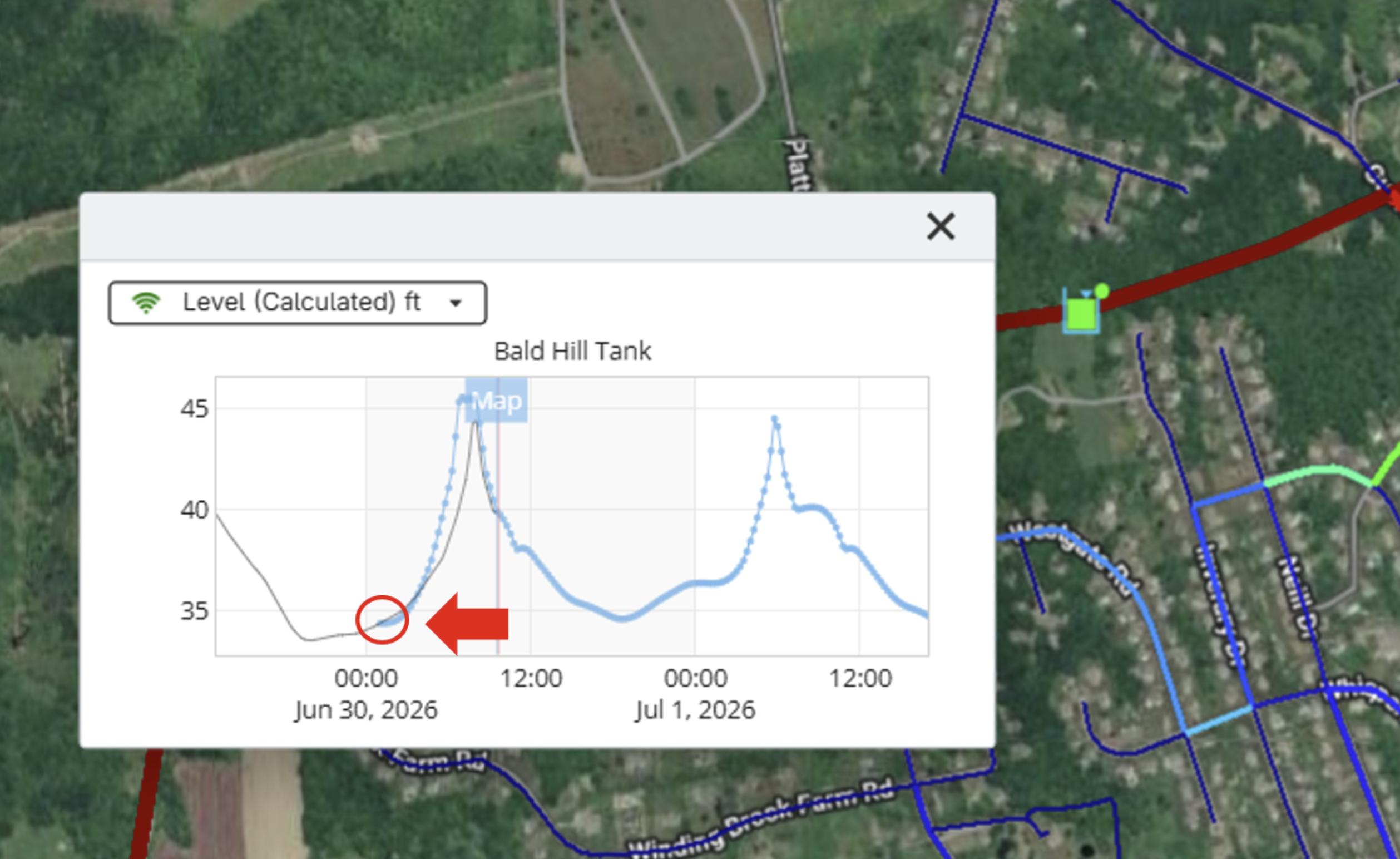

Another important note: if the black and the blue line match the exact same value for the initial time step of the model run (when the blue line starts), then it means that sensor data is being used to set the initial conditions for the model run. In case the blue model line does not start at the exact same point of the measured data,  then the sensor data is not being used to actively set the initial conditions of the model, and sensor data is just used for comparison. See Figure below. The sensors measurements that can be used to override the initial conditions of the hydraulic elements are the following:
More information how to setup, here.
Figure 3. Sensors data being successfully used as initial conditions for the model run.
