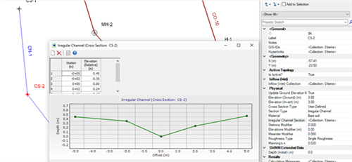

Channels and Gutters
Since SWMM doesn´t directly support channel elements, this kind of element will be exported as conduit links in SWMM. Non-prismatic channels are converted to SWMM style prismatic channels.
While exporting open channels in CiivlStorm and SewerGEMS, its export sets the shape of the SWMM channel based on the start cross section if it exists, otherwise the stop cross section is used.

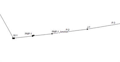

Pumps
Pumps are seen as link elements in SWMM, whereas CivilStorm and SewerGEMS see them as nodes. Therefore, on export to SWMM, a new link element must be created to use as the pump. To do that, two overlapping junctions are created to connect to it. The link in SWMM will have the same name as the pump did in CivilStorm or SewerGEMS. In SWMM, an icon will display for the pump, but when trying to double-click on it, the junction could be selected by mistake.
For Example, take a look the following pump in CivilStorm/SewerGEMS:
Here's what it looks like after exporting to and opening in SWMM
A pump’s upstream conduit is considered virtual after exporting to SWMM.
