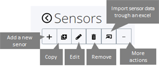

Administration page used to import sensors data (SCADA sensors or data loggers installed in the system) and sensors characteristics into WaterSight. Sensors types available to upload include the following types: flow, pressure, level, pump power and pump status.

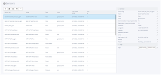

It is possible to import sensors information through a configuration excel file (template file available for download in the Digital Twin Setup page) or to manually add a sensor and its characteristics. After uploading sensor information, it is also possible to edit, delete or copy information, using the available buttons located above the table.
Note: To enable the Copy, Edit and Remove options, please select a sensor first (row in the table). When clicking in a specific sensor (table row) the fields available for editing will appear below the sensor configuration table.
The more actions button includes:

Sensor Configuration Table
Note: Minimum required fields are marked with an asterisk.
