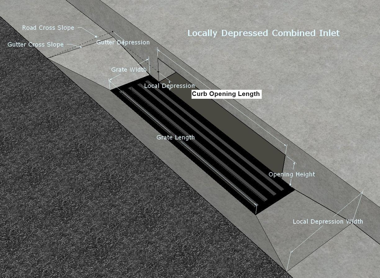

The "Grate width" in the catalog inlet (for a combination or grate inlet) represents how far the grate extends into the road, and the "Grate Length" in the catalog inlet represents how long it is along the road. See diagram below (click to enlarge):
