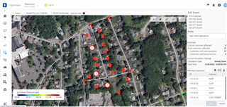

Map automatically zoomed to the location of the event, highlighting all customers affected by the valve operation event, and with the identification of the valves that were opened or closed. Customers and valves are represented with the following colours:
- Red customers: customers with no pressure (no supply) due to the event (more information below)
- Yellow customers: customers with low pressure due to the event (to be able to identify low pressure customers, please make sure a minimum pressure threshold is defined in the digital twin settings, under the service expectations tab. See below for more information on how they are considered)
- Valves initially closed that were set by the user to be opened are represented with a green colour
- Valves initially opened that were set by the user to be closed are represented with a red colour
In the identification of the affected customers all those that always have low pressure or no pressure even without the event (no pressure or low pressure chronical customers) are ignored.
User can click in any element in the map to see the results for a specific element. Graph result will only be available if the event simulation run is Extended Period type, please see below for more information.
Using the map controls, the user can also enable several hydraulic parameters, such as pressure, flow, velocities, etc.

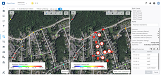

Side-by side view:
Side by side view will only be available for operational events that were created in the last 7 days. If side-by-side view option is on, it will be possible to easily compare the baseline scenario (with no event) with the event scenario. User can click in any element in the map to see the results for a specific element and compare pre and post event conditions. Graph result will only be available if the event simulation run is Extended Period type, please see below for more information.

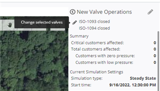

Summary
Statistics about the pump shutdown event:
- Number of critical Customers affected
- Total number of Customers affected, including zero pressure and low pressure
The user can also re-run a different scenario where different valves are selected (without needing to leave the page) by just clicking on the edit button
located near the valves that were operated.

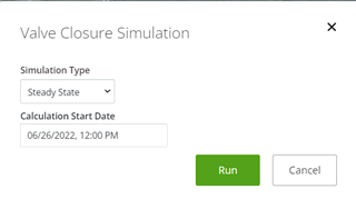

Simulate
The user can re-run again the valves operational event with other configurations.
Clicking in the Simulate button it will open a dialog to run the steady state or extended period simulation with the some user defined settings.
Steady state run
Hydraulic model engine will run in order to identify customers impacted by the event (customers without supply and customers with low pressure). Steady state means that the period analyzed corresponds only to the one instant where valves were opened or closed, according to the user configuration. In that case, above the simulate button, it will be displayed Steady state as simulation type.
Extended period run
Extended period means that the period analysed comprises a specific duration (and not an instant) defined by the user. In that case, above the simulate button, it will be displayed Extended Period as simulation type.
