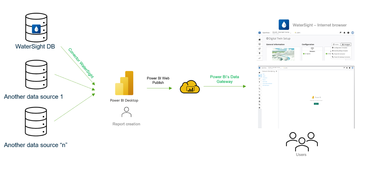

The following picture illustrates the architecture and workflow of the gateway connection. The Power BI construction should be done using Power BI’s Desktop application, and it can be connected to different data sources, including WaterSight’s. This connection is explained in another user manual available here: A Guide on how to create PowerBI Reports.
Once having the Power BI desktop report done, it needs to be Published to Power BI’s web capacity held by your account/company, and its embedded URL can be stored into WaterSight (process also explained in the previously mentioned article). The automatic update of this report will be handled by the Power BI’s data gateway service, that is configured in the Power BI’s workspace management accessed by any internet browser, then user can configure the automatic refresh frequency.
Architecture

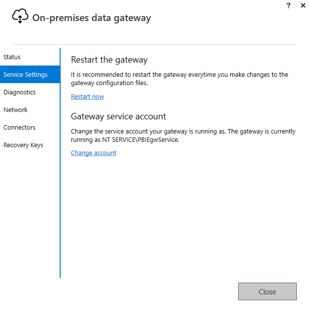

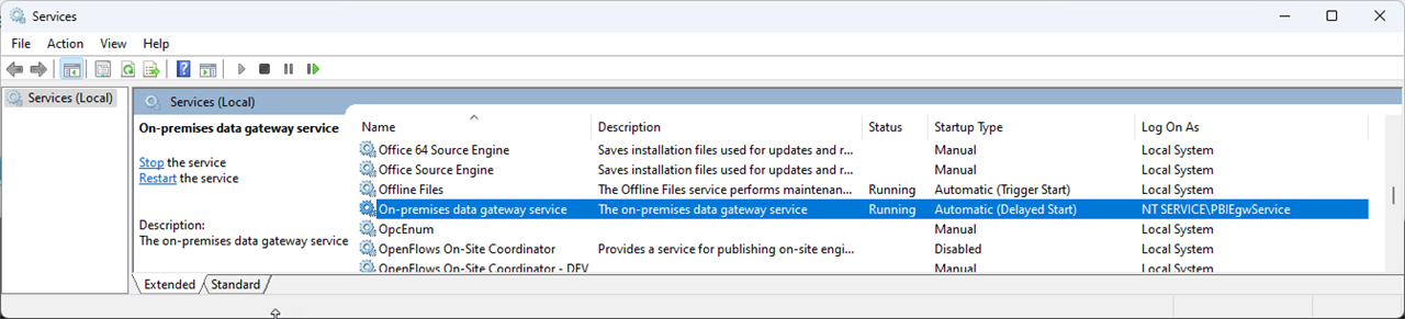

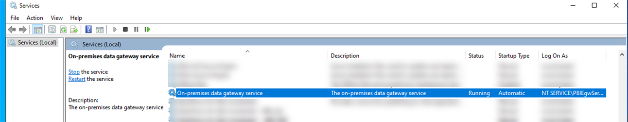

It’s recommended to install the gateway on a 24/7 server if you are planning to have continuous dashboard updates. The installation adds a Windows Service named “On-premises data gateway service”, and runs initially using the local service account “NT SERVICE\PBIEgwService”:
This account can be changed during the creation of the gateway connection.

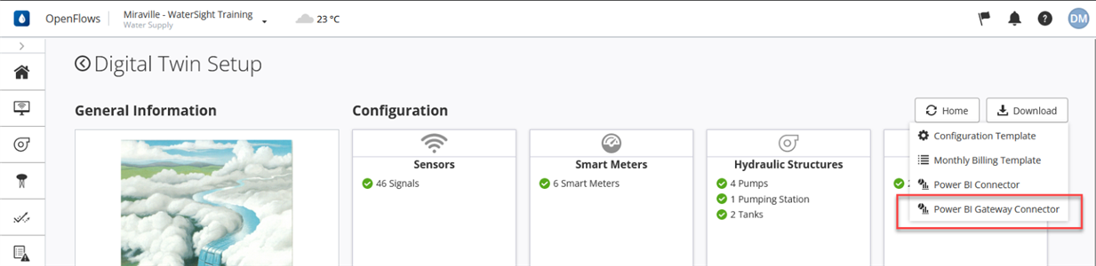

A- Downloading the OpenFlows Gateway Connector
It downloads a file named “OpenFlowsConnector_Gateway.mez”
The user that runs the service should have read/write permission access to this folder.

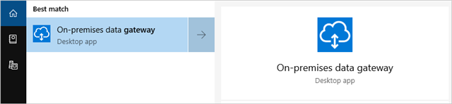

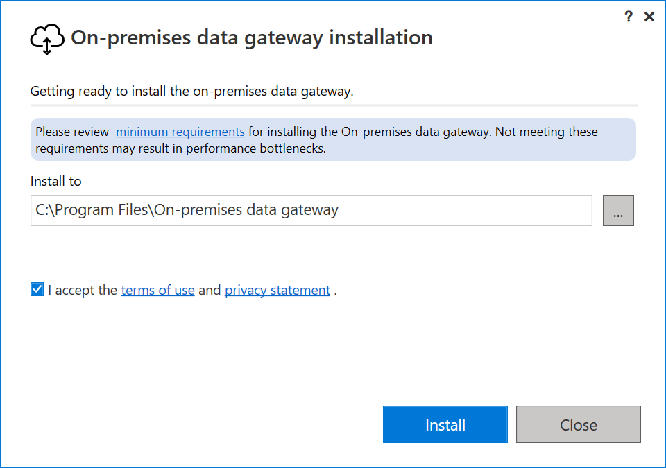

B - Installation of the Gateway application
Before installing the Gateway application, move the OpenFlows Gateway Connector to a separated folder like “Documents/PowerBI_Connectors”. This folder will be referenced during the configuration of the application.

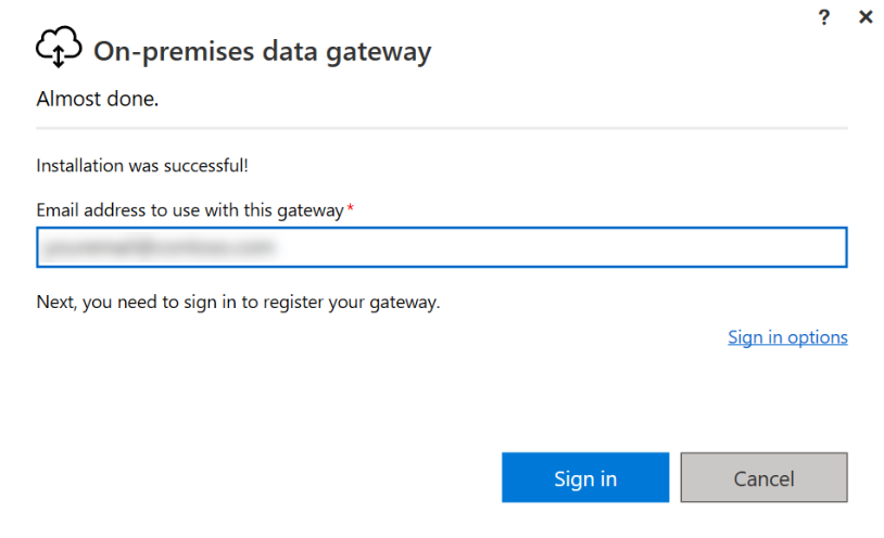

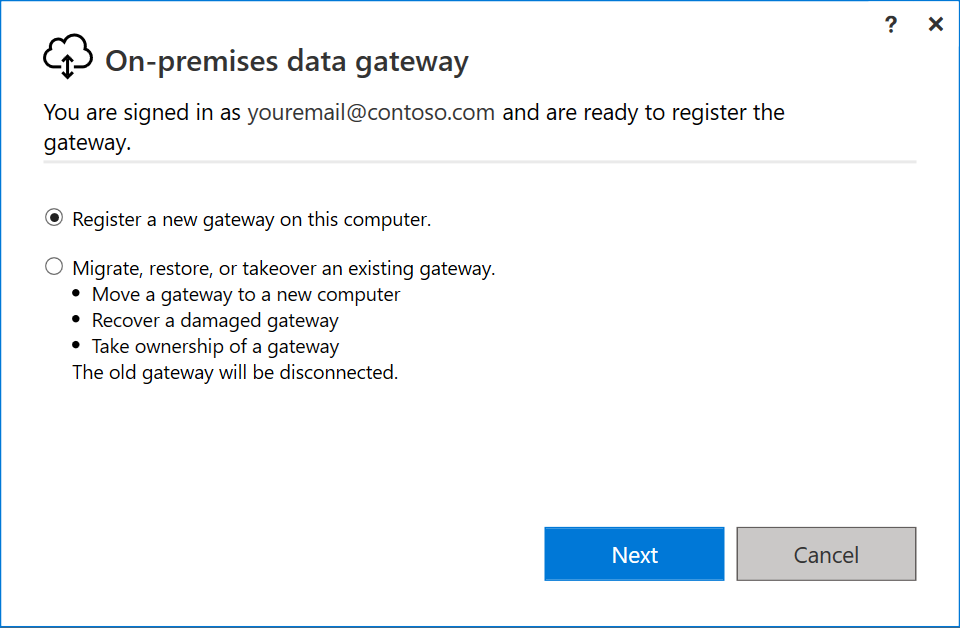

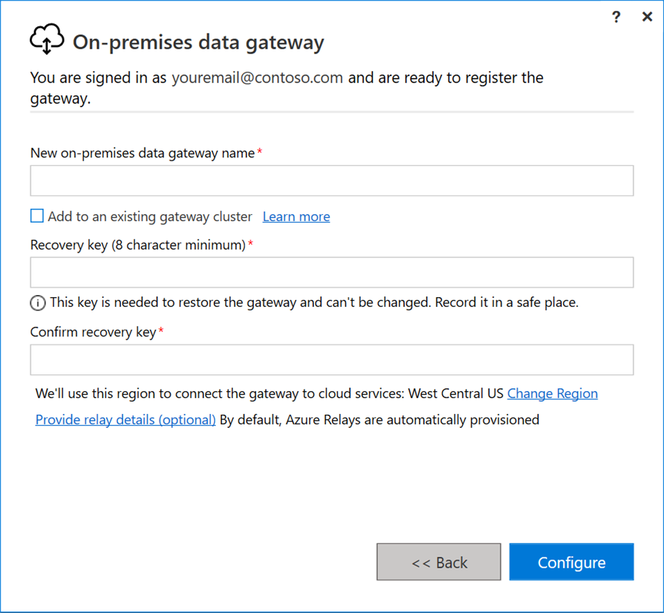

  1. Enter a Name for the Gateway service
  1. Create a recovery key (save it in a text file for cases that you need to reinstall the gateway service).
  1. Click in Configure

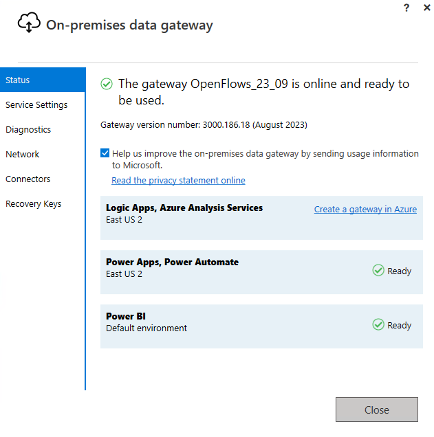

When done it opens the On-premises data gateway application:
This application also installs a Windows Service named “On-Premises data gateway service, that is configured to Automatic restart after computer restart, and it run using a Service account named “PBIEgwService”.

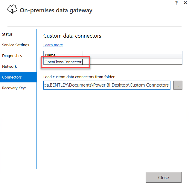

C - Configuring the Gateway Connector Service
This concludes the installation of the Power BI’s On Premises Data Gateway service.

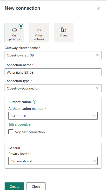

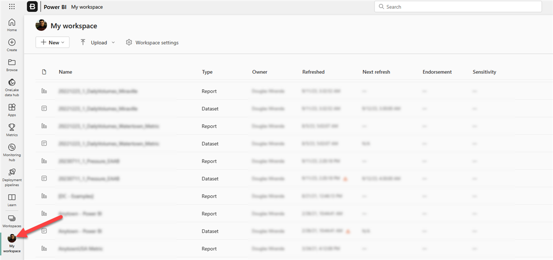

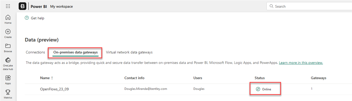

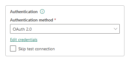

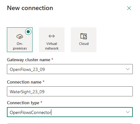

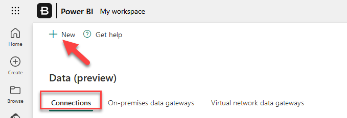

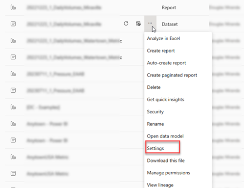

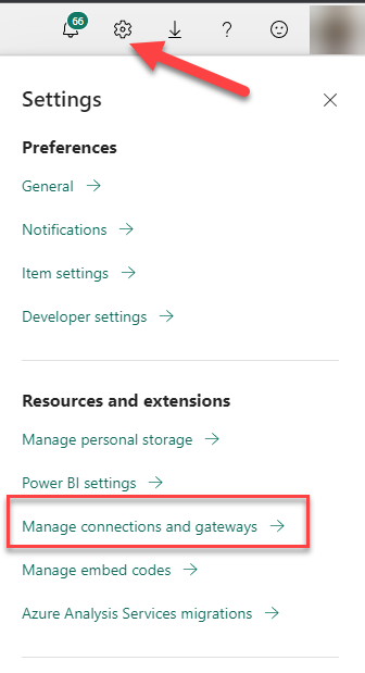

D - Creating a Connection in the Power BI Workspace

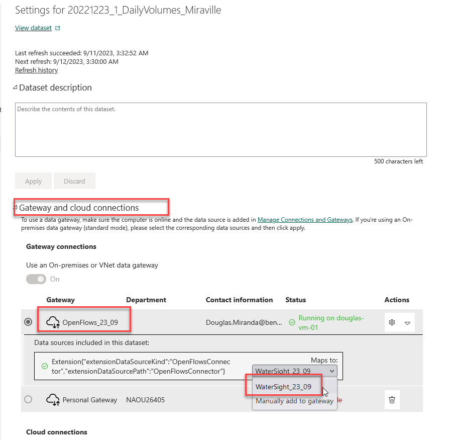

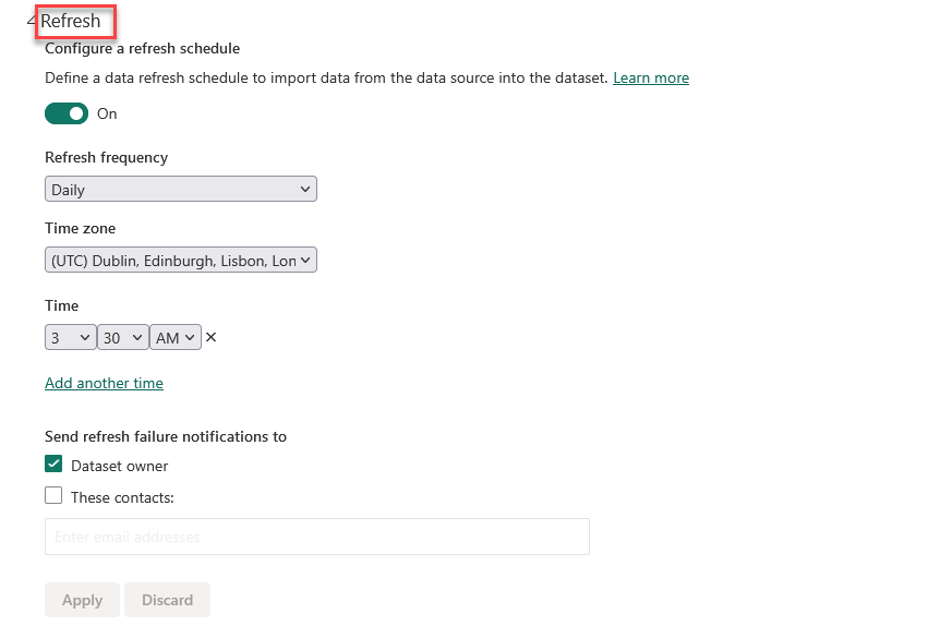

E - Configuring the Automatic Refresh of a Power BI Report

After the steps above are done, the reports should be ready to be automatically updated at a given user defined frequency.
However it is important to highlight that the gateway authentication has the validation of one month, and after that it is required to renew it. To do this it is necessary to create a new connection again each month - described in section D - and associate the new connection just created with each semantic model - described in section E.
