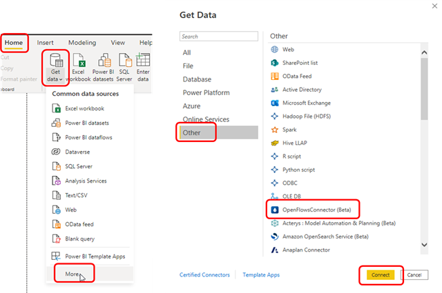

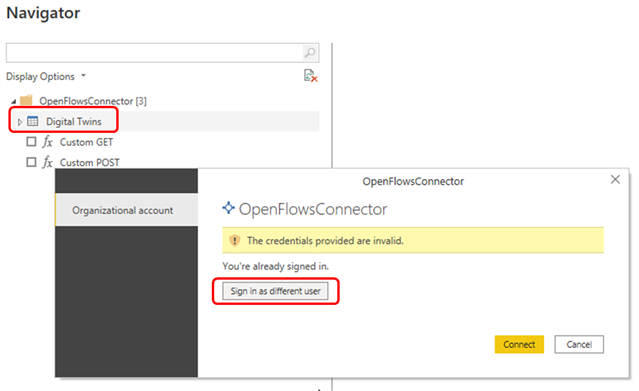

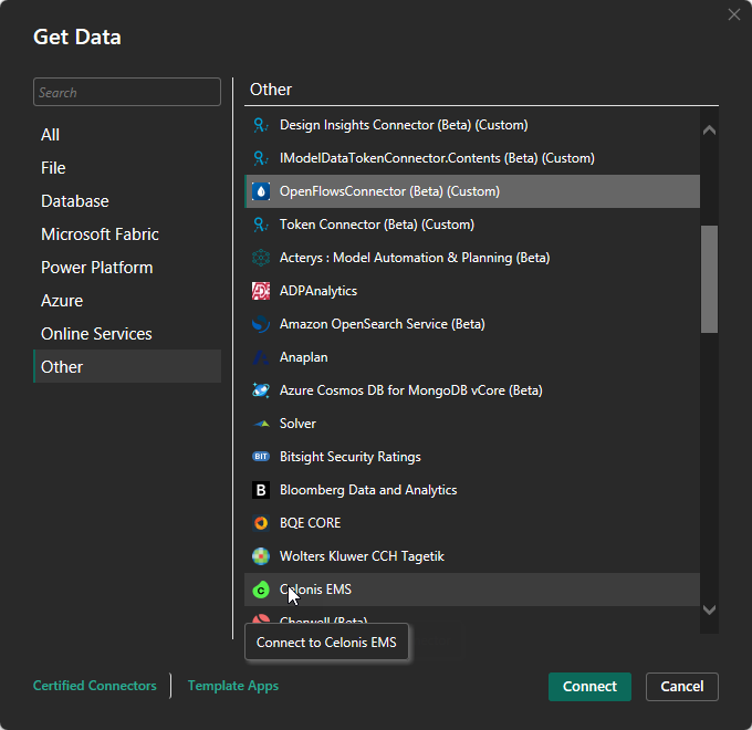

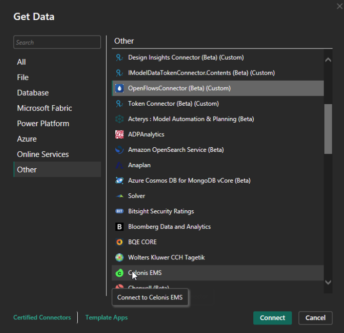

1. Download PowerBI Conector
WaterSight's Power BI Connector must be in the right place for Power BI to recognize and make it available in the desktop application. If the Power BI Connector is not downloaded, please download it. If the downloaded content is a zip file, extract it. Please make sure the file extension of the connector file is ".mez".

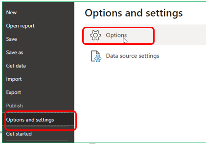

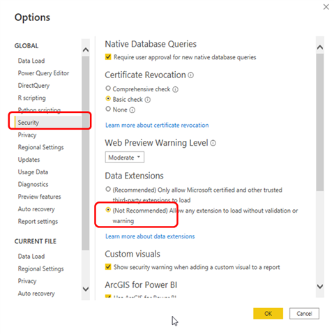

The Power BI desktop, by default, does not allow loading custom connectors. Follow the steps below to enable loading custom connectors.

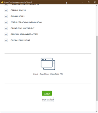

Follow the steps below to load the Power BI connector that was downloaded from WaterSight. The default location for the custom Power BI connector is "C:\Users\<UserName> \Documents\Power BI Desktop\Custom Connectors\".
Make sure under the Get Data dialog, Other > OpenFlowsConnector  (Beta) is visible

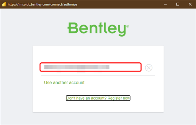

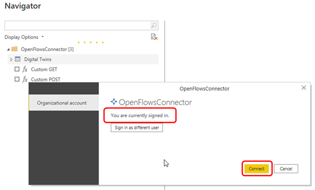

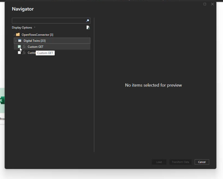

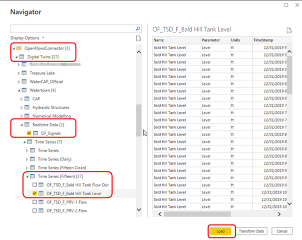

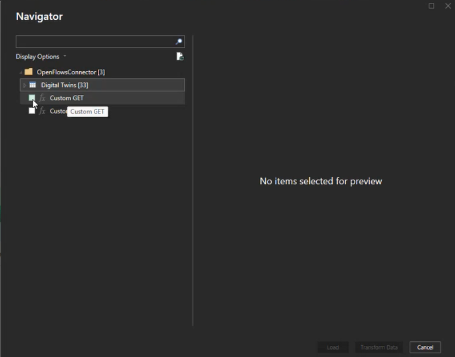

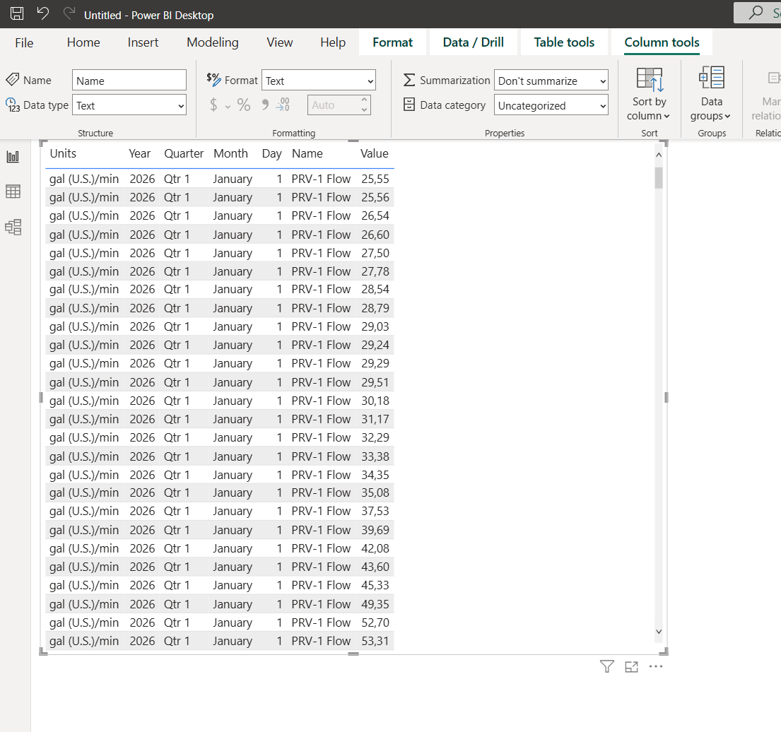

2. Pull data from WaterSight
After clicking Connect on the Get Data dialog, a Navigator dialog is loaded.

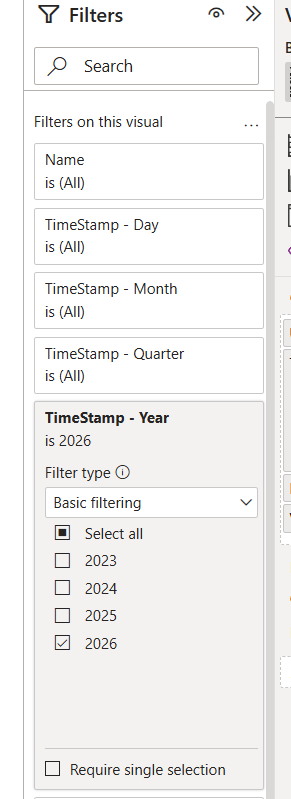

2.1. Predefined Tables (example)
The OpenFlows connector comes already with predefined tables and data that can be easily used to create the PowerBI reports:
Example - load 15 minutes data for 2026

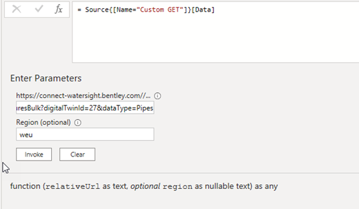

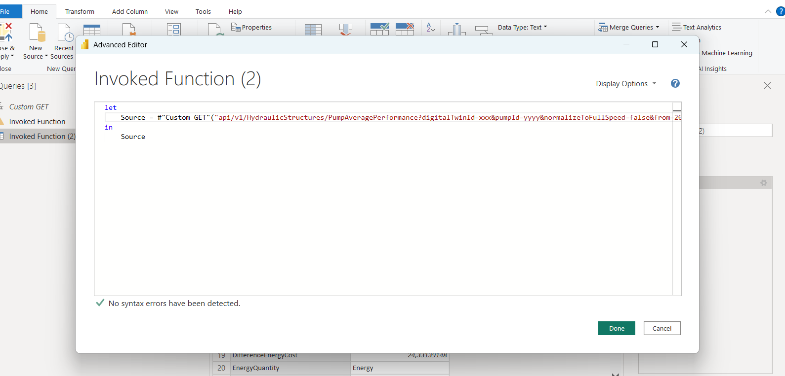

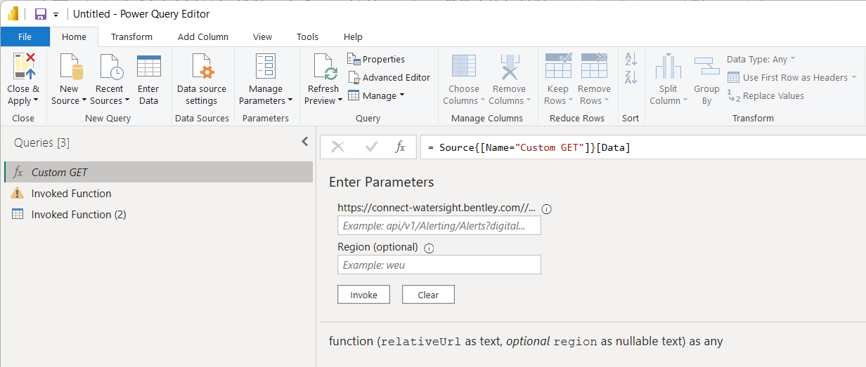

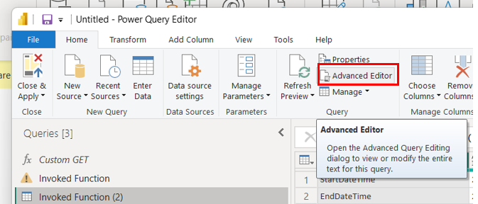

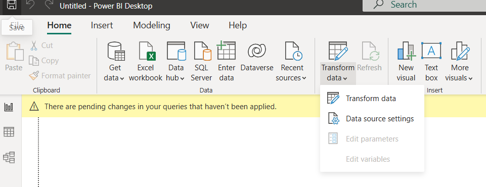

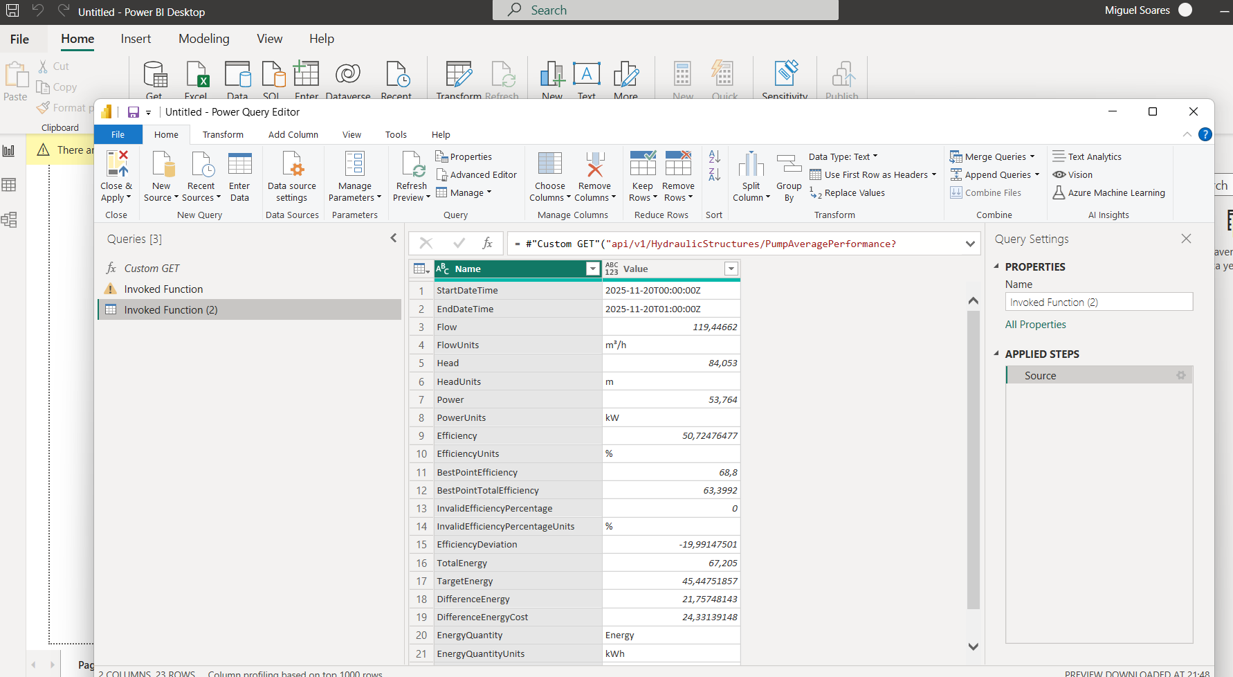

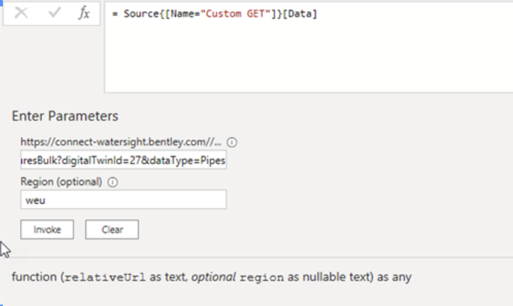

2.2. Customized Tables (Custom Get)
The OpenFlows connector comes already with predefined tables and data (as mentioned above) however not all the data that is in WaterSight is listed there.
The user has the ability to connect to any specific data that exists in WaterSight and build reports from that, even if not listed in the predefined tables. To do this:
The video below explains how to get the different endpoints from WaterSight to use in the Custom Get function:
For more information about the available endpoints or if you want to receive some examples of PowerBI Reports to better understand how they can be created, reach to your Bentley point of contact.
The article below contains another detailed example on how to use the Custom Get function to pull GIS data from WaterSight into PowerBI:
Pull GIS data from WaterSight to PowerBI

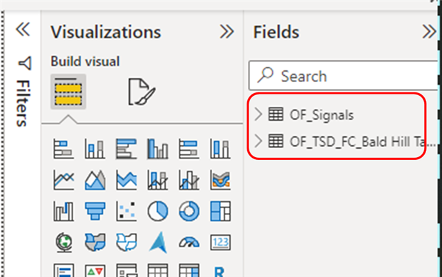

3. Building Reports

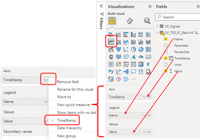

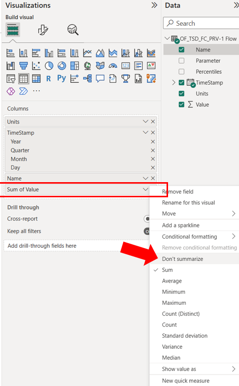

Once the data are loaded, they appear as a table under Fields panel. Depending on the Digital Twin connected, the name of the tables may differ.

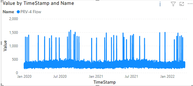

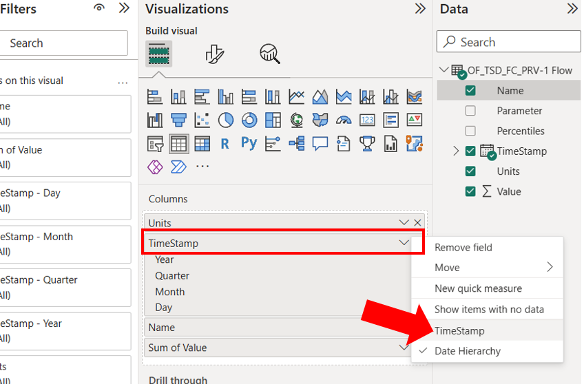

Create Time Series Chart

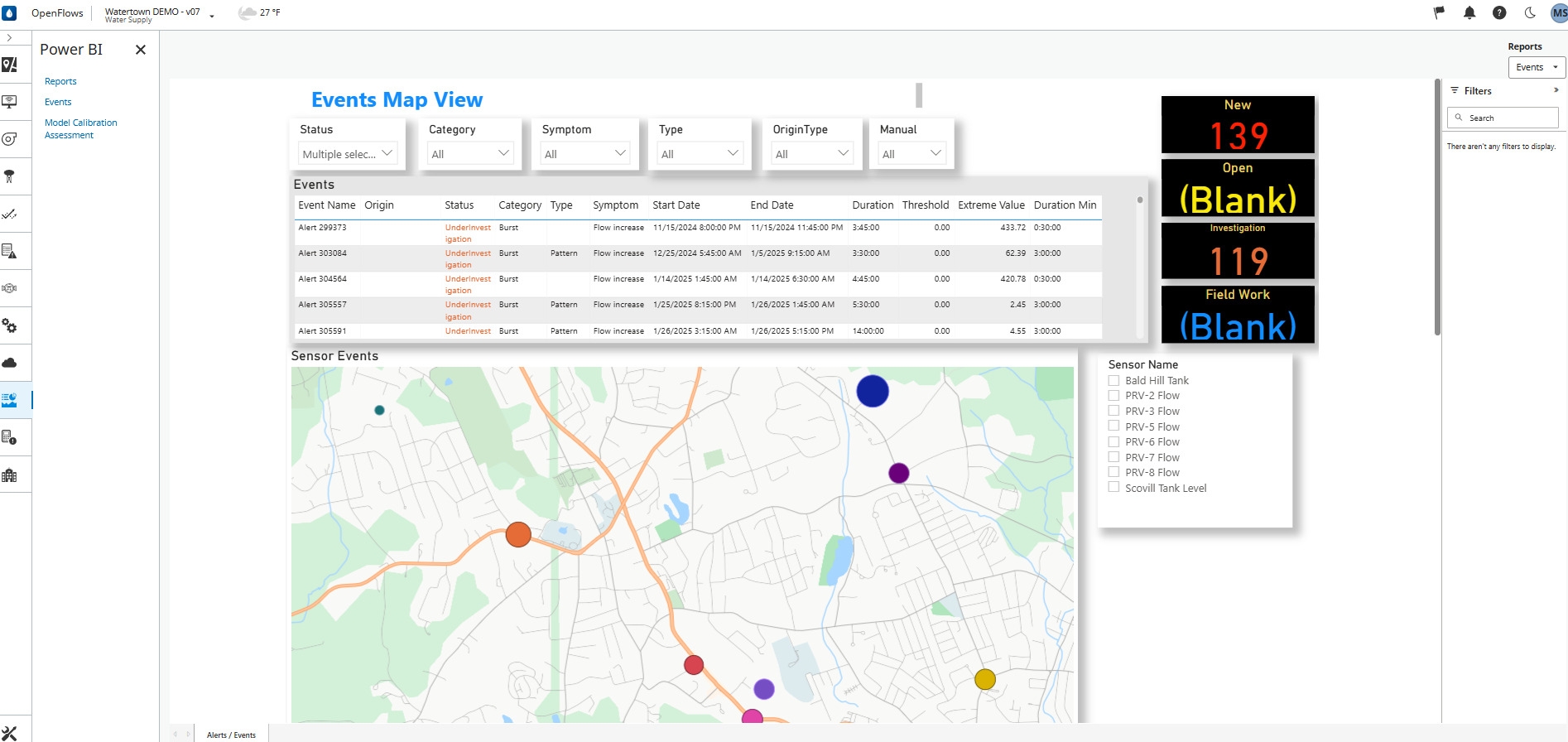

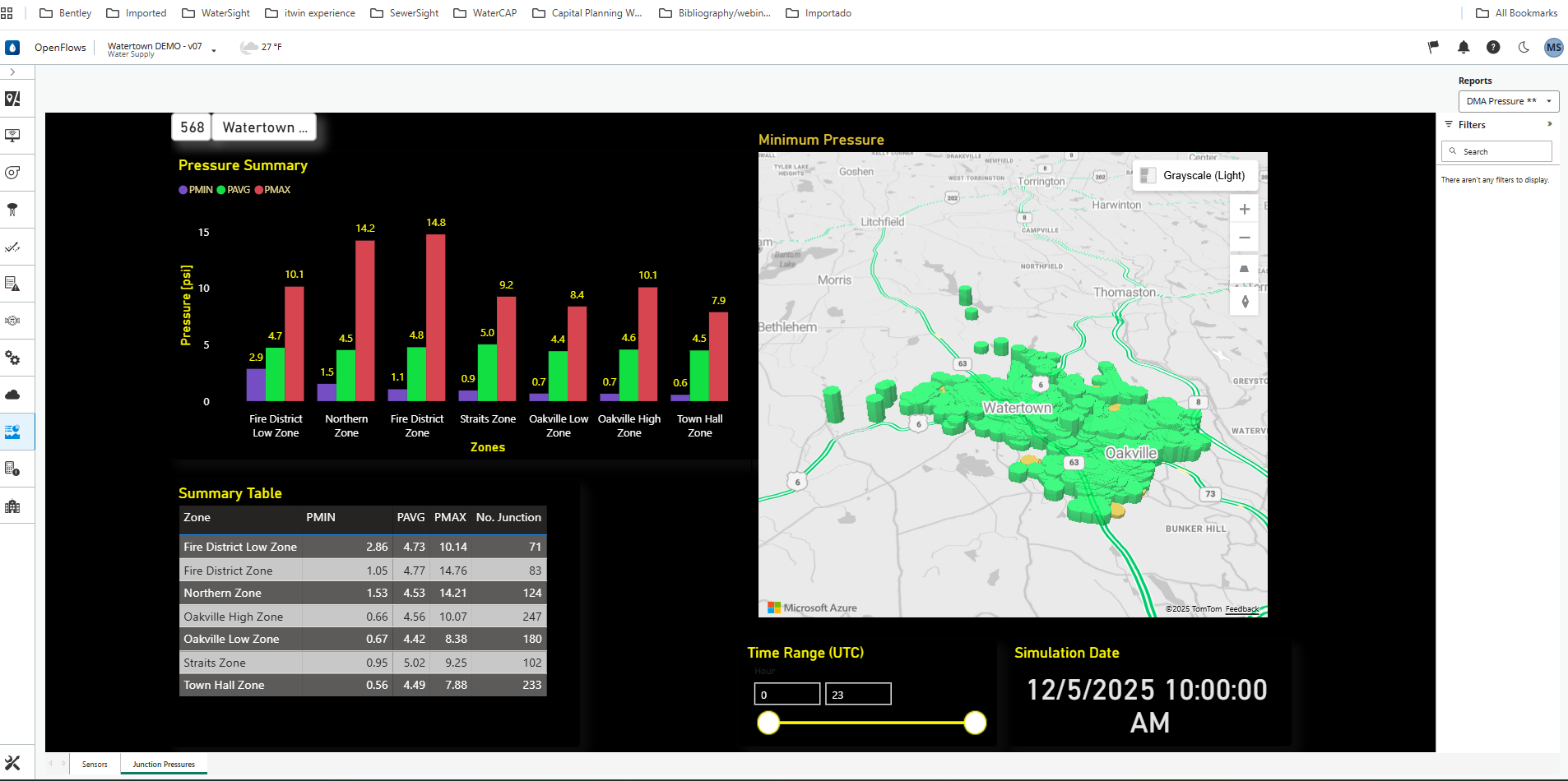

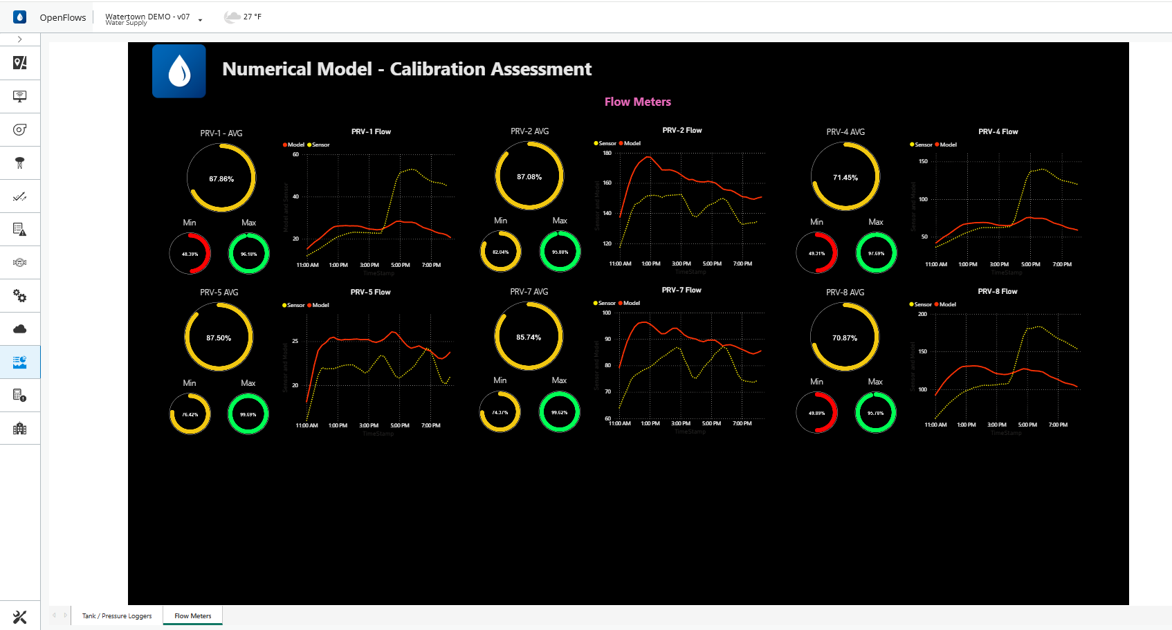

Creating other charts and map visualizations
With PowerBI the user can built its own Indicators (KPI) and its own visuals that include any types of charts (pie-charts, bar charts, etc), graphs and map visualizations. In figure below you can see some examples of reports built based on data that exists in WaterSight and using PowerBI.

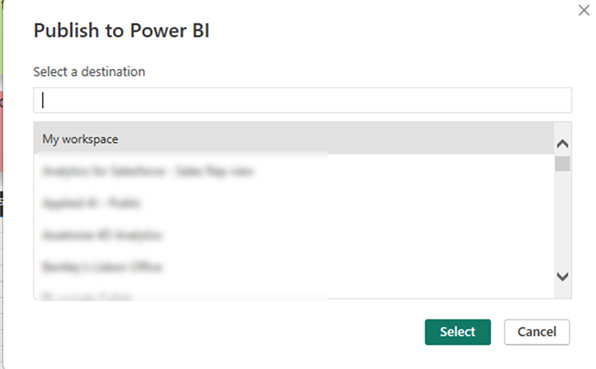

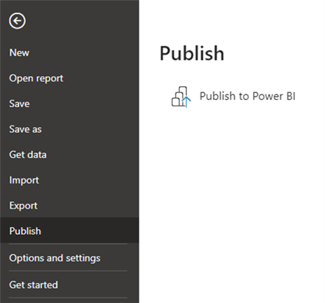

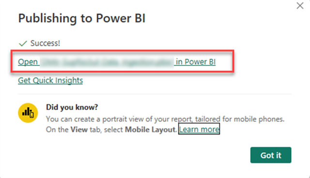

4. Publishing Reports into PowerBI Web
After concluding the construction of the Dashboard, in order to make the report available in WaterSight it's necessary to Publish the dashboard to Power BI's web capacity of your company.

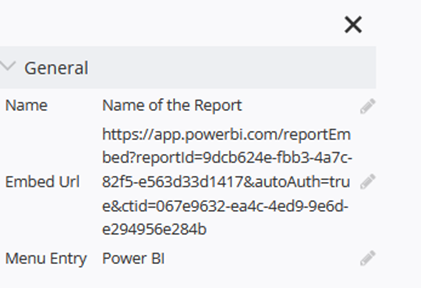

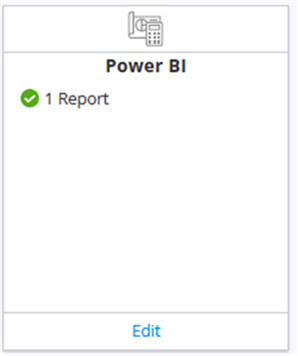

5. Publishing Reports from PowerBi Web into WaterSight
To access Power BI reports, user will use the Power BI credentials and not WaterSight's. And the creator of the report should give access permission to users thru Power BI's tools. For more information about Power BI licensing and access control please consult Power BI's documentation.

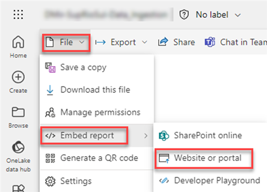

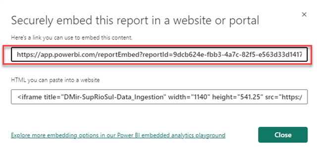

7. Publishing PowerBI Reports into other aplications
Once the PowerBI reports are published into PowerBI web, those should also be consumable by other applications by using the URL generated from the "Embed Report" function.
