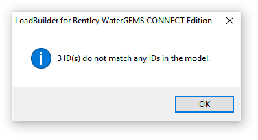

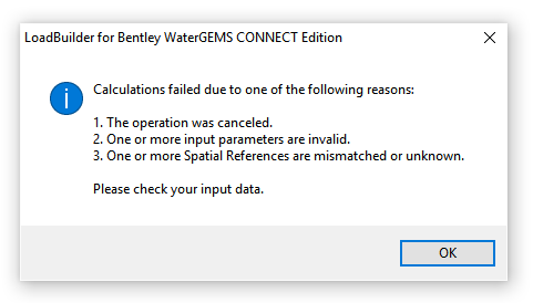

When running LoadBuilder the following errors appear.
"# ID(s) do not match any IDs in the model."
"Calculations failed due to…"
These dialogs could be appearing for a couple of reasons.
Scenario 1: Invalid or deleted elements in a Selection Set
In the Standalone version, a selection set can be selected when picking the "layers" in LoadBuilder. These selection set(s) are "selection based", which means it was created from a group of selected elements. If one or more of the elements have been deleted since creating the selection set then LoadBuilder will consider them missing and won't continue.
