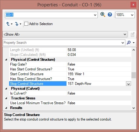

In SewerGEMS, CivilStorm, and SewerCAD, you can attach a control structure on a conduit as either a Start or Stop Control Structure, referring to the end of the pipe at which the control structure is located. The latest version of SewerGEMS and CivilStorm supports both start and stop control structures for both the Implicit dynamic and the Explicit (SWMM) dynamic solvers. Control structures can also be placed on Channels.
A conduit control structure can also be used for example to model the hydraulics of a Parshall flume.
Conduit and channel control structures are treated as in-line (in series), so if you need to model a lateral/side control structure which diverts water to another location (lateral to the conduit), you will need to place a start control structure on a lateral conduit as seen in the figure below.
Weir start control structure on a lateral pipe for flow diversion:
A control structure can also have a flap gate which allows flow to travel in only one direction. Hydraulically these controls are treated as internal boundaries where the empirical weir or orifice equations are used. These equations will replace the momentum equations in the Saint Venant equations (for the Implicit solver). The continuity equation is simply the flow is the same between the upstream face and the downstream face of the internal boundary (control structure).

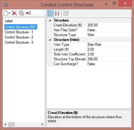

Weir Control Structure
Weirs are classified by their flow-diversion purpose as either a side weir or a transverse weir. Side weirs or overflow weirs are used to divert extra high flows to overflow waterways. Typically, a side weir is a weir parallel to the main sewer pipe and with a high enough crest (invert) elevation to prevent any discharge of dry-weather flow, but it is also low and long enough to discharge required excess of wet weather flow. Transverse weirs or inline weirs are typically placed directly across the sewer pipe, perpendicular to the sewer flow and act like a small dam, to direct the low flow, usually dry weather flow, to diversion pipe such as dry weather flow interceptor sewer pipe. Weirs are also classified by their cross-section shapes, such as rectangular, V-notch, trapezoidal, and irregular.
In Line Weir -
Where B = weir length, h = effective head, C = weir coefficient, n = number of end contractions
Side Weir - Q = C L h5/3
Where the units on the weir discharge coefficient are ft1/3/s when flow is in cfs, and L and h are in ft.
See more here: Modeling a side weir conduit control structure

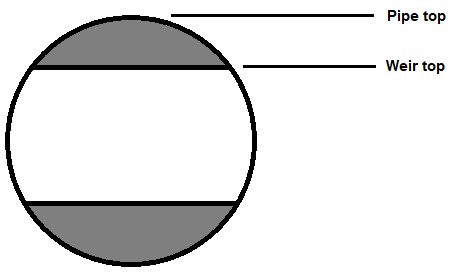

In the properties for the weir control structure, the Crest Elevation denotes the bottom (invert) of the weir. The Structure Top Elevation is the top of the weir. In many cases, the Structure Top Elevation will be the crown of the conduit, though it is possible for the Structure Top Elevation to be below this, such as in the diagram below.
If the conduit is running full or the depth is higher that the Structure Top Elevation, the flow through the weir will be treated as orifice flow.
