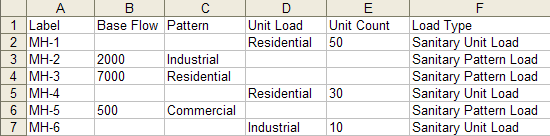

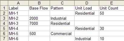

If your loading data is in an Excel spreadsheet and you have a field that contains labels that match your SewerCAD model's manhole labels, you can use the Modelbuilder feature to import them. For example:

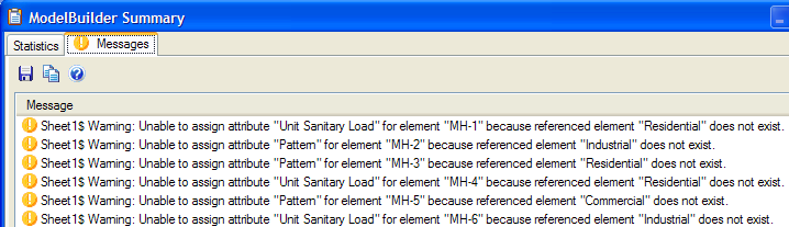

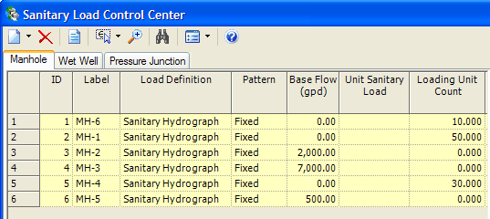

If you attempt to import the loading information using Modelbuilder, you may end up with the following unexpected result:
As you can see, these pattern-based loads and Unit loads did not import correctly. The correct patterns/unit loads were not assigned and the load has imported as a Sanitary Hydrograph load type. Because of this, the base flow and unit count are ignored. There are two reasons why this has happened:
  1. The patterns must be defined ahead of time, under Components > Patterns. ModelBuilder will not automatically create patterns; it is simply linking the data in your source file (the pattern labels) with the pattern field. If the patterns are not defined yet, then a matching selection will not be found and you will get the above warning. The same applies to the unit load label. Your unit load (for example, 'Residential', representing 100 gpd per person) must also be defined ahead of time before the unit count can be imported into your manholes.
  2. Since a sanitary load can be a Hydrograph, Pattern-based, or Unit load, the user must specify which of these load types is being imported, in addition to the information already in the spreadsheet. Without specifying this Load Definition, the program will import the load as the default type, which is Sanitary Hydrograph.

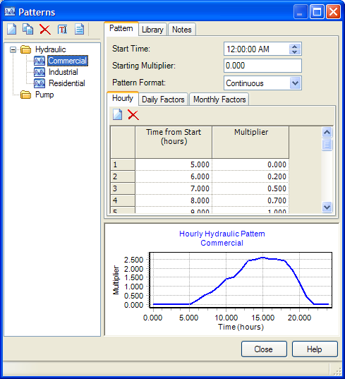

First you must define your patterns (if importing any pattern-based loads). Go to Components > Patterns. Create a new hydraulic pattern and enter the starting multiplier along with the table of time and multiplier as shown below.
To import patterns using ModelBuilder , have a look this support solution.
Ensure that the labels for your patterns match the ones in the source file that contains the loading data.

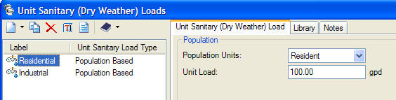

If you need to import any unit loads, you will then need to define them, under Components > Unit sanitary loads.
Next, open your source data file and add a new field called "Load Type". For each row of data, you will need to type in the corresponding load type. For sanitary loads, they must be entered exactly as follows (spelling and capitalization):
            Sanitary Unit Load
            Sanitary Pattern Load
            Sanitary Hydrograph
For manhole Inflow loads, they must match the following:
            Pattern
            Fixed Load
            Hydrograph Load

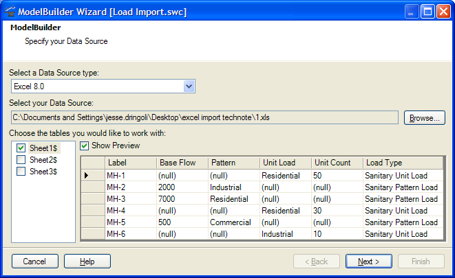

Your source file may look like this:
Note: Composite loads (more than one load per manhole) will also work. Meaning, you can have multiple rows with "MH-1", but with different loads. For example, MH-1 might have both a pattern load and a unit load, or perhaps it might have two different types of unit loads.
Next, start a new ModelBuilder run by going to Tools > ModelBuilder and clicking the white paper icon. Select your Data Source type and then the file itself. Click the check box next to only layer or worksheet that contains the data. You can click "Show Preview" to check the data in the layer selected:

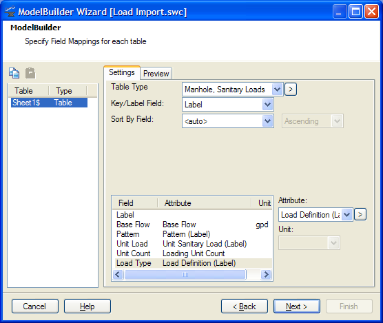

Click 'Next' to display the field mappings. First, click on the layer on the left side and select "Manhole, Sanitary Loads" as the "Table" type.
Note that if you need to bring in one of the Inflow load types, you will need to select "Manhole, Inflow (Wet) Collection" as the table type. If you need to bring in a "Fixed Load" inflow load type, your source file will only need to include a column for the flow and for the load type ('Fixed Load'.)
For the "Key/Label field", select the column name that contains the manhole labels. On the bottom of this window, each of your fields will be displayed. You will need to click each one and link them to the corresponding SewerCAD field. Note: If the label in the spreadsheet does not match the label in the model, a new element may be created. Be sure that the labels in the source file match the model labels.
'Base Flow' - the base flow field associated with a pattern-based load (Make sure you check your units!)
'Index' - This is used for hydrograph loads (beyond the scope of this TechNote)
'Load Definition (ID)' - the internal ID number of the load type. This does not need to be used.
'Load Definition (Label)' - the field containing the type of sanitary load you are importing (described above)
'Loading Unit Count' - the count field associated with a unit load
'Pattern (ID)' - the internal ID number of a pattern. This does not need to be used.
'Pattern (Label) - the field containing the name of the pattern associated with a pattern-based load
'Unit Sanitary Load (ID)' - the internal ID number of the unit load. This does not need to be used.
'Unit Sanitary Load (Label)' - the field containing the name of the unit load for a unit sanitary load.
Note: not every one of these fields will necessarily be used. For example, if you are only importing pattern loads, you would only need to link the "Pattern (Label)" and "Base Flow" fields.
Once completed, your window will look similar to this:

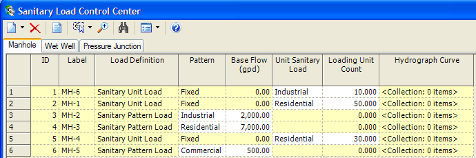

Click Next and choose to build the model. Check the "Messages" tab for any warnings and then close Modelbuilder. Open the Sanitary Load Control Center. The loads should have been imported correctly.
