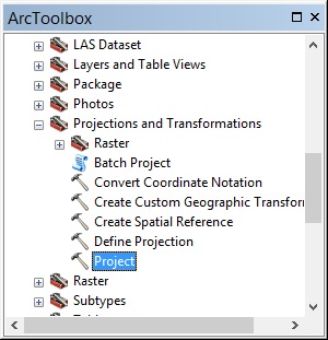

If you are on an older version and cannot upgrade, you will need to reproject the data into a projected coordinate system first before using it in ModelBuilder or LoadBuilder. This will assign measurable linear units to the file after which ModelBuilder and LoadBuilder should be able to properly recognize the spatial locations of the elements. If you have access to ArcGIS, this is done using the Project tool in ArcToolbox. From ArcToolbox, go to Data Management Tools > Projections and Transformations > Project.

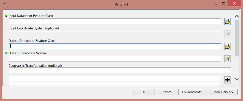

Next, you will get the dialog below:
Enter the shapefile you need to reproject under Input Dataset or Feature Class. A name will be automatically generated for the Output Dataset. Next, click the Spatial Reference Properties button next the Output Coordinate System field to send the coordinate system you wish to use.
