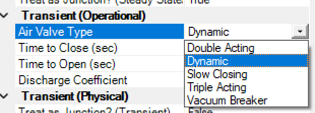

How can I model a "dynamic" air valve such as A.R.I. D-070, which does not start closing until all air has been released?
A "dynamic" air valve type typically refers to an air valve that does not start closing until the air pocket is fully expelled, so some water discharge occurs before full closure.
In HAMMER version 2023 (23.00.00.19) and higher, a "Dynamic" air valve is available as an Air Valve Type.
Dynamic air valves open and close in a controlled manner allowing water flow after all air is out of the pipeline. A dynamic air valve starts opening when pressure at valve location drops below atmospheric pressure allowing intake of air. Air is let out of the valve when pressure at air valve goes above atmospheric pressure. A dynamic air valve does not close after all air is out of pipeline, continues to let water out of pipeline thus preventing air slam conditions. A dynamic air valve starts closing after all air is out of pipelines and closes in a few seconds.
Time to Close - the time taken to fully close (closure is linear with respect to area), starting at the time the air volume drops to zero.
Time to Open - the time to open the air valve from the fully closed position to the fully open position. A dynamic air valve starts opening when pressure at valve location drops below atmospheric pressure.
Discharge Coefficient - air valve orifice water outflow unitless discharge coefficient. Typical values are around 0.6. Not to be confused with the "CV" discharge coefficient used elsewhere, which has units.

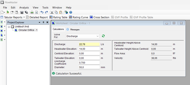

First, in order to establish the pressure vs. outflow relationship at the D2A element, you can use the standard orifice equation. For example use a known diameter, hydraulic grade/pressure head and Discharge Coefficient data to calculate the corresponding Discharge value to input into the D2A element. For this, the headwater elevation can be based on a quick steady state run to see a typical pressure head (with the D2A set to initially closed) and then you would enter this headwater (expressed as pressure head above the D2A elevation) as the "pressure drop (typical)" and the calculated flow as the "flow (typical)" into the D2A properties. As an example, you could use Bentley FlowMaster to perform the calculation as indicated in the figure below, for a 50 mm diameter air valve opening, with a typical pressure of 14 m:

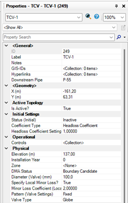

For the TCV the "Status (Initial)" can be set to "Inactive" to model it as fully open, for the initial run where you will first observe the time when the valve should start to close, and set the coefficient type appropriately along with the fully open discharge coefficient or "minor loss coefficient" to establish the fully open characteristics. See more on TCV valve modeling here: Modeling Reference - Valve Closure

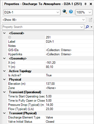

For the D2A, set the "Discharge Element Type" to "Valve" and initial status to closed (to model the air valve initially closed.) Initially you can enter an arbitrary Time to Start and Time to Fully Open value of 5 seconds (these times will be changed later based on the time the pressure drops to zero), these settings can be observed in the following images:

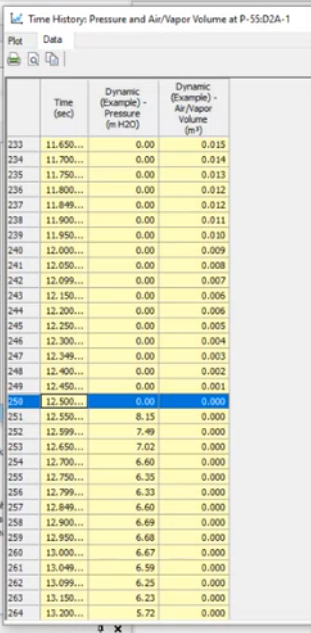

Next you will observe the time at which the pressure drops to zero and the air valve would open and admit air into the system. To do this, you must add the elements (TCV and D2A) as report points in Calculation Option > Base Calculation Options > Report Points Collection, then create a profile from the water source to the D2A element to be able to visualize the profile results. Next, compute the transient simulation and analyze the profile created in the Transient Results Viewer tool and also the Time History of our D2A element, to find the time when the pressure drops to zero. This will be the new value for Time to Start Operating in the D2A and for Time to Fully Open you can enter 0.10 seconds for example, to make it instantaneous (otherwise enter the time it takes for your DAV to fully open when the pressure reaches zero.)
You can then compute the model again and perform the same analysis as the last paragraph but this time using Air/Vapor Volume indicators at the endpoint adjacent to the D2A, to be able to find the time when the air pocket is fully expelled and reaches a volume of zero. This will indicate the time when the DAV valve should start closing:

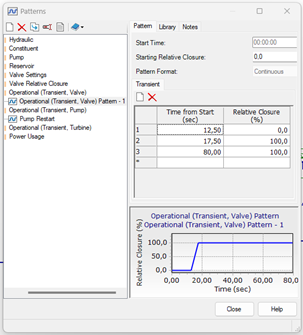

In the above example the air is fully expelled at 12.50 seconds. To model the valve starting to close at this time, go to the TCV properties > Operating Rule > Edit and create a new "Operational (Transient, Valve)" pattern and configure as follows:
This pattern models the DAV valve starting in the fully open position, then beginning to close at 12.5 seconds (the time when we observed the air pocket being fully expelled.) Between 12.5 sec and 17.5 seconds, the valve is closing (a 3 second closure is assumed) and water will be discharging out of the DAV (D2A element), and the DAV will be fully closed at 17.5 seconds.
