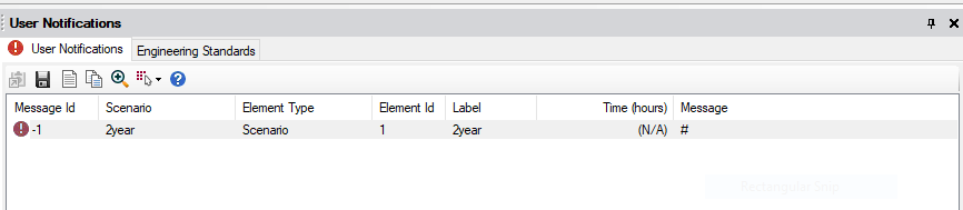

Calculation fails with Hashtag or Pound sign (#) in User Notifications
Product(s):SewerGEMS, CivilStorm, StormCAD, SewerCAD
Version(s):10.02.XX.XX and higher
Area:Licensing
When attempting to compute a model, it fails with a red user notification that only has the hashtag (pound #) sign in the "Message" column:
This has been known to occur if a valid, commercial or academic license is not properly activated. See past forum discussions:
 RE: Storm cad
 RE: Civilstorm computation
 RE: Please help me solve this problem at SEWER GEMS update 3 When I click compute, this notification always appears to me, and I cannot get results.
First, check under File > Help > About. A valid account name, account ID, license type and license status should be showing here for valid, commercial or academic license. If not, close the program and follow the process (and troubleshooting steps, if needed) in the following article: Licensing OpenFlows products - Subscription Entitlement Service
Notably ensure that a feature level is selected in the Feature Level Selector and that the Bentley Licensing Tool shows that the product is activated.
