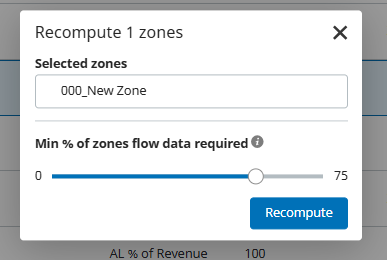

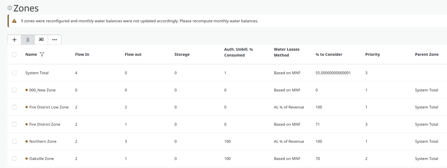

Recompute Monthly Balance data
When zones are changed or updated, and if any of the parameters that affects the monthly water balance calculation are changed, then those zones will be marked with a orange dot and an informative message will be displayed for the user.
Whenever zone changes are done, the past monthly water balances are not updated accordingly and only future water balances will consider the new definitions. Only in case the user wants to override or update the historical monthly water balances according with the new settings it is required to click on the zone recompute button, which can be accessible through the (...) button located on top of the table. It is possible to recompute all or select the zones for which you want to trigger the monthly water balance calculation.
Example
Whenever some zones parameters are edited in the zones admin table below, automatically the new water balance components for the future months will also change based on the new assumptions. For example:
If the user changes the zones parameters in the admin zones table but does NOT click in the recompute button, the zones changes made will only reflect in the update of the water balances calculation for the future months (not affecting past months). If the user changes the zones parameters in the admin zones table and DOES click in the recompute button, then all the water balance components will be recalculated, including for all the past months.
The user can also use the recompute option to change the minimum percentage of zones flow data required to calculate zone system monthly input volume AND/OR (default value is 75%). If data is failing more than 25% of the month for each zone, by default system input volume is not calculated, but the user can override this default, more information below.
Minimum percentage of zones flow data required to calculate zone system monthly input volume
Zone monthly system input volumes (that will be displayed in the water balance charts) are automatically calculated based on the final zone flow time series, that is a balance between all inflows, outflows and storage sensors into the zone. By default the solution assumes that for each month at least 75% of the time zone flow data needs to exist (this means that in a 30 days period, at least 22 days need to have zone data) otherwise system input volume will not be calculated. However, when clicking in the recompute data, a pop-up dialog will appear and the user can change the 75% default that is assumed, by moving the range slider to the left or to the right.
If the user for example defines a value of 50% this means that system input volume for each zone will be calculated until a maximum of 50% of missing data (for each month). For the period with data, the real zone flow time series will be used for calculate the system input volume. For the other 50% period without data, the software will estimate the monthly volume by assuming, for the missing period, the zone pattern (P50th percentile of the zones flow, considering a historical period of last 1 month).

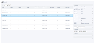

Zones Configuration table
Column Description
Name*
Required field. Zone display name that will appear in the software. This name should be the same used in the shapefiles uploaded in the GIS configuration page.
Population served
Population served by each zone
Number of Customers
Number of customer supplied by each zone
Number of Connections
Number of service connections for each zone
Water Losses Method
Method to use for calculating water losses. The following options are available:
  • Real losses calculation based on the zone minimum night flow (MNF)
  • Apparent losses (AL) calculation as an user defined percentage of the total zone input volume
  • Apparent losses  (AL) calculation as an user defined percentage of the total zone revenue volume
  • Apparent losses (AL) calculation as an user defined percentage of the total zone water losses volumes
For more information please click here. The default option is the real losses calculation based on the zone minimum night flow.
% to consider
Percentage that is considered for each water loss method previously defined:
Method % to consider
Based on MNF Minimum Night Flow consumed (% of total MNF). Corresponds to the percentage of the minimum night flow that is due to consumption. If empty, a zero value will be assumed
AL % of Input Apparent Losses (% of zone system input volume)
AL % of Revenue Apparent Losses (% of zone revenue water)
AL % of Losses Apparent Losses (% of zone water losses)
Auth. Unbill. % Consumed
The user defines a percentage of authorized unbilled consumption based on a percentage related to the billed consumption. This will be used to calculate the associated water balance component. If empty, a zero value will be assumed.
Priority
The priority when displaying in the zone overview. Note that a priority of 0 will prevent the zone to display in the Zone Overview
Parent Zone
If there are smaller zones defined inside bigger zones, the user needs to define which is the parent zone. By default System Total is defined. More information about zones hierarchy below.
Pattern
Pattern group assigned to the zone. Pattern groups can be created the the Administration > Settings > Pattern. If Pattern None is selected, then no patterns will be computed and displayed in the zone graph. Patterns are displayed in the zone graphs as grey bands.
Special periods
Special Periods can be defined by the user in Admin >> Settings page. For those special periods defined, zones patterns can be customized/adjusted by the user. More information about pattern customization here.
Use Gap Filling
Default option is No. A zone corresponds to a balance of one or more flow sensors. In case at least one flow sensor that belongs to zone balance has missing data or gaps, the zone flow will also have missing data or gaps, which can compromise the zone flow monitoring.
If set to yes, than every time one of the sensors fails or every time a meter failure event is registered at the sensor level, the software will automatically estimate the data for the final zone flow for which the sensor contributes to. Estimated data is only displayed at the zone level (and not at the sensor level) and will be represented in the zone graphs with empty circles, allowing the user to continue to have access to zone flows, even if estimated. These zone estimations will then be used in all consequent calculations of water balances and other zone KPI. Please note that the gap filling option only exists at the zone level, this means that even the application estimated the flow in the sensor that fails, in the sensor graph this problem (missing data or gaps) will always be noted so the user can be always aware of the real issues at the sensor level. Please also note that zone events/alerts are never generated based on estimated data. More information here - Zone Gap Filing: Estimating missing or wrong data.
Flow In*
Required field. Number of sensors measuring flow into the zone. To define/edit the inflow sensors, just click in a zone (table row) and then click in the edit button above the table. Below the table will appear the "Flow in" sensors to configure. There must be at least one inflow.
Flow Out
Number of sensors measuring flow out of the zone. To define/edit the outflow sensors, just click in a zone (table row) and then click in the edit button above the table. Below the table will appear the "Flow out" sensors to configure.
Storage
Number of sensors measuring tank levels, inside the zone boundaries. To define/edit the storage sensors, just click in a zone (table row) and then click in the edit button above the table. Below the table will appear the "Storage" sensors to configure. As an important note, the tank levels that should be considered for the zones balance are only those that are inside the zones boundary and serve as storage for the zone - this means that if a zone is supplied by a tank and the inflow sensor is located immediately downstream the tank (and already considered for the zone balance as input), this tank level must NOT be considered.
Tags Tags allow to group zones inside the application, so it is easier to search and find specific zones of interest.
Tags (User defined groups)
It is possible to insert tags (or user defined groups) for each zone by directly clicking in a row in the Zones table, then clicking Edit    and then filling the Tags section below the table.
Once tags are defined, those will be available in the Zones Network Monitoring pages, so that is easier to search and find specific Zones of interest. Below some examples of groups that may be relevant:

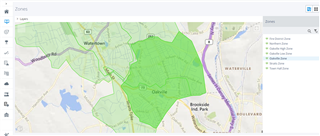

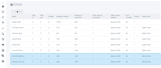

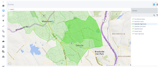

Zones hierarchy

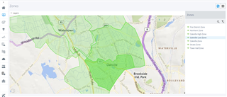

Most utilities manage their systems based on bigger zones (usually called operational zones or distribution systems), being each operational zone or system composed by several smaller zones (usually called DMA). In WaterSight it is possible to consider these two levels of zones hierarchy, but it is also possible to consider three or more levels of hierarchy (for example a town, that is composed by several distribution systems, being each system composed by several DMA). The highest zones in the hierarchy will have System Total as their parent.
Distribution system - Oakville Zone DMA - Oakville Low Zone DMA - Oakville High Zone
In the example above, it is being considered a bigger zone (Oakville Zone) that is divided in two smaller zones (Oakville Low Zone and Oakville High Zone). In this case, in the zones configuration table, both Oakville Low Zone and Oakville High Zone should have Oakville Zone as their parent (example below).
