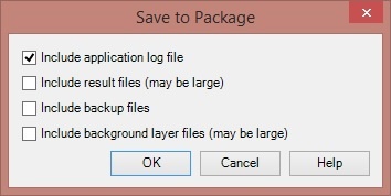

Save to Package
In recent versions (10.01.XX.XX and higher), the Save to Package feature can be used as a quick way to compress all necessary files into a single ZIP file. This will make it simple for cases where you need to supply model files to a colleague, to a reviewer, or to technical support. By default, the models files (.wtg and .wtg.sqlite files), dwh, dwh.profiles are included in the package file, but you can also opt to include log, result, backup, background files as well. You can access this by going to File > Save as Package.
Note: this feature is not currently available for PondPack, CulvertMaster or FlowMaster.
