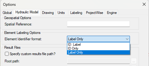

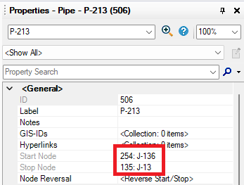

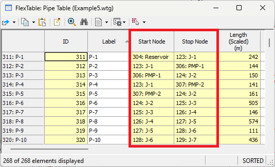

The labels of my elements (as seen in the Properties, Flextables, etc) show an ID number in front of them. This includes other fields like the start/stop node label field.
This element ID (unique to the element, while the label may not be) will be shown if your Element Identifier Format setting is set to "ID: Label". TO change this so that you only see the element label, this can be changed to "Label Only", under File > Options > Hydraulic Model > Element Labeling Options (see below).
