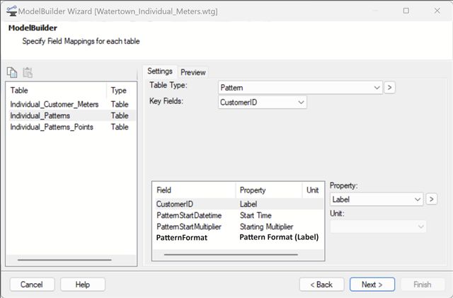

4) In ModelBuilder, create a connection to the AMI database and configure the import tables for Customer Meters, Patterns, and Pattern Points. See below for details.
ModelBuilder Setup
Assuming the data is in a SQL Server database, set the Data Source type to OLE DB, and press Browse to establish a connection. In the Provider tab, select SQL Server Native Client. In the Connection tab, enter the server name, login credentials, and select the database.
Once the connection is established, select the three tables matching the chosen strategy (Individual or Aggregated).
Skip through pages using Next until arriving at the table definition page. Configure the three tables as shown below.
Customer_Meters:
Patterns:
The Patterns Table Type can be found under Components.
Patterns_Points
The Pattern Curve table type can be found under Collections
