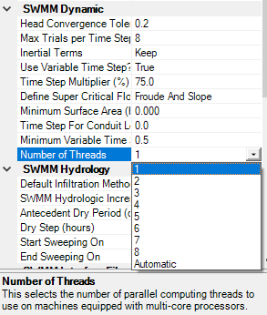

With the Explicit solver, you can also take advantage of multi-threading available in modern CPUs, most of which have multiple cores available for parallel processing. In the calculation options, set the "Number of Threads" option to 4 if it is not already set, or try "automatic".
