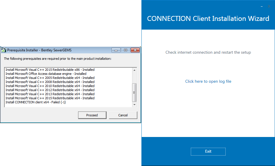

How can an OpenFlows product be installed and licensed on a computer without an internet connection, such as on a computer with access to a SCADA system that has an "air gap"? (no internet)
When installing an OpenFlows application (version 10.02.XX.XX and higher) without internet access the installation fails and a screen similar to the following appears:
"Check internet connection and restart the setup"
Or, you may encounter the error message: Setup Failed. 0x80070002 - The system cannot find the file specified

For older versions, the product installation executable (.EXE) includes the prerequisites such as Visual C++ runtime redistributables and CONNECTION Client, so no internet connection should be required for those.
Note: the CONNECTION Client (which manages Bentley licenses and other services) requires a certain version of the Microsoft .NET Framework prerequisite (currently 4.6.2 as of March, 2020) which is not included and will be downloaded from Microsoft's website if it is not currently installed. When it is detected that internet access is not available an error may appear.

1. Access a computer that has an internet connection.
2. Download the appropriate Microsoft .NET Framework and Visual C++ runtime redistributable offline installers (and Microsoft Access Database Engine, if needed). For a list of required .NET Framework and VC++ versions, see:
Note: currently the latest available versions of FlowMaster and CulvertMaster require .NET Framework 3.5. This is not enabled by default for Windows 8 and Windows 10, so Windows may need to download information in order to enable it as part of the installation process. In this case you may need to temporarily connect to the internet in order to enable .NET Framework 3.5 if the offline installer cannot be located.
3. Transfer the above files (plus the OpenFlows application installation file) to the computer without internet access. For example using a USB flash drive or burned DVD.
4. Install the VC++ redistributables, the required Microsoft .NET Framework version and the Access Database Engine
5. Install the Bentley OpenFlows product.
After installation, the CONNECTION Client itself requires an internet connection (to sign in), and is required to activate the license as of version 10.02.XX.XX and greater. See below for more.
