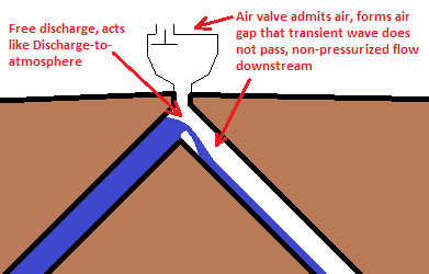

The Air Valve element (sometimes referred to as a combination air valve or CAV) is typically placed at high points in the pipeline and other areas that are susceptible to sub-atmospheric pressure during a transient event. They allow air to enter into the system during periods when the head drops below the pipe elevation and expels air from the system when water columns begin to rejoin. After the air has been expelled and the pressure is positive, the valve becomes closed.
If you are analyzing an existing system that has air valves, you should place them at the appropriate locations. If analyzing a proposed system or system improvements, you will likely want to first compute the transient simulation without the air valves. In the Transient Results Viewer, you would check the pressure envelope to identify critical points where air valves may help prevent vapor pockets. Then, you would place the air valves along your pipeline and compute the transient simulation for a range of air valve types and/or configurations. Comparing the profile animation or pressure envelope for each trial of air valve configuration (orifice size, air valve types, etc.) will give you a good idea of the sensitivity and behavior of the air valves in your system.

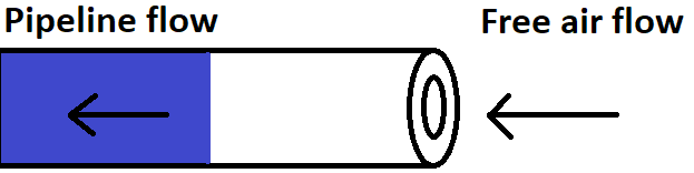

There are essentially two ways in which an active air valve can behave:
  1. Pressure below atmospheric - air valve is open and acts to maintain pressure of zero on the upstream end.
  2. Pressure above atmospheric - air valve is closed and acts as a junction.

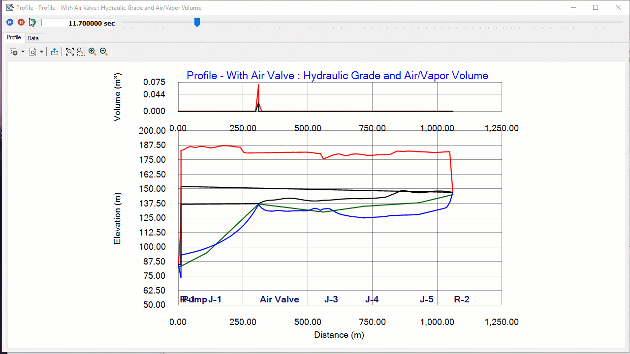

The presence of air in the pipe limits sub-atmospheric pressures in the vicinity of the valve and for some distance to either side, as shown on HAMMER profile graphs. Air can also reduce high transient pressures if it is compressed enough to slow the water columns prior to impact.
Note: low or sub-atmospheric pressure can still occur further along the pipeline; the air valve element only provides local protection.
Typically, the air inlet orifice is large (1-3") in order to allow free air intake and there is no throttling due to the sonic limit. If the air inflow orifice is too small, the model may show the hydraulic grade dipping below the physical elevation of the air valve (negative pressure) in an animation of the profile. The outflow orifice may be smaller, which will limit air outflow and cause the air to compress inside the pipe and cushion the water column collapse.
Without an air valve, sub-atmospheric pressure (such as those caused by an emergency pump shutdown) can cause contaminants to be sucked into the system. Thin-walled pipes can collapse and vapor pockets can can form (since water boils at such low pressures). This can cause pipes to collapse or may cause damage to pump impellers.
However, you must be careful when using the air valve, since extreme high pressure surges can be caused when the air pocket collapses. If the air inside the air valve is expelled too quickly, the water columns in the adjacent pipes can collide at a high velocity and the force will cause a severe transient. This is similar to the surge that occurs when a water column slams against a closed valve, except in this case the momentum of two water columns are hitting each other without the delay involved with valve closure. Likewise, if an air outlet orifice that is too small, the air cannot escape quickly enough. For this reason, care must be taken to select an appropriate air valve type and size, so as not to cause worse transients than if no valve had been used. It is common to use a "triple-acting" air valve to help against this problem, as this type of air valve throttles the size of the outflow orifice, typically using a float.

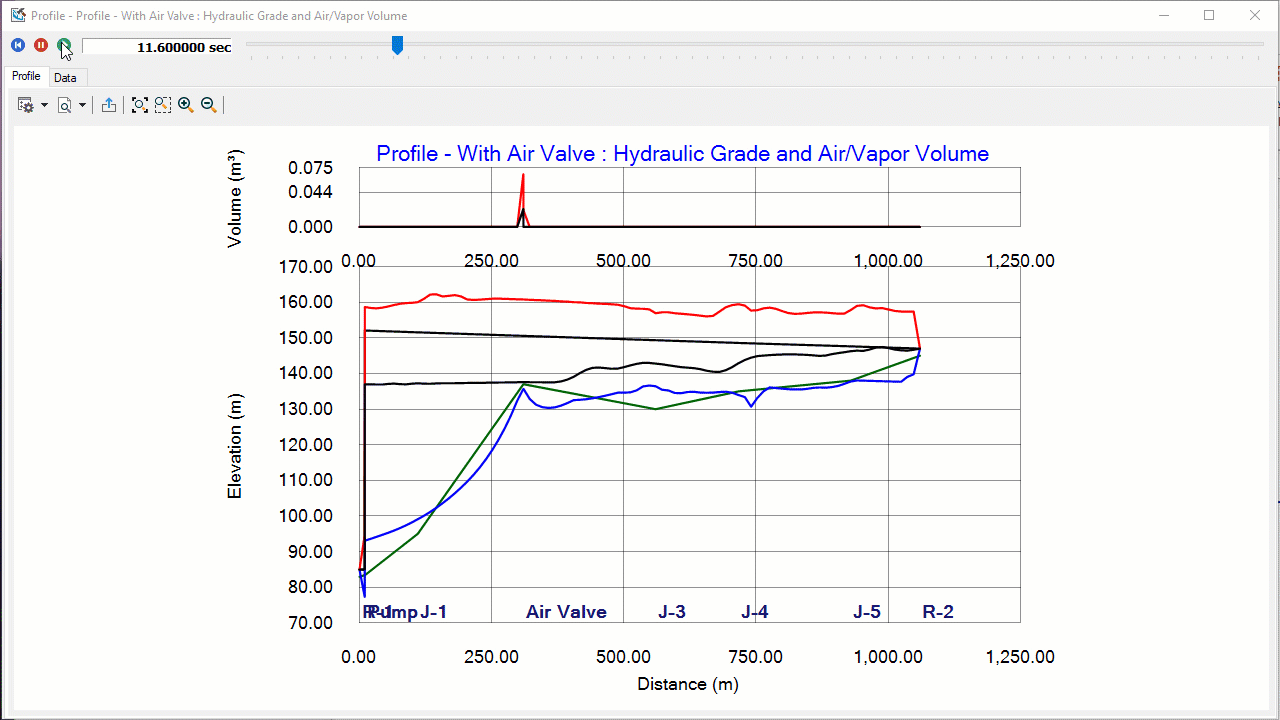

For example, consider the animations below, which illustrate a pump shutdown event with an air valve at the high point. The first depicts a double acting air valve that releases air too quickly because of a large outflow orifice. Notice the high pressure transient that occurs when the water columns collide. The second animation depicts a triple acting air valve. The transition from large to small outflow orifice is configured in such a way that it provides a cushion that helps with the water column collision, but also doesn't raise the pressure too much before that happens. Notice that the head starts to increase when the transition to the small outflow orifice occurs, but the flow is not restricted enough to cause this head increase to become too severe.
Double acting air valve with large outflow orifice
Triple acting air valve
Air Valve Topology (In-line vs. at a Tee)
Air valves can be placed directly in series with the main pipeline, or the "tee" lateral pipe that connects the air valve to the main pipe can be modeled explicitly. Here are the benefits and drawbacks of each approach:
Air valve on main line
Air valve at a Tee
The addition of the tee pipe introduces friction losses which could be significant in some cases and cause a difference in results. In particular this could impact the pressure drop at the air valve location due to the friction loss from flow in the lateral pipe, which may not occur in the real system if the lateral pipe is very short and drains out right away, whereas HAMMER does not track the air pocket movement as documented further below and here. Furthermore, short lateral pipes may be artificially lengthened by HAMMER as seen here, skewing the results as there could be more resistance than expected. Friction losses across the lateral pipe can be examined in more detail by adding the air valve and the adjacent junction as report points in the transient calculation options, then viewing a Time History graph of Hydraulic Grade in the Transient Results Viewer for both sides of the lateral (tee) pipe. Note also the "length adjustment" property of the pipe.
Note that the hydraulics may also be different in the "tee" approach when compared to the "in-line" approach due to how the air pocket will expand only on one side of the air valve as opposed to both sides with the in-line approach. (Please also refer to the section "Tracking of air pockets" regarding limitations of air pocket tracking in this wiki or found in this link.) Plus, the extra pipe may change the timing of transient wave interactions because it introduces a three-way junction and because it will typically be short and therefore susceptible to having its length or wave speed significantly adjusted. With that said, the real system most likely has a tee pipe connecting between the main and the air valve device. If you use the "tee" approach and encounter an issue with an initial surge and unexpected HGL difference in the tee pipe, be sure to select "true" for the "treat as junction" property (see more on this below)

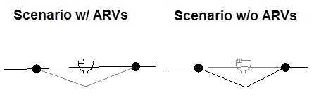

Inactive Air Valves ("No Protection")
In some cases, you may want to analyze the system without air valves. For example, you may have a "no protection" scenario that models the system without air valves, or a scenario where an alternative protection approach is taken.
In this situation, the easiest approach (and marked as "Option 1" below) is to use the "Treat as Junction? (Transient)" (not to be confused with "Treat as Junction? (steady state/EPS)" which only applies to the initial conditions). When this is set to "True", the transient simulation treats it as if it was a junction (as if the air valve does not exist), so no air inflow or outflow is modeled. This feature is available starting in version 2026 (26.00.00.XXX and higher). In earlier versions, you would need to use active topology to turn elements on and off per the illustrations below.
Regardless of the approach taken, one cannot simply delete the air valve, or even make it inactive by choosing "false" for "is active?". The reason is because every pipe must have a node at each endpoint.
Option 1 - Use "Treat as Junction"
This is the easiest approach and is available in 26.00.00.XXX and later. Using different transient alternatives, set "Treat as Junction? (Transient)" to "True" in your "No Protection" scenario, and set it to "False" in the other scenarios. With this, you don't need to worry about activating and deactivating different pipes using active topology, and you can see the air pockets forming in the Transient Results Viewer profiles. The downside is that the lateral losses are not accounted for (but as mentioned, they may not be significant)
Note: if you need the air valve node icon to look visually different in plan view when treated as a junction for the transient simulation, you can use color coding with the "Treat as Junction? (Transient)" property.

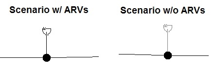

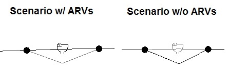

Option 2 - Air valve at a tee (lateral)
The second option is to place the air valve at a "tee" to the main pipeline. This can be a good option if you need to account for lateral losses or if you are using version 2024 or earlier (which do not have the "Treat as Junction? (Transient)" feature). With this approach, you can make the air valve and adjacent pipe inactive in the scenarios where the air valves are not present (using a new child active topology alternative). This method is not as easy as option 1, but is available in older versions, is generally easier to manage versus the "in line" option 3, and will account for headloss in the lateral pipe. Also note that you will not see the air pocket in the Profiles section of the Transient Results Viewer since the air valve will not be directly on the profile path.
Option 3 - Air valve in-line
The third option is to keep the air valve on the main line and use active topology to make the air valve and both adjacent pipes inactive, then make a new pipe going around the air valve active. Do the opposite in the scenarios where the air valves are present - make the air valve and adjacent pipes active but the other, single pipe inactive. Be careful when using this approach, as friction headloss in the lateral pipe is omitted (but you will be able to see air pockets directly in the Profiles section of the Transient Results Viewer). You may want to ensure that the bypass pipe and the pipes between the air valve and the adjacent junctions are long enough so as not to cause significant adjustment to the length or wave speed.
For version 2026 and higher, option 1 is much easier than option 3 and has the same advantages. However, option 3 can be considered for users on older versions which do not have the "Treat as Junction? (Transient)" feature.

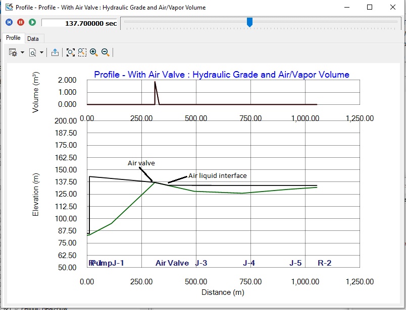

Extended CAV

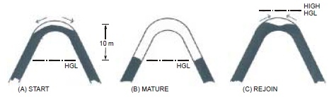

If you need to track the location of the air-liquid interface of an air pocket entering the system (instead of assuming it's localized at the air valve node), you can use the Extended CAV method. To do this, open the transient calculation options (Home > (Calculation) Options > Transient Solver or Analysis > (Calculation) Options > Transient Solver) and set "Run Extended CAD?" to "True."
When a sufficiently large volume of air enters a pipeline, the flow regime evolves from hydraulic transients to mass oscillations. Thus, at least in the vicinity of the air, the system may be represented by rigid-column theory rather than the elastic approach. Using the Extended CAV option activates this rigid (inelastic) approach. Besides improved computational efficiency, the rigid approach allows for the tracking of the air-liquid interface. When using extended CAV, the program will automatically switch between the regular (concentrated/elastic) and Extended (rigid) based on the percentage of the adjacent pipe volume that the air pocket occupies.

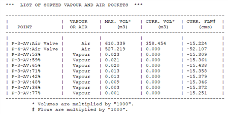

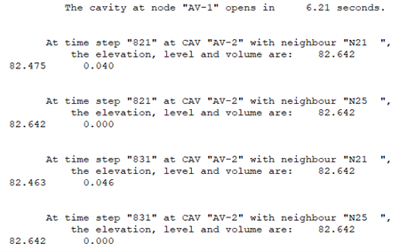

There are two ways to observe the air-liquid interface tracking when using the Extended CAV option: First, you can open the "Analysis Output Log" under Report > Transient Reports, and scroll down to the section beginning with:
*** SNAPSHOT OF EVERY END POINT AT START OF TIME STEP 2 ***
Below this table, you will find information pertaining to element statuses, including Extended CAV air/liquid interface. Example:
Second, you can open the Transient Results Viewer and animate a report path including the air valve and adjacent pipes. As the pipeline fills with air, you can observe the change in HGL downstream of the air valve. This is the air/liquid interface:
In some cases, the Extended CAV model may not be appropriate. For example, if you have a triple acting air valve with transition volume, it may not be appropriate since that is more of an elastic situation. The Extended CAV option is typically used when relatively large volumes of air enter the system.

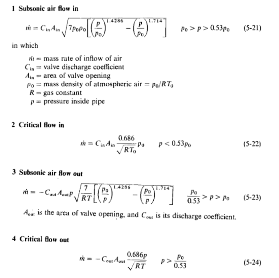

Air Flow Rate Calculation

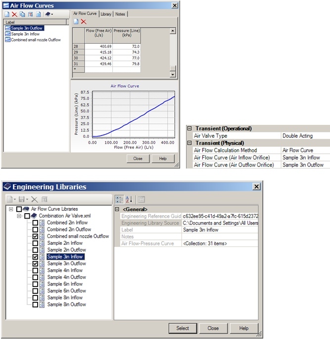

The air flow calculations (equations) depend on the selected Air Flow Calculation Method in the transient Calculation Options (introduced in HAMMER version 2026) Prior to version 2026, HAMMER always used the "Comolet" method described below, which calculated maximum air velocity and uses a pressure ratio to calculate air flow rate. Some users prefer to use the newer, "Wylie-Streeter" method which uses a different formular and is based on subsonic or critical conditions and air flow direction.
Bentley generally recommends using the new default Wylie-Streeter method but it is ultimately up to your engineering judgement and/or local requirements. Review the material below to help you decide which method to use for your situation. This option also enables you to better match results with other transient modeling software which may use one method versus another.
("Air Flow Calculation Method" is also currently the name of the attribute in the air valve properties where you can choose between equivalent diameter versus air flow curve. This calculation option is different.)
Note:
Wylie-Streeter Method (default for HAMMER 2026 and later)
When the air flow calculation method is set to "Wylie-Streeter Method", air flow calculations are based on subsonic conditions and air flow direction:
Comolet Method (default for HAMMER 2024 and earlier)
When the air flow calculation method is set to "Comolet Method" and the openings as equivalent diameters, the flow rate of air through the air valve element is calculated using the following equations which are based on R. Comolet (p. 175 of Mecanique Experimentale des Fluides by R. Comolet).
Where ρo is the density of air at 4°C and 1 atmosphere (=1.293 g/l), S=0.6A, with A being the cross-sectional area of the orifice. The throttling of air flow due to the "sonic velocity" is automatically calculated using the below formulation:
where Y is the exponent in the gas law, p is the absolute pressure, the subscript 0 denotes standard conditions, and p/ρy = constant.
p0 is the atmosphere pressure, unit is pound-force/ft2, value = 2116.2 pound-force/ft2 = 101.325 kPa
ρ0 is gas density at 40C and 1 atmosphere pressure; unit is slugs/ft3, value = 0.00251 slugs/ft3 = 1.293 kg/m3.
p is gas pressure, unit is pound-force/ft^2,
ρ is gas density, unit is slugs/ft3, can be derived using equation:  ρ=〖(P/(P_0/〖ρ_0〗^γ))〗^(1/γ)
Vmax unit is ft/s
S = 0.6A, with A being the cross-section area of the orifice, unit is ft2.
QM is air valve flow mass rate, unit is slugs/s.
γ = 1.4 in air valve calculation
If you want to calculate air volume rate, you can remove from the QM ρ0 equation and the unit will be ft3/s.
For air inflow, the first equation above is applicable, except that the ratio within the square brackets is inverted to be p/p0 as p0>p in this instance. The exponent, Y, in the gas law is hard-coded as 1.4, which corresponds to adiabatic compression/expansion appropriate for the typically rapid processes that occur. Note that "Vmax" is not the same thing as the sonic limit. Vmax is the maximum velocity that would be achieved by a fluid when it is accelerated to absolute zero temperature in an imaginary adiabatic expansion process. It is a term used in the calculations for air flow rate, but the sonic limit is ~340 m/s (1115 ft/s) at 60 degrees F.

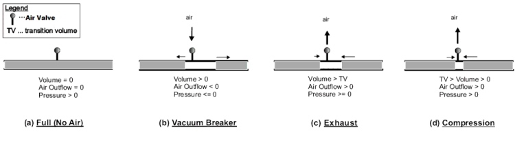

Triple Acting
This air valve type is used to model a triple acting air valve, which has an air inflow orifice at a fixed size and a variable-diameter air outflow orifice. Typically a float is used to decrease the orifice size, just before the air pocket is completely expelled.
There are three different actions:
  1. Air Inflow
  2. Air Outflow through the large orifice
  3. Air Outflow through the small orifice
When the air valve opens, air inflow comes in through the inflow diameter. When pressure returns, air escapes out of the large diameter outflow orifice. Just before all of the air has escaped, the float is pushed up, which decreases the diameter of the outflow orifice down to the "small" value. This cushions the air pocket collapse and subsequent collision of the water columns.
"Diameter (Air Inflow Orifice)" - This is the diameter of the orifice for injection of air into the pipeline. This diameter should be large enough to allow the free entry of air into the pipeline. As of version 10.00.00.50, if the air inflow orifice diameter is set to zero, an air pocket can still form (it models neither a zero diameter nor an infinite diameter, currently). This is an unlikely condition, so it is not advisable to use a zero diameter inflow orifice size. The Air Valve Orifice Diameter Calculator can be used to determine equivalent diameter based on manufacturer data.
"Diameter (Large Air Outflow Orifice)" - This is the diameter of the outflow orifice when the float is at the lowest position. It is the size of the orifice when the air volume inside the air valve is greater than or equal to the transition volume or when the air pressure is less than or equal to the transition pressure (depending on the method you selected to trigger the switch from large to small outflow orifice). The Air Valve Orifice Diameter Calculator can be used to determine equivalent diameter based on manufacturer data.
"Diameter (Small Air Outflow Orifice)" - This is the diameter of the outflow orifice when the float is at the highest position. It is the size of the orifice when the air volume inside the valve is less than the transition volume or when the air pressure is greater than the transition pressure. (depending on the selected method). The Air Valve Orifice Diameter Calculator can be used to determine equivalent diameter based on manufacturer data.
"Trigger to Switch Outflow Orifice Size" - You can choose to have the triple-acting air valve switch from the large to the small outflow orifice size based on a transition pressure or a transition volume. When selecting "Transition Volume", a "Transition Volume" input field is available. If you select "Transition Pressure," a "Transition Pressure" field is available.
"Transition Volume" - If you are using the transition volume option, this is the volume of air between the lowest and highest position of the float. In other words, it is the volume of air left in the system when the water starts to raise the float to decrease the orifice size. It is usually approximated as the volume of the body of the valve.
"Transition Pressure" - If you are using the transition pressure option, this is the pressure at the air valve location (i.e. the HGL minus the elevation) above which the outflow orifice switches from the large to the small size.
Note: Typically, there is a small amount of time to transition from the large to the small orifice diameter, but it is generally pretty quick. Given this, HAMMER assumes the switch is instantaneous. The outflow orifice will switch from the large to the small orifice as soon as the volume of air is less than the transition volume" or as soon as the pressure is greater than the "transition pressure," depending on the method you selected.
Not all triple-acting air valves trigger the outflow orifice transition based on a transition volume or pressure. For example, it may be based on velocity. In these cases, you will need to determine the air volume or system pressure at the air valve, at the time when your conditions is met. Start by setting the small outflow orifice diameter equal to the large, then enter a number in the "Report period" field. After computing the transient simulation, open the Extended Node Data tab of the Transient Results Viewer (in version 10.03.04.05) or the Transient Analysis Detailed Report from the Report menu (in older versions) and scroll down to the bottom. In the newer versions, Transient Results Viewer enables you to graph the air valve results directly while in older versions the text report show a table of air flow rate, air volume, pressure, etc over time, which you can use to determine the aforementioned air volume.
Discharge Coefficient (Air Inflow Orifice): Unitless discharge coefficient, used to adjust air valve air inflow orifice area. Default value is 0.6. Only used when the "Air flow calculation method" calculation option is set to "Wylie-Streeter". The "Comolet" method always uses a value of 0.6 for both inflow and outflow.
Discharge Coefficient (Air Outflow Orifice): Unitless discharge coefficient, used to adjust air valve air outflow orifice area. Default value is 0.6. Only used when the "Air flow calculation method" calculation option is set to "Wylie-Streeter". The "Comolet" method always uses a value of 0.6 for both inflow and outflow.
"Valve Open Delay (Air Inflow)" - this is used to introduce a delay in opening the air valve. It represents the amount of time since the pressure first drops below zero, before which the air inflow orifice opens. Note: this open delay feature currently only works when the calculation option "Run Extended CAV" is set to false.

Time History graphs
To view the hydraulic grade, pressure, water flow rate and air pocket size in the pipe endpoint adjacent to an air valve, be sure to add those points in the report points collection in the transient calculation options, then use the Time Histories tab in the Transient Results Viewer.

Transient Analysis Output Log
You can also review summary information on the air pockets, in the "Analysis Output Log", found from the Reports > Transient Reports. Once open, search for "list of sorted" and you will see a table of all locations in the model (pipe endpoints, with format of pipe:node) where at least one vapor or air pocket has formed during the transient simulation. Time-series information on air valve results are found in the Detailed Report as mentioned further above.
The "MAX. VOL" column shows the maximum volume of air or vapor at that location over the course of the transient simulation. For metric units, the value is multiplied by 1000.
The "CURR. Vol" column shows the vapor or air volume at the end of the transient simulation (last time step, current volume). For metric units, the value is multiplied by 1000. A positive value there indicates you may need to run the simulation longer by increasing the duration in the transient calculation options in order to see the system reach a true final steady state. Or, if this is a pump shutdown event, you may need to analyze what happens when the pump turns back on and vapor or air pockets collapse.
The "CURR. FLW#" column shows the flow through the respective endpoint, at the end of the transient simulation (last time step, current flow). For metric units, the value is multiplied by 1000.

Using Custom Air Flow Curves
Traditionally, the openings for air flow into and out of an air valve are specified in terms of an equivalent diameter. In version 08.11.02.31 and higher, you can specify a pressure vs. air flow rating curve for any of the openings, instead of an equivalent orifice.
Known issues / troubleshooting custom air flow curves

Screenshots of custom air flow curves:

Why are my transient pressures worse after adding an air valve?
Air is likely being released too quickly, causing the adjacent water columns to collide at high speed. See more here: Transient pressure worse with air valve added
Why do I see air outflow when the air valve pressure is negative?
This condition is possible because of the drop in water level inside the air valve. Meaning, the hydraulic grade shown in the results at an air valve is actually the water level inside the air valve, not the hydraulic grade resulting from air pressure. See: Positive air outflow occurs when air valve pressure is negative during transient simulation
