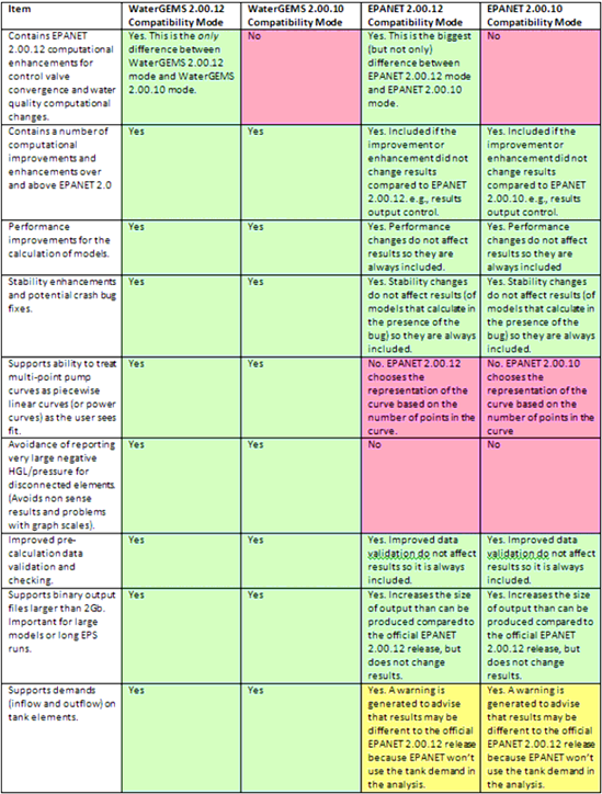

Compatibility Matrix - 2.00.10 vs. 2.00.12
The following engine compatibility matrix is included in the Help file (Modeling Capabilities>Calculation Options>Engine Compatibility Calculation Option).
2.2.0 Engine Version
The 2.2.0 engine version adds additional enhancements beyond 2.00.12 mentioned in the table above.
