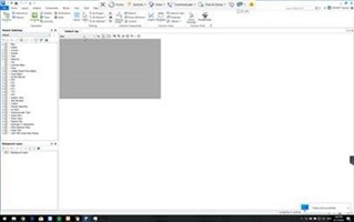

In some cases, you may experience an issue with your OpenFlows application that occurs regardless of the model file and is found to be related to the video / graphics hardware on your computer. Symptoms including the drawing pane not rendering correctly or an error or crash occurring, where the details of the error mention key phrases related to graphics such as "OpenGL", "CGLDevice", "render", "GraphicsLibrary", "GLDrawing", "GDI", "GraphicsLibrary".

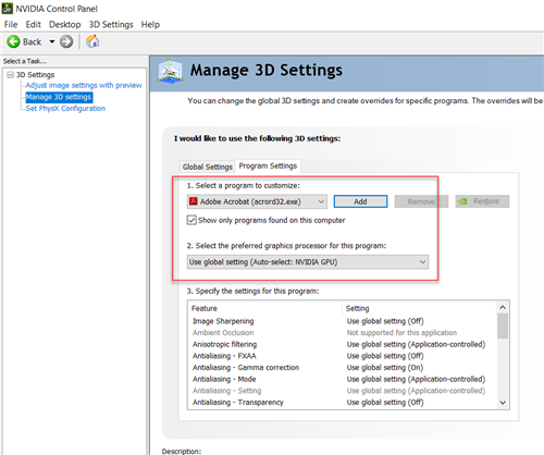

Another thing to check is the settings of your video hardware. These are highly dependent on the hardware but are usually located by right clicking on your desktop. Graphics hardware is typically Intel (such as "Intel HD or Intel UHD which is built into your CPU), AMD (Radeon) or Nvidia (Geforce or Quadro) If you use both integrated video (such as "Intel UHD") as well as a discrete video hardware ("video card"), check your discrete hardware's control panel software to ensure that your Bentley product is set to use the discrete video hardware and not the "integrated" hardware. For example you may see "NVIDIA Control Panel" listed when right clicking on a blank area of your Desktop, or as an icon in the System Tray in the lower right corner of your screen.
E.g. In below settings of NVIDIA control panel, please check if you have added Bentley software's to use these discrete video card driver and not onboard hardware like intel HD. For Nvidia, you may need to set the OpenFlows product to use the "high performance" hardware and possibly set the "PhysX" configuration to the Nvidia hardware, in the "Manage 3D Settings" or "3D Parameters" section.

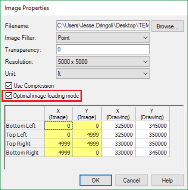

Toggle Optimal Image Loading Option
In the CONNECT Edition and greater, you can edit the properties of a background image and check or uncheck the box for "Optimal image loading mode". If you encounter the following error, then unchecking the box may help, though image quality may be reduced (the background may appear blurry):
"Feature not supported in current OpenGL version. Disable optimal image loading mode if enabled"
NOTE: You can also try toggling off the Use Compression option to see if your video returns to normal.
