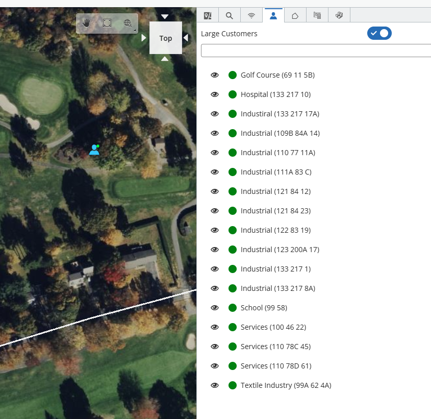

Large customers information can be found and controlled under the Large Customers tab, located in the side panel. To turn on/off the large customers on the map, please click in the visibility icon located on the top. By default, large customers will be turned off. Large customers are configured in the smart meter configuration page. Large customers will be displayed in the map with a customer icon.
Note: Large customers defined with priority 0 in the smart meter configuration page (inside Admin) will not be displayed in the map page.

Search
Type for the wording to search in the Large Customer side panel to search for a specific sensor. Restricts the displayed sensors in the map and panel to the text fragment entered into the search field.
Filter
Clicking in  icon located on the side panel to filter sensors. It is used to control the way the sensor list is displayed:
Sort By Description
Alphabetic Sorts the list of sensors ascending in alphabetical order
Status Groups the list by status and sorts within groups in alphabetical order
Measurement Groups the list of sensors by their measurement and sorts within the group in alphabetical order

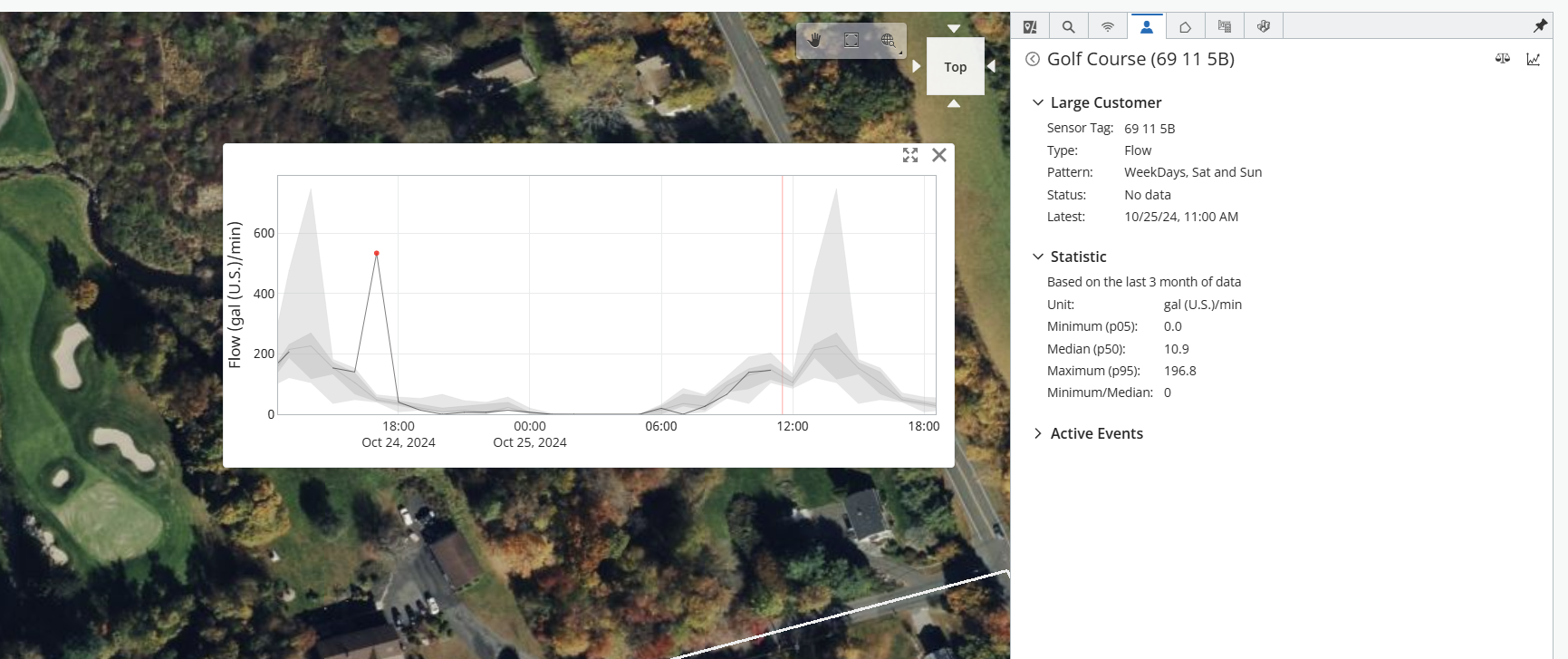

Selecting a Large Customer
When clicking in a Large Customer icon from the map or from the side panel, a chart with sensor reading for the previous 24 hours is shown together with more information on the side menu.
To exit this view or return to previous view, click on the close (x) icon located in the sensor chart or click on the back arrow  located in the side panel.
Large Customer chart
Sensor reading for the previous 24 hours is shown (black line with color coded circles) together with the expected patterns - grey bands (in case patterns are configured in smart meter configuration page). The main goal is to provide an at-a-glance indication if "patterned" variables lie within the expected range of values​. Particularly useful to quickly spot any anomalies (that can represent internal leaks or anomalous consumptions) in real time.
User can click in the expand button located on the top right of the graph  for more detail. The chart will extend to full page with more options, such as: navigating in the time series history, create event button shortcut, changing pattern or time series-interval, adding model results or raw data, etc. More information in the sensor details help-page.
Large Customer Details
Sensor Tag: The signal tag in the database associated with the sensor
Type: Type of measurement
Pattern: Pattern group assigned to the sensor. Pattern groups can be created the the Administration > Settings > Pattern and assigned to sensors in the Admin > smart meter configuration page. If Pattern None is selected, then no patterns will be computed and displayed in the sensor graph. Patterns are displayed in the sensors graphs as grey bands.
Status: Ok (reporting within expected delay), Partial (reporting moderate delay) and no data ( reporting significant delay) More information above, under Status section.
Latest: The timestamp of the latest signal reading.
