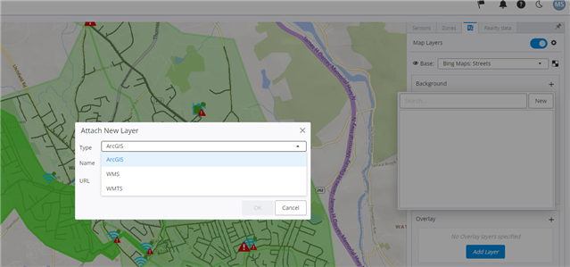

User can add more layers, including direct connection to ArcGIS online databases, WMS or WMTS, by clicking in the "Add button (+) located on the top inside the Background and Overlay sections.
From there click New, and choose the type (example below).
Type
Select the type of service. The Background and Overlay sections allow to reference three types of GIS data:
Name
Type a name. Use a name that is relevant so that any user who wants to attach the layer can easily know which layer he is attaching.

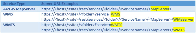

URL
Type or copy the URL of the server to attach.
Here are some examples of URL that could be used:

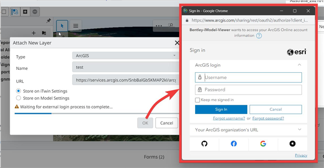

ArcGIS Online connection
Map service
Select ArcGIS type from the dropdown type for the map server option. The map layers widget available within WaterSight is also used in other applications at Bentley. The video below explain how to connect with your ArcGIS online. Please note that ArcGIS Online works out of the box, no configuration is required from the client.

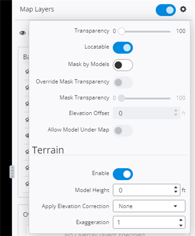

Settings
Click in the settings icon located on the top of the Map layers tab to accede more configurations such as setting transparency to the layers, elevation offset and terrain configurations. located on the top of the Map layers tab to accede more configurations such as setting transparency to the layers, elevation offset and terrain configurations.
Transparency
Use the slider to apply transparency on all layers from the Map Layers widget.

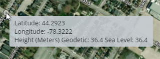

Locatable
Toggle ON this option to see the information and coordinates of the location pointed by the cursor on the Bing layer.
Elevation Offset (m)
Use this option to adjust the Map layers elevation to align with the network pipes whenever necessary.
Terrain
The Terrain section contains options related to the display of the Cesium terrain layer. Toggle ON the "Enable" option to activate the Cesium terrain layer and have a 3D view of the terrain surrounding the area.
Model Height (m)
Use this option to adjust the terrain elevation so that it fits the model elevation.
Exaggeration
Use this option to exaggerate the elevation of the Cesium terrain.
Please note that to accede the 3D view, with all terrain configurations applied, the user needs to move the cube located on the top right of the map.
