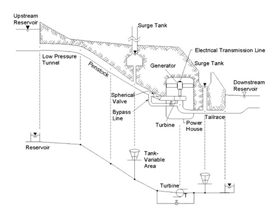

Turbines are used to convert the potential energy of flowing water into electricity. They can be used in large scale applications like dams, or small scale such as recovering energy on the downstream side of a hill.. Given the importance of turbines in these systems, it is essential for a modeler to predict the transient pressures that might occur for example as a result of sudden closure of the wicket gate (to prevent overspeed) and to implement an adequate surge control strategy to ensure the safety and reliability of the turbine.
HAMMER can be used to model transient simulations where turbines are involved and analyze potential protective measures that can be used to mitigate the effects of transient events.
Turbines in HAMMER
Hydropower turbines are located at the downstream end of a conduit, or penstock, to absorb the moving water's energy and convert it to electrical current. Conceptually, a turbine is the inverse of a pump, but very few pumps or turbines can operate in both directions without damage. If the electrical load generated by a turbine is rejected, a wicket gate (which is built into the turbine element in HAMMER) must rapidly stop flow, resulting in a large increase in pressure, which propagates upstream (in the penstock).
Note: HAMMER currently does not support modeling a pump-turbine element - see more at the bottom of this article.

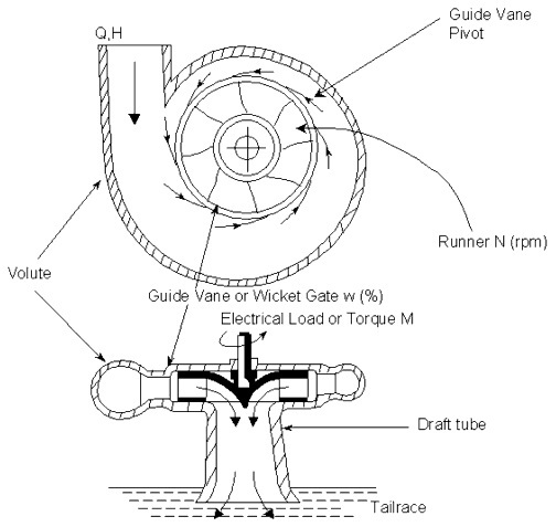

Electrical Load or Torque on the turbine-generator system varies with the electrical load in the distribution grid. In steady-state operation, the electrical torque and the hydraulic torque are in dynamic equilibrium. From a hydraulic perspective, electrical torque is an external load on the turbine.
The moment of inertia comes into play here as it can influence the rate at which a turbine speeds up or slows down. See further below for an explanation of how HAMMER calculates the turbine speed change.
What value should I use for moment of inertia of a turbine?  Should I use WR^2 or GD^2?
Moment of inertia in HAMMER is defined by the equation WR^2, where W is the weight of the turbine and R is the "radius of gyration" (not the radius of the impeller). Reference.

How do I model the Draft Tube?
In the above first illustration, this is simply the pipe immediately downstream of the turbine. You can model it as a pipe going to a reservoir, sometimes with a surge tank between.
How do I model a bypass valve?
In some cases the turbine may have a built-in "synchronous bypass valve" which opens as the wicket gates close, to help prevent damaging transients.
This can be modeled with the Throttle Control Valve (TCV) element. You would need to manually control the open and closure of the bypass valve using the TCV's operating rule pattern. Here is an illustration of the plan view layout:
The TCV's closure characteristics can be based on either headloss coefficients or discharge coefficients. For more information on TCV modeling, see: Modeling Reference - Valve Closure
You may need to use a smaller timestep to prevent excessive adjustment to the length or wave speed of the two short pipes adjacent to the turbine and TCV, unless you can neglect such adjustments (see this for more).
Although the bypass valve may help keep the water column moving to avoid damaging transient pressures, you would still want to analyze this in HAMMER to confirm. You may also want to consider modeling the case of the bypass valve being stuck, to see what would happen if it did not open as the wicket gates close.

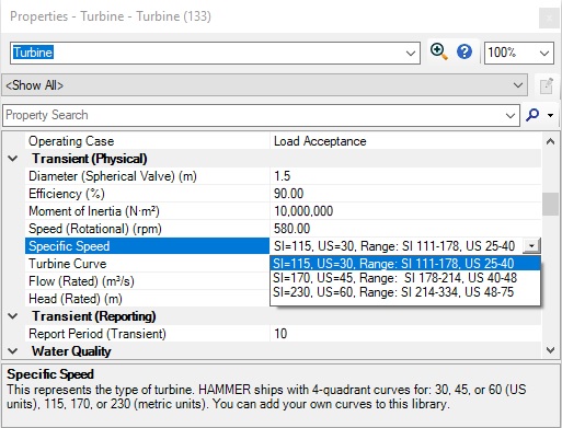

Specific Speed: Enables you to select from a list of available Specific Speeds, which represent a characteristic curve (see further below) that is used to model the hydraulics of the turbine during the transient simulation. The following default specific speeds are included: 30, 45, or 60 (U.S. customary units) and 115, 170, or 230 (SI metric units). The source of these three defaults is the US Bureau of Reclamation. You can enter your own data in the XML library. See the Help documentation for more information.
Note: Starting with HAMMER CONNECT Edition Update 3 (version 10.03.02.75), the specific speed range is presented in the Specific Speed property field for Properties and FlexTables.

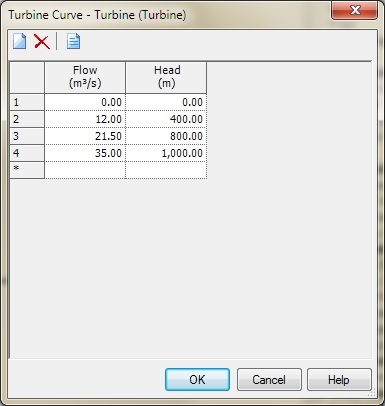

The property field "Turbine Curve" is used to determine the relation between flow and headloss across the turbine during the steady state analysis used for the initial conditions. If you are modeling a Load Acceptance operating case, you will need to manually enter a rated flow and rated head instead of the turbine curve. This is so that the program has a starting point for the development of the characteristic curve (based on the shape of the curve specified by way of the Specific Speed selection.) In the other modeling cases, the flow and head(loss) used are derived from the turbine curve in the initial conditions. Load Acceptance assumes that the initial status of the turbine is closed, meaning there is no rated flow and head results. Instead, the program will use the rated flow and head entered in the properties.
The relationship here is typically the reverse of a pump. Meaning, as flow increases, "head" increases. This is because the "Head" in this case is not the head added, but rather it is the head drop across the turbine (difference between downstream and upstream HGL) during the initial conditions, some of which will be converted to electrical energy.
The flow and head relationship defined in the Turbine Curve is only used to establish the initial conditions operating point of the turbine and is not used directly during the transient simulation. The transient simulation uses a separate characteristic curve based on the selection of "Specific Speed". The specific speed's characteristic curve defines the shape of the turbine characteristics for each position of the wicket gate (since the wicket gate is built into the turbine) and it applies that dimensionless shape to the set of head and flow from the initial conditions (based on the turbine curve) to establish the characteristic curve used to simulate the turbine during the transient simulation. In other words, the points on the constructed curve are relative to the initial conditions operating point (head/flow) which is derived from the turbine curve.
Since load rejection and variation events assume the wicket gate starts fully open, the Turbine Curve that you enter (for the initial conditions) should represent the turbine's rated/nominal characteristics when the gate is in the fully open position. Meaning, when using the load rejection or load variation operating case, HAMMER assumes that the turbine begins in the fully open position. This assumption should be acceptable for the purposes of a transient simulation where you are typically looking at worst-case conditions.
For load acceptance, the gate is assumed to be initially fully closed. Since the flow is zero, you would enter the "rated" head and flow input fields instead of the turbine curve, and they would also represent the nominal operating point of the turbine when the gate is fully opened (since the wicket gates will open during the transient simulation). This information should be available from the turbine manufacturer or you can obtain it by performing a steady state initial conditions run with the turbine open, and note the calculated head and flow (then close the turbine and enter those values for the nominal operating point for load acceptance). See more in the load acceptance section further below.
If you want to force a specific flow and head for your turbine's initial conditions, there are some options:

There are three different default specific speeds available to choose from, obtained from the USBR: "SI=115, US=30," "SI=170, US=45," and "SI=230, US=60."
Note: In a case where you need to use a characteristic curve not represented by the choices above, it is possible to create a custom Specific Speed (and underlying characteristic curve). Please see the Help topic "Pump and Turbine Characteristics in Bentley HAMMER" for details. Note that the data that you enter for the curve is unitless - it represents the shape of the curve, which is applied to the initial head drop and flow across the turbine to construct the characteristics curve (with units) used during the simulation. Note that this information may be difficult to obtain, as a separate curve needs to be entered for each position of the built-in wicket gates.

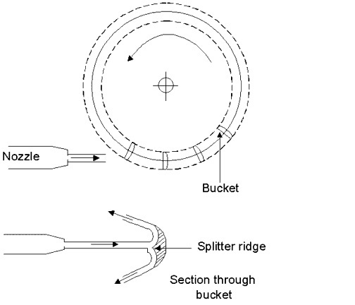

A Note on Impulse or Pelton Wheel Turbines
An impulse turbine has one or more fixed nozzles through which pressure is converted to kinetic energy as a liquid (typically water) jet. The jet impinges on the moving plates of the turbine runner that absorbs virtually all of the moving water's kinetic energy. In practice, the most common impulse turbine is the Pelton wheel shown in the figure below.
Its rotor consists of a circular disc with several "buckets" evenly spaced around its periphery. The splitter ridge in the center of each bucket divides the incoming jet(s) into two equal parts that flow around the inner surface of the bucket. Flow partly fills the buckets and water remains in contact with the air at ambient (or atmospheric) pressure.
It is important to note that the turbine element in HAMMER is not used to represent impulse turbines. Transients caused by impulse turbines can be approximated in HAMMER by using a Throttle Control Valve (TCV) and/or Discharge to Atmosphere (D2A) element to represent the turbine nozzle and valve that closes off flow to it.

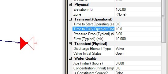

Pelton Turbine - Linear valve closure
An example of this setup would be to approximate the gate closure on the impulse turbine using a "Discharge to Atmosphere" (D2A) element. See the schematic below for one possible setup of the system:
If you want to model the impulse turbine gate closing in 10 seconds (for example), you would set the D2A property field "Discharge Element Type" to Valve with an initial status of Open. Then you would set "Time to Fully Open or Close" to 10 seconds.
Note: remember to enter values for "Pressure Drop (Typical)" and "Flow (Typical)". The "Flow (Typical)" is simply the expected flow from the turbine. You can calculate the typical pressure drop using the orifice equation). More information on entering this information can be found in the Discharge to Atmosphere article.

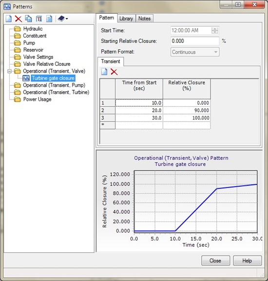

Pelton Turbine - more advanced valve closure
If you want more control over the valve closure, you could use a Throttle Control Valve (TCV) element instead.
The TCV allows you to enter an Operating Rule that has curve of valve closure (or gate closure, for an impulse turbine) versus time. For example, you could have the gate close quickly until it 10% open, then close more slowly the rest of the way.
More details can be found here: Modeling Reference - Valve Closure
