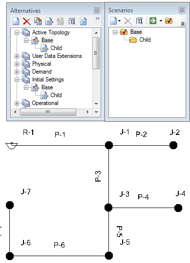

- There are two scenarios, base and child. The Base scenario uses the alternatives called "base" and the child uses the ones called "child".
- The model network is laid out while in the base scenario

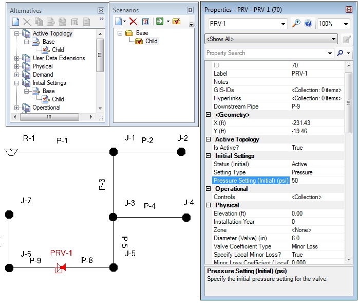

Now, let's say you're working in the Child scenario and decide to insert a PRV into pipe P-6 (pipe split)
- The initial status of the PRV is entered, and therefore stored in the "child" Initial Settings alternative.

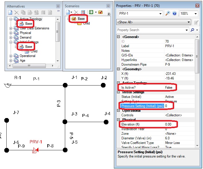

Everything appears to be fine, at least in the child scenario. However, if you now look back at the Base scenario (which again, uses the Base alternatives), there's a problem:
- The valve is inactive
- The pipes reference an inactive node
- The initial pressure setting, elevation, etc are all default / zero
The reason is because when a new element is added to the model, it exists in all scenarios/alternative and initially takes on default settings (zero elevation for a node, 6 inches diameter for a pipe, etc), or default settings set up in a Prototype. These default settings will initially be populated for that element in all alternatives (and for all scenarios.) The exception is Active Topology, where the default status for the "Is Active" property is "False" for all Active Topology alternatives except for the one that is used by the scenario that was active when the element was added (and any child alternatives if inheritance is not disabled in them.) The element's "is active" state will be set to "True" for the current scenario/alternative, which can be inherited by child active topology alternatives. The reason why parent active topology alternatives have a default status of "false" for "Is Active?" is because it is assumed that a child active topology alternative represents future conditions, and that the elements placed in the future conditions scenarios do not yet exist in the parent scenarios.
Therefore, that element will remain inactive in any parent active topology alternatives. Likewise for other properties, once they are changed in a given alternative, that change can be inherited by child alternatives, but the parent/base alternatives will still remain with their initial, default status.
This is why in the example above, the pressure setting was still zero in the base scenario and the "is active" status was "false".
