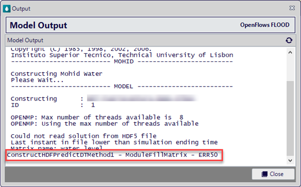

When running an OpenFlows FLOOD simulation, if the model setup and configuration is inconsistent, the numerical engine will output for the majority of cases an error message.
Typically, the error message is shown during the initialization phase of the simulation, a few seconds after the user launches the simulation. A dialog stating the simulation has finished will appear:
Note that, this message appears always when the model simulation is finalized either successfully or unsuccessfully.

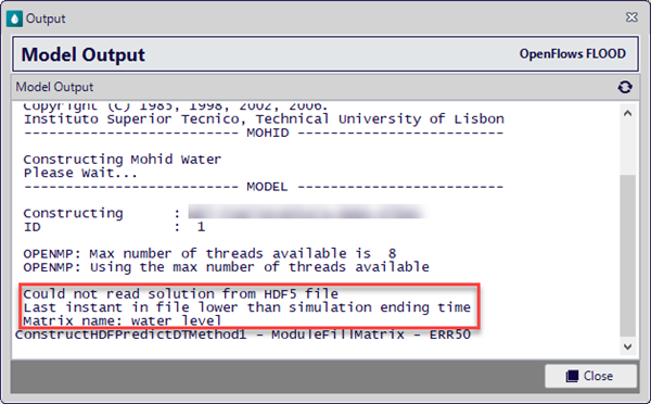

Select Yes to view the simulation log file and scroll to the end. In case the simulation ran successfully, a clear message will appear at the end of the file.
If the simulation was unsuccessfully, an error message will appear at the of the file. The error message may contain a information about the error and how to solve it. It maybe more or less detailed as shown below:
Nevertheless, the error message will always contain an error code as shown in the figure below:
The error code will contain 3 parts, the subroutine/method that generated the error, the correspondent module and a number (e.g. ERR50).
