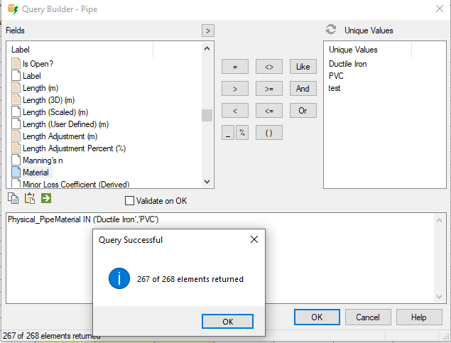

The IN Operator
The IN Operator can be used in a query to filter based on a specific list. For example, if you use three different materials for pipes but only want to see those that are using two of those three materials, you can use the IN operator to specify that list. The list will be in parenthesis using the single quote character to denote the value. Values in the list are case sensitive. Note: Starting with version 10.03.03.72 of WaterGEMS, WaterCAD, and HAMMER, an IN button has been added to the Query Builder. For the storm-sewer products or for earlier versions, you can use the following syntax:
<fieldname> IN ('Value1','Value2')
Here is an example where we want to filter a pipe FlexTable to only show pipes with material of "Ductile Iron" or "PVC":
