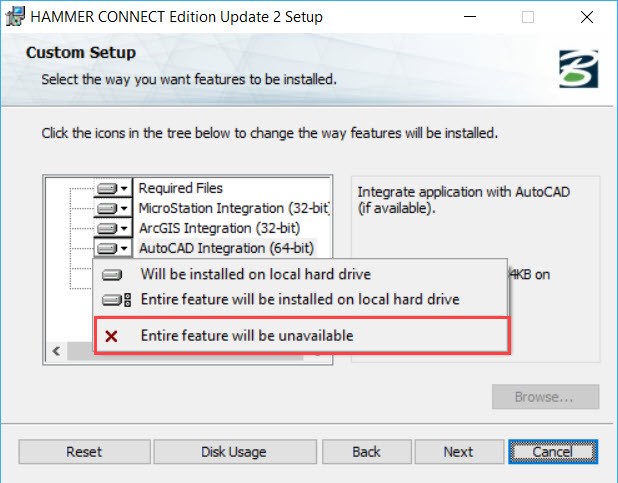

How can I disable or remove the ArcGIS, MicroStation, and AutoCAD integration option from the Start menu, so a user cannot accidentally click on it and integrate the software with those platforms?
Or
How do I disable ArcGIS, MicroStation, and AutoCAD integration to avoid accidental license usage?
The "Integrate with..." Start menu shortcut will always be installed, but you can always delete the shortcut, or the shortcut for the integrated platforms if they appear.
During installation you can choose not to integrate with AutoCAD / MicroStation / ArcGIS. Click on the AutoCAD / MicroStation / ArcGIS option for which you would like to disable integration and choose "Entire Feature will be unavailable" to disable integration during installation
This prevents the files necessary for the platform integration from being deployed. If a user accidentally clicks on the option after that it will still open the command line window that looks like it is integrating the software, but it will not actually do anything.
