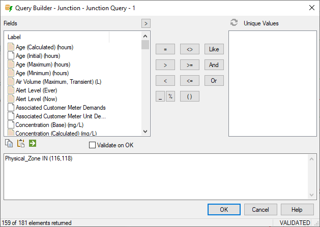

A shortened way to do this is to use the IN operator where the set of criteria is in parenthesis, separated by commas. For example:
Diameter IN (6,8,10)
Or...
Physical_Zone IN (116,118)

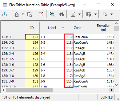

Note that some fields such as the Zone need to use the unique ID instead of the label. So in the example above, the numbers 116 and 118 represent the ID of two specific zones. The ID can be seen next to the label in the properties or in the Flextable, when the Element Identifier setting is set to "ID:Label". This can be found under File > Options > Hydraulic Model.
