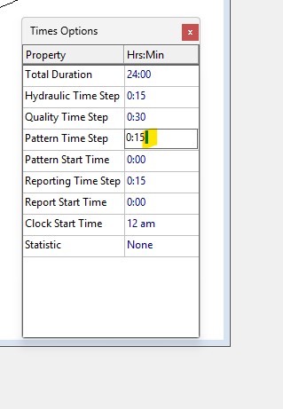

7) The Pattern time step is imported incorrectly.

If your pattern times were incorrectly imported from EPANET to OpenFlows products (e.g., 15 minutes is imported as 15:00 hours), make sure there are no empty spaces in the EPANET pattern time (see the attached screenshot). This should solve the issue.
