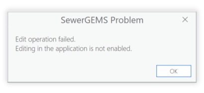

10) Check ArcGIS Pro editing options
If you encounter an error when trying to load your hydraulic model, such as "Edit operation failed... editing in the application is not enabled", you may need to adjust your ArcGIS Pro editing options.
