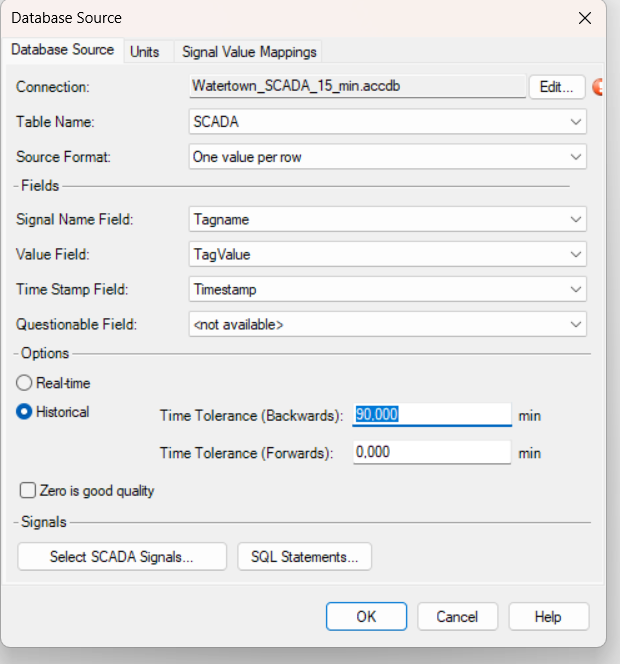

In order to have the initial conditions imposed to the instant corresponding to the start of the simulation or in order for the user to directly compare modeled data with measure data, it is required that in the WaterGEMS model that is uploaded to WaterSight (under Administration >> Numerical Models):
Note: The SCADA signals should be created and listed but it is not required to have the live connection with the sensors data sources/data bases established in the model that will be uploaded in WaterSight. The connection with the data sources/ data bases is done by the Data Pusher (OpenFlows Onsite Coordinator) or Rest API connection. More information in video below.

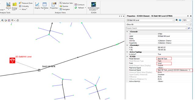

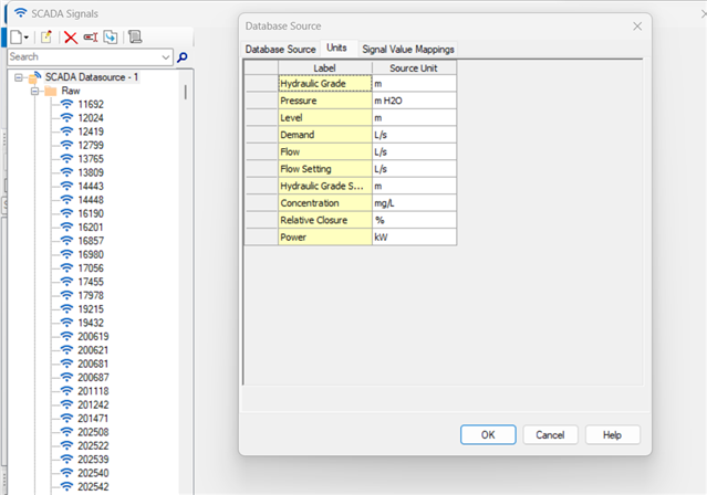

Below an example of the SCADA signals name/tags and units in WaterGEMS (that need to match those defined in the sensor administration page of WaterSight)
Below an example of a SCADA element created in the WaterGEMS model and mapped to the associated model element (in this case tank level).

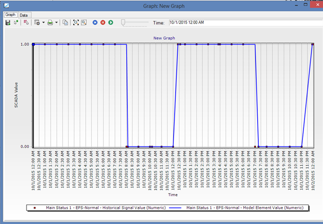

Imported overrides are defined in the WaterGEMS model and allow the user to have the system operate as it did at the time of the specified historical simulation (inferred from the historical scada data). By default, Imported Control Overrides take precedence over 'Regular' Controls. If there is a conflict between a Regular and Imported override, the Imported override will take precedence. If you want the "Regular" Control Override to take precedence, you can increase the priority.
When the calculation option Automatically Import Control Overrides is set to True and the SCADA calculation simulation mode is Historical or Historical (Live Training), pump status and valve status will be imported to Active Control Overrides. First, the existing control overrides are cleared. Then, new control overrides are imported from SCADA data and used in SCADA calculation. When there is conflict between pump (or valve) control and SCADA signal, SCADA signal pump (or valve) status are used in control pump (or valve) status. Only pump and valve statuses within simulation time range are imported.
The following is pump status result comparison with SCADA signal when Automatically Import Control Override is set to false in SCADA simulator Historical calculation. At some calculation time steps, the pump status is different from SCADA signal.
The following is pump status result comparison with SCADA signal when Automatically Import Control Overrides is set to true in SCADA simulator Historical calculation.

Imposing initial conditions to the hydraulic model based on sensors measurements
The sensors measurements that can be used to override the initial conditions of the hydraulic elements are the marked as Yes in the below table. All the other attributes listed in the table, even those that can not be used to override the initial conditions for the hydraulic model, can always be used to compare model results with the real measurement results.
In order to impose initial conditions from sensors into the hydraulic model or to compare model results with measured results it is required that SCADA elements are already created in the WaterGEMS model, associated with a valid SCADA signal and correctly mapped to the model element as mentioned above.

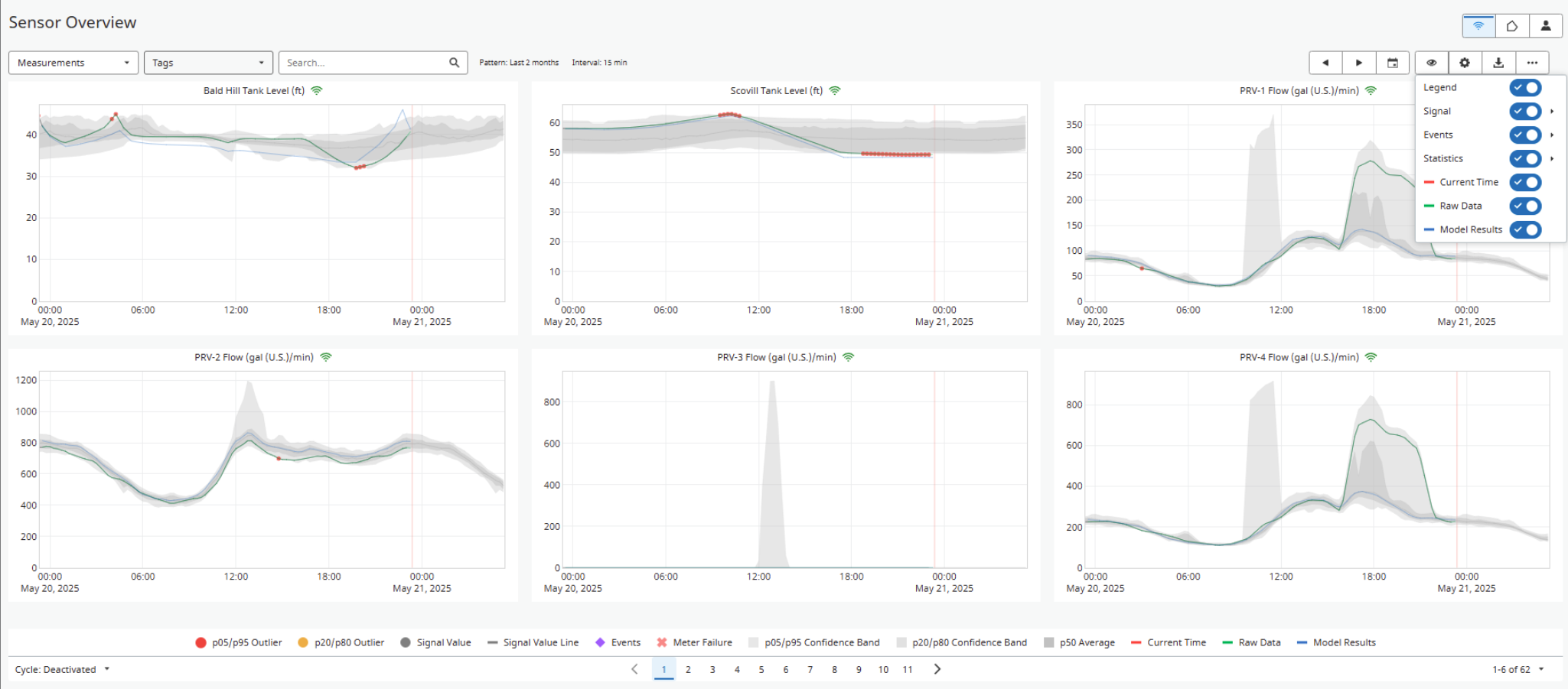

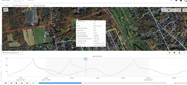

Comparing sensor data with modelled data
As mentioned above, it is also possible to directly compare measured data with modelled data (in case SCADA elements are created and mapped in the WaterGEMS model file, see above). Once sensor elements are configured in the hydraulic model and associated to the model element, then it is possible to directly compare in the same graph the real sensor measurements with the modelled results to check the accuracy of the hydraulic model. It is important to highlight that this comparison can be done for any sensor that is associated with a hydraulic model element - any sensor type that is contained in the table 1 above.
To see the comparison between the modelled and measured data, the simplest workflow is to go to Network Monitoring >> Sensor Overview >> and turn on model results. Model results will be displayed as a blue line in the graphs.
More detailed information can be found here - Comparing Modelled data with Measured data.

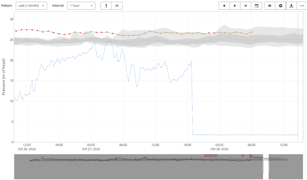

Why model data does not match sensor values for the boundary elements?
In case it is noted that the model values in WaterSight do not match the sensor values for the boundary elements (for example tank levels, PRV settings) please make sure that the units defined for the SCADA signals in the uploaded WaterGEMS model matches the units defined for the sensors in the WaterSight in the Admin >> sensors and are the same as in the database. More information here - Why Model data does not match Sensor values?
Fig 1 - Model value at blue does not match sensor measurements (black line) for the PRV boundary element due to mismatch of units defined in the hydraulic model and in the sensor configuration template
