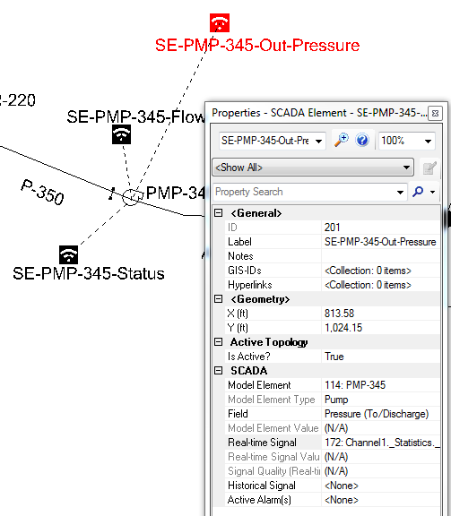

SCADA Element Properties / Signal Mapping
Once the SCADA Elements are placed, double-click the Element to bring up its properties.
Model Element - Click on the drop-down menu and select the target element: Pipe, junction, valve, pump, or tank. Note: starting with CONNECT Edition Update 3 (and a patch for Update 2), you can map a SCADA signal to a reservoir.
Field - Click on the drop-down menu and select the type of the data that the signal represents.
Real-time Signal - Click on the drop-down menu and select the signal that represents the field selection above. The list of the signals in this field is tied to the signals visible in SCADA Signal Editor.
Historical Signal - Click on the drop-down menu and select the signal that holds the historic information.
Active Alarms - In this field there are several drop-down menus which after selecting shows different options to enter. Corresponding to the values defined, the Alarms tab in the User Notifications window will update. For more on Alarms see the Alarms section below

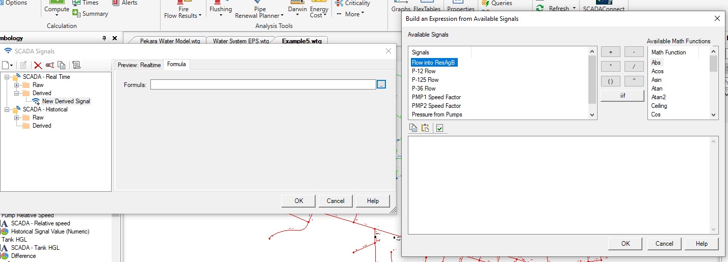

A note on Derived Signals
Starting with WaterGEMS CONNECT Edition Update 3 (version 10.03.01.08), you can now choose between using raw data or formula-derived SCADA data.
In addition to the raw signal data directly pulled from the data source, there are now derived signals which take raw signals from the same data source and transform them based on a user defined formula. This makes it easier for you to bring in signal data exactly the way you want. These Derived Signals, once created, work like raw signals when setting up SCADA Elements.
To create a derived signal you can right-click on the “Derived” node under the data source which contains the raw signals, then select “New” or right-click the signal you want to derive from and select “Create derived signal from..."
In the dialog that opens, you can enter a label and select the transformation method (Formula or Override). If you choose Formula, there will be a Formula tab. Click the ellipsis ("...") button. You will be able to apply a formula to an existing SCADA signals using a number of math functions.
Note: there is a known issue with performance when using derived signals with a large number of data points (reference # 1374947). This has been resolved in a patch for version 23.00.00.19. Please contact Support for help or upgrade to a newer version when available. Also, it is recommended that you use a tolerance (forwards/backwards) as big as necessary, but no bigger, as it may impact performance slightly if set too large. For points that are expected to be at a frequency of 1 minute for example, a tolerance of +/- 5 minutes (or less) would be advisable unless there was a specific reason to go wider than that.

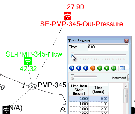

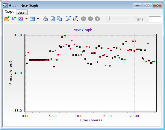

SCADA Element Graphing
The SCADA data can be viewed in the graph manager as well. Simply right-click on the SCADA Element and then Graph. Click OK on the Graph Series Options window and a graph will be displayed. Note: generating graph for Real-time may not be as valuable as for historic data as there may be only one data value at a given time for a signal.
If data are not visible in the graph then please refer to the FAQ in the SCADAConnection Simulator TechNote.

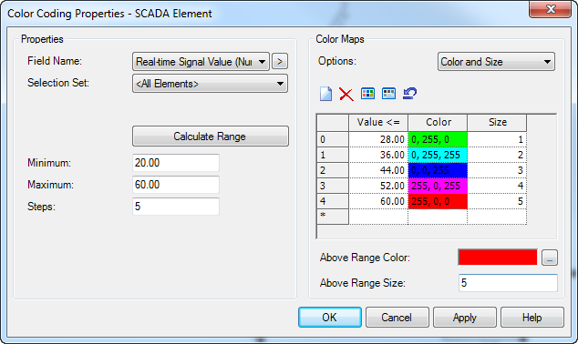

SCADA Element Color-Coding
SCADA Elements can be color-coded based on its value just like other modeling elements. From View > Element Symbology window, right click on SCADA Element > New > Color-Coding and then populate the window as necessary.
SCADA Element Annotating / Labeling
Similar to other modeling elements, SCADA Elements can also be annotated, that means the SCADA data value can be viewed in the drawing very easily. From View > Element Symbology window, right click on SCADA Element > New > Annotation . In the Annotation window, populate the necessary field and then click Apply and OK.

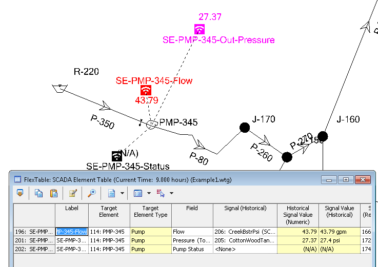

SCADA Element Flex Table
In this FlexTable, all the SCADA Signals that are mapped in the drawing are visible. This FlexTable shares all the features that other FlexTables offers. FlexTable can be view from View > FlexTables, then double-click on SCADA Element Table. The same table can also be viewed from Report > Element Tables > SCADA Element.

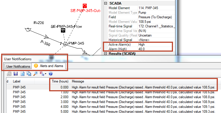

Alarms
Alarms are tied only to SCADA Elements, however Alerts are tied to all elements. There are four types of Alarms that SCADA Element can raise,
• High  Only one value can be provided. When the corresponding modeling element's value is higher than the given value, this alarm is triggered.
• Low  Only one value can be provided. When the corresponding modeling element's value is lower than the given value, this alarm is triggered.
• Low, High   Two values can be provided.
• Low-Low, Low, High, High-High  Four values can be provided
All the Alarms are listed in the Alerts and Alarms tab of the User Notifications window which can be obtained from Analysis > User Notifications
