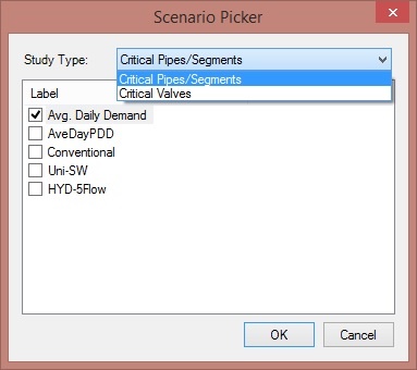

Starting with WaterGEMS CONNECT Edition Update 2, when you create a new Criticality Study, you will be able to choose between Critical Pipes/Segments and Critical Valves. Critical Valves enables you to determine which valves are most critical in water delivery - those that would result in the largest demand shortfall if they failed and could not be operated. See more: Critical Valves Analysis
Earlier versions will only have the ability to run an analysis based on critical pipes/segments.

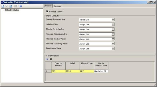

Next, click the Options tab. In this section, you will identify how the segments in the analysis will be defined.
The recommended procedure is to place isolation valves on the pipe elements. If you don't have sufficient data on the location of isolating valves, each pipe element can be isolated. In this case, each distribution segment consists of a single pipe, not including the nodes at each end. You can set this up by way of the "Consider Valves?" option at the top of the page. By default, this item is checked. When it is checked, the segments are defined by the valves. If it is unchecked, the pipes are isolated individually.
When the "Consider Valves?" option is selected, the default status of the valves is available. By default, these will be set to "Always Use." If you have some valve types that you don't want used in the criticality analysis, change this field to "Do Not Use." Note: if you don't have a given valve type in the model, you can leave this with the default setting.
There is a valve override section at the bottom of the page. This item is used in cases where an individual valve will not be considered in the analysis, such as if the valve is broken open. Once the options are set as needed, click the New icon in the upper left and choose the scenario you will be using in the analysis. Once this is done, you will have to select the segmentation scope of the analysis. You can either choose a subset of the model or the entire network. With Subset is selected, you can select the subset by clicking the ellipsis button. If you choose Entire Network, all elements in the model will be used.

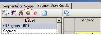

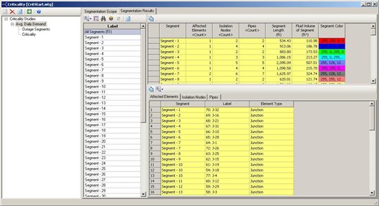

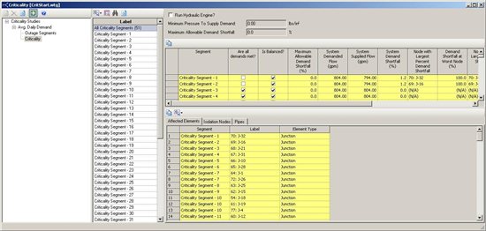

Next, click the green Compute icon. You may be prompted about update valve placement data. Typically, you will click Yes for this (see more about it here). The criticality analysis will then run. The results will be available in the Segmentation Results tab.
In the middle pane will be a list of all of the segments. In the right pane, you will see the distribution of segments and their properties, such as the number of pipes in a segment and the number of affected nodes. The displayed results are governed by the highlight segment in the middle pane.
Note: this is true of viewing results for the Outage Segments and Criticality sections below as well.
You can view the segments graphically by clicking the Highlight Segments icon at the top of the middle pane.
If you minimize Criticality manger, you can then view the segments on the model itself.

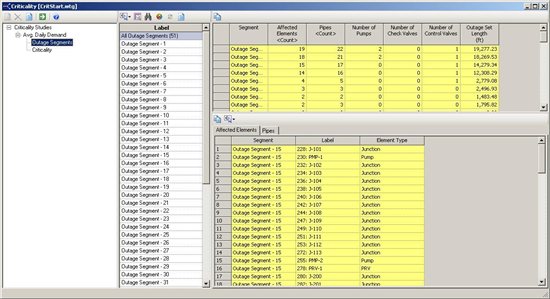

Once the segmentation is completed, you then do an outage analysis. This allows you to determine which segments are affected when a certain valve is closed. To do this, highlight "Outage Segment" in the left pane and select the green Compute icon.
The results from this section will show you how an outage affects a model, including the number of affected elements (see below for what "affected" means). You can also view these outage segments graphically in the model. Highlight one of the outage segments in the middle pane and select the Highlight Segment icon. When you minimize the window, the outage segment chosen will be highlighted.
If you have customer meters in the model, any customer meter connected to a pipe or node in the outage segment will be included. However, if the customer meter is attached to one of the closed pipes (i.e., one of the pipes in the segmentation), it will not be included in the outage segment.

The final step is to see how the outages affect the demand. This is the most important function of the criticality analysis. It will determine if the system can supply the needed demand if a section is closed, and if it cannot, how much demand shortfall there is as a result of the closure.
Highlight "Criticality" in the left pane. At the top of the right pane is an item called "Run Hydraulic Engine?" If this is unchecked, the model will check the connectivity of the model when certain segments are closed. If you select the green Compute icon, you will be able sort the results to see which outage segments will cause the largest disruption by looking at the "System Demand Shortfall" column.
If you place a check in the "Run Hydraulic Engine?" icon, the program will hydraulically compute the model as well. If the demands are not met in that segment, the check box in the column "Are all demands met?" will not be checked.

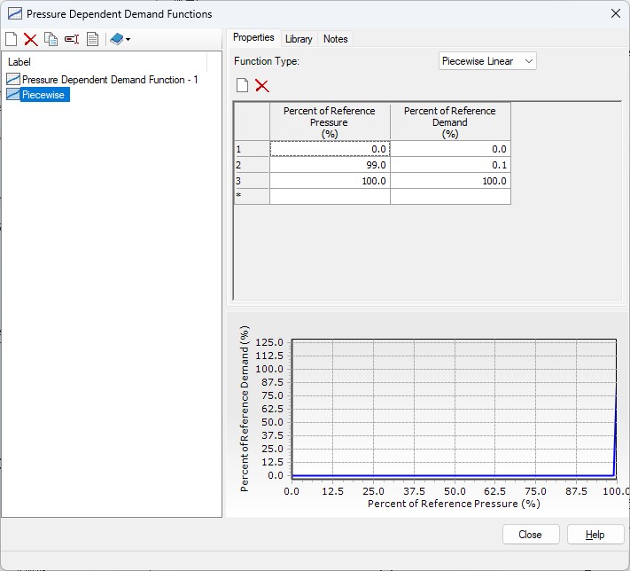

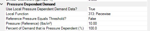

Is it possible to have a count of demand nodes that fall below a pressure threshold that is specified per demand node?
To set up a per-node threshold pressure that is different than the global "Minimum Pressure to Supply Demand" in the Criticality dialog, you can use local Pressure Dependent Demands. To use a similar approach to the "Minimum Pressure to Supply Demand" option used for scenarios not configured with pressure dependent demands, you can set up a Piecewise PDD function something like this:
You can then specify whatever threshold pressure you want on each demand node. Open the junction properties and set Use Local Pressure Dependent Demand Data to True, the set the Local Function to the Piecewise PDD function you created.
The PDD calculation option will need to be applied as well.

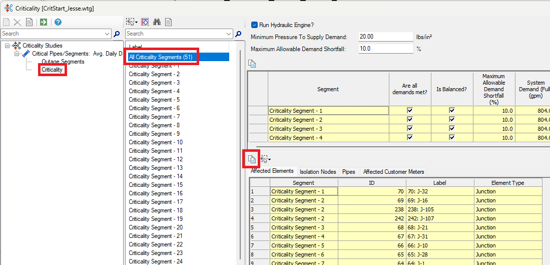

How can the criticality segment name be shown as an attribute of the elements?
If you would like to see the criticality segment name as an attribute of each element (for example to color code on or include in flextables or an exported Shapefile), consider the following steps and post as an Idea for a built-in option in a future version:
  1. Compute Criticality and click on "All Criticality Segments"
  2. Click the copy button above the table on the right side, in the "Affected elements" tab:
  3. Paste the data into a spreadsheet using Excel for example, then save it.
  4. Create a User Data Extension (UDX) to store the segment name. Use the Share option to copy it for both junctions, pipes and isolation valves if you need to retain the segment name for all three element types.
  5. Use ModelBuilder to create a connection to the Excel spreadsheet, using the element ID or label as the Key field in the Field Mapping step, Junction as the table type and map the Segment column of the spreadsheet to the UDX field you created in step 4.
  6. Sync in (import) the data to populate the segment name
  7. Repeat these steps for the isolation valves, Pipes and/or customer meters, creating separate UDX fields for those element types and exporting from the respective tab in the bottom-right side of Criticality.
